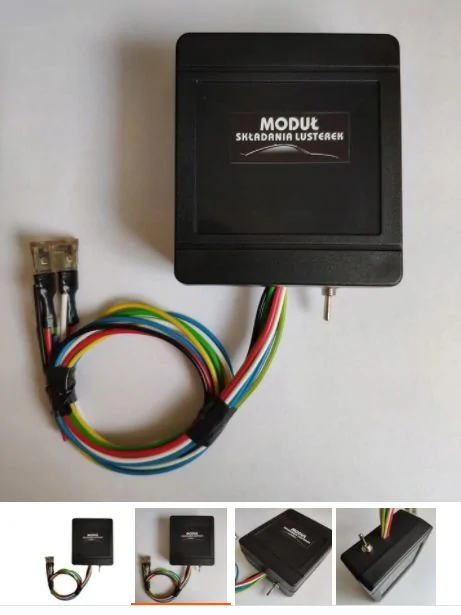

Yes, the mirrors (EU, 9 pin) are electrically foldable. I'm still in the process of connecting, it's supposed to work with the original Mustang remote.
The installation will be completely from the factory installation folding relay ( as there is no installation, no folding button, no folding relay in my 2016 Base version)
I install such a mirror folding driver, bought at the Allegro auction.
That's why I need to find + 12V after ignition, I don't want to puncture the wires into the BCM to find the + 12V after ignition...

I have finished
assembly, everything works, including folding the mirrors from the original remote control.

I am still wondering whether to add an additional (or the original) manual folding button. Would that be a useful option, such a button?
Can you tell me the color of the power folding wire ?
