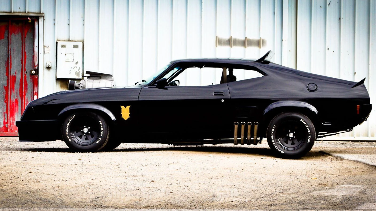

I like side exhausts and wondered the same thing. I would not have both side and axel back because of the added weight. For me it's one or the other.
offcamber
Mar 17, 2017
192
69
2018 Magnetic GT - Premium/PP
Or this......

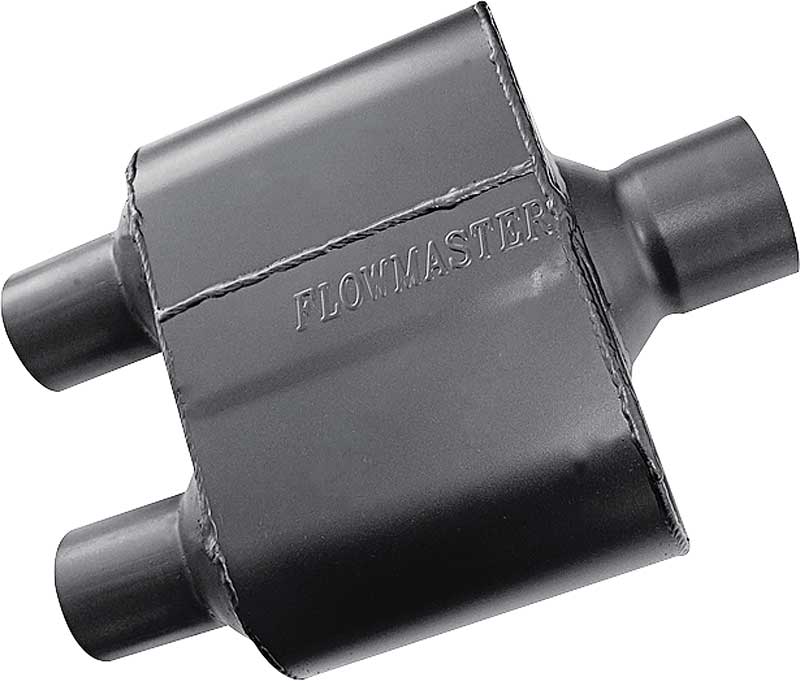

Low profile mufflers might fit on either side but you could go with one in place of the stock resonator and it just might work. One in and two out.
yomamma219
Feb 21, 2017
743
150
Raleigh, North Carolina
2016 Mustang EB Premium Pony Pack "4HORSEMEN"
This is exactly what I did with a MF 1in/2out,except ran it out the back, not side. The one thing to watch out for is that I would guess most 1in/2out aftermarket mufflers are going to be a not-insignificant amount larger than the factory resonator. This resulted in my muffler sitting below the exhaust tunnel as it doesn't fit in the space. I believe this has reduced my ground clearance in the center of my car. Not an issue so far as I am still on stock suspension but if you want to or have lowered your car this might not be an option.
