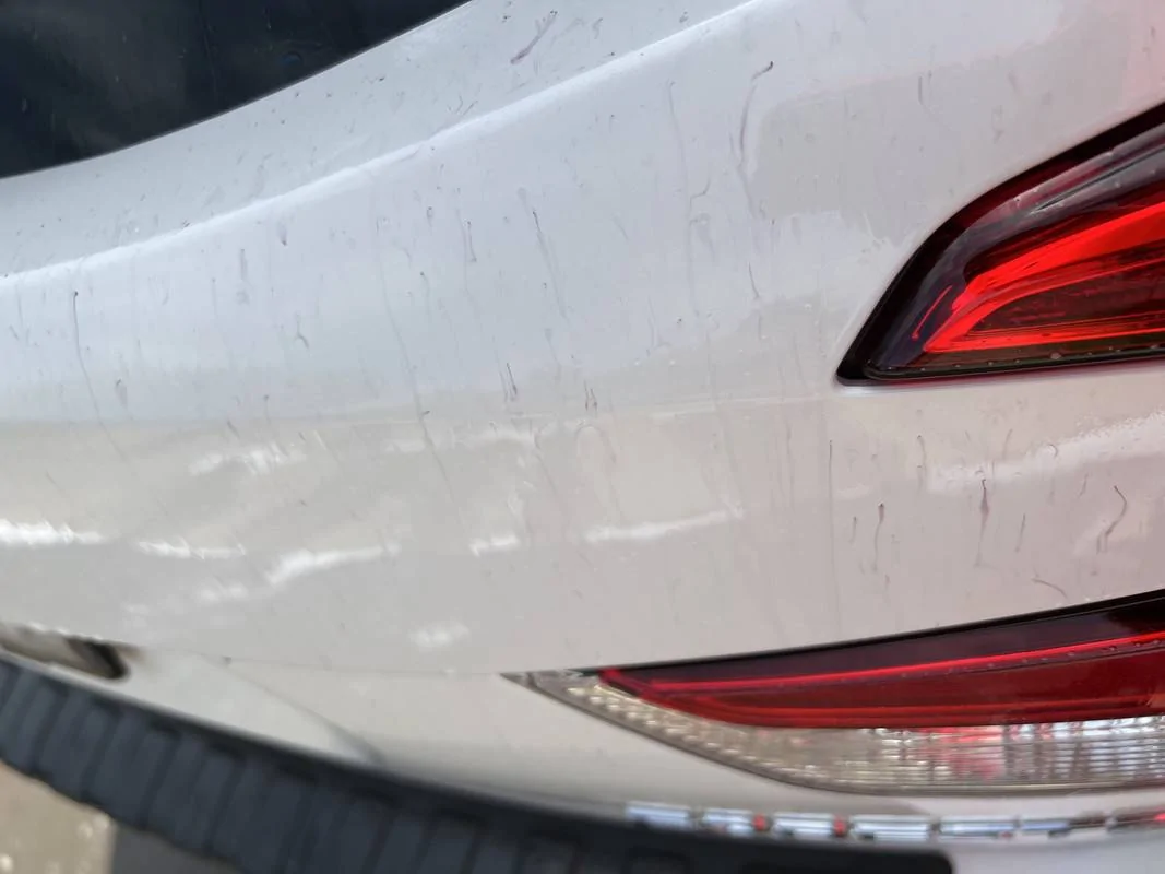

I have a magnetic metallic car that I’d like to do a thorough cleaning job on. The guy I bought the car from says he did a diy ceramic coat of some type, doesn’t remember the name. Paint is in good condition, but does have a few scuffs etc. Is there any does/don‘ts associated with doing a mild paint correction on a coated car? Not sure of the steps I should take, never had anything to do with anything ceramic coated in the past. Thanks.

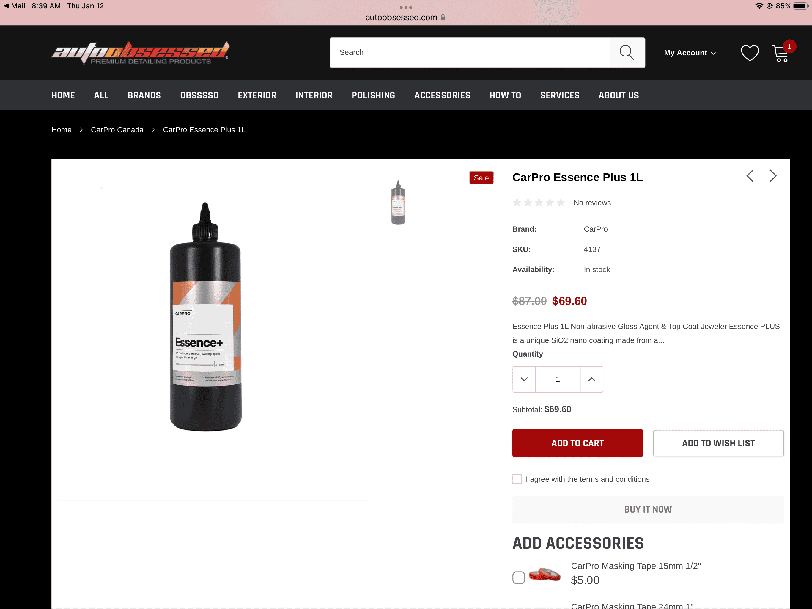

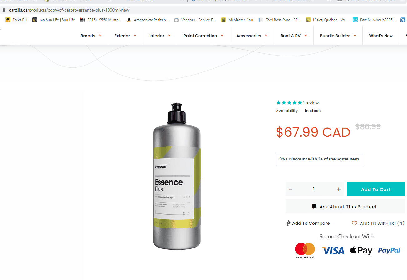

Thanks for the reply. I’m in Canada and there is a Carpro distributor here, but the label is different. Would this be the same product?

I’m guessing they had to relabel the product so it has both English and French on it.

Just be aware that there are two versions of Essence -
Essence is an all-in-one type of polish, containing abrasives and a Si02 sealant. This product can also be used as a primer polish for ceramic coatings.
Essence+ (Plus) is the non-abrasive version, working to fill and hide imperfections while also applying an extra layer of sealant to prolong the life of the coating.
