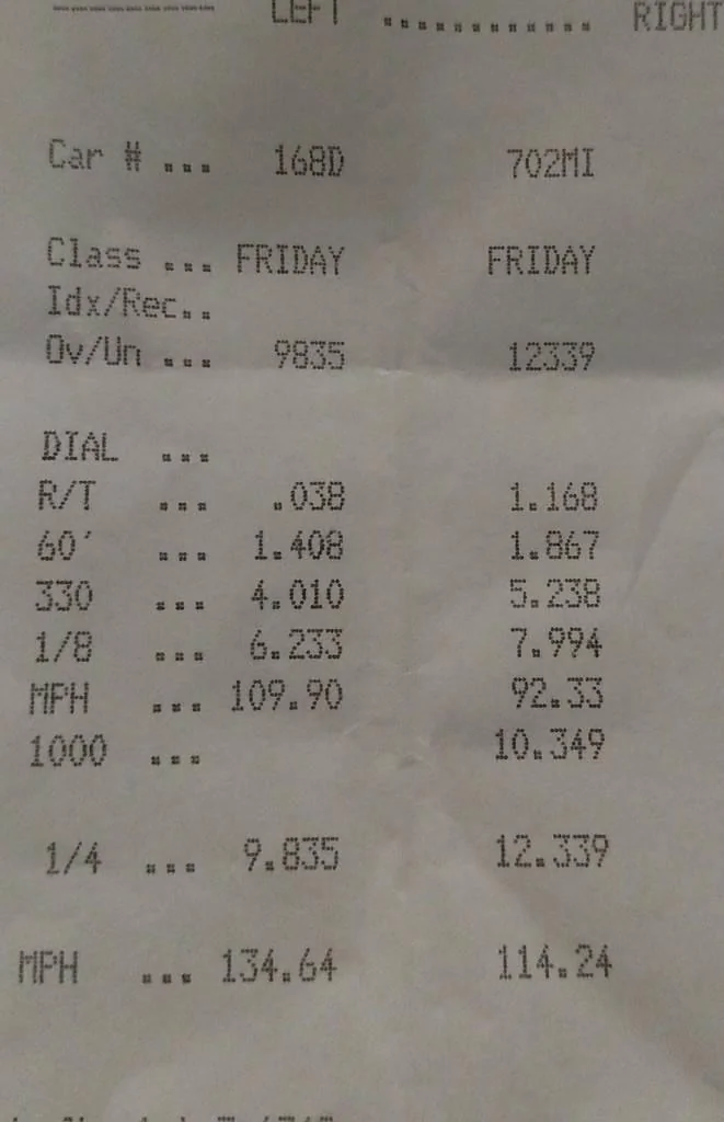

So I just got my car to the dragstrip for the first time after doing some bolt ons and getting it tuned and I'm kinda disappointed in the performance esp. the trap speed. My car is a 2017 gt pp with ARH full exhaust, gt350IM, pmas intake, lu47 injectors and a lund flex fuel tune.
The best I got was 12.33 at 114mph with 1.86 60ft. I know the e.t. could drop some with a better 60ft but I expected to trap faster than 114? Anybody have any input or advice?

Have an image of the slip to show?

Sorry for the huge pic lol couldn't figure out how to make it smaller. This was at beaver springs dragway in central PA. I know my reaction time was terrible I wasnt concerned about that I was focusing on learning to launch the car.
