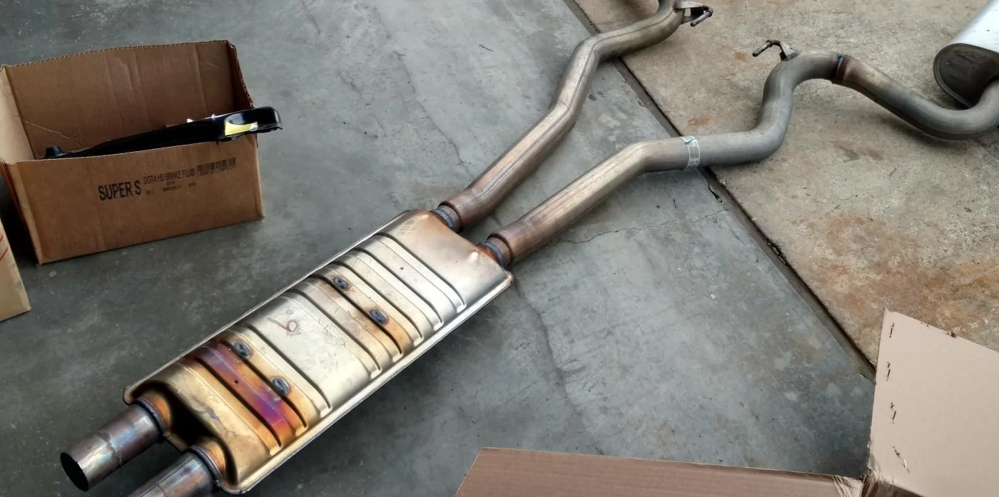

I had that same problem, once I got rid the stock exhaust with the resonator, was no longer warm. The resonator got so hot that parts of it changed color and it's made from stainless too

yup it was the stock exhaust replaced it with Corsa Sport exhaust no more red hot shifter and r model right about the resonator look at the pic
