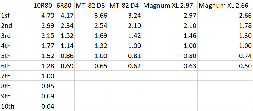

For the gear ratios, I used various sources and the ratios are below.
