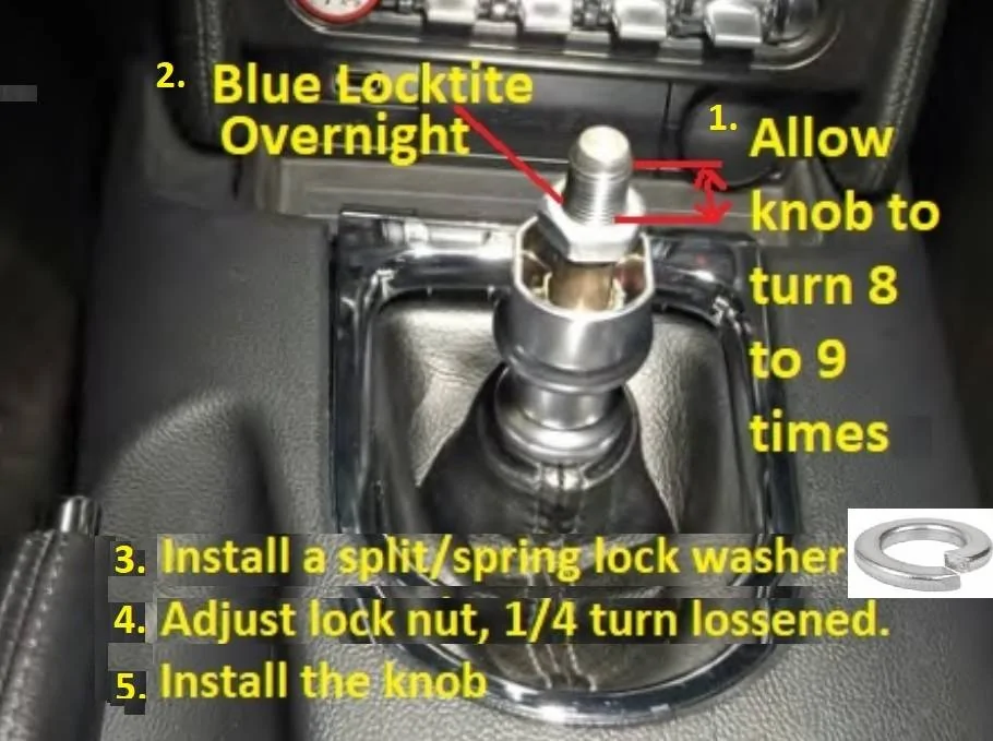

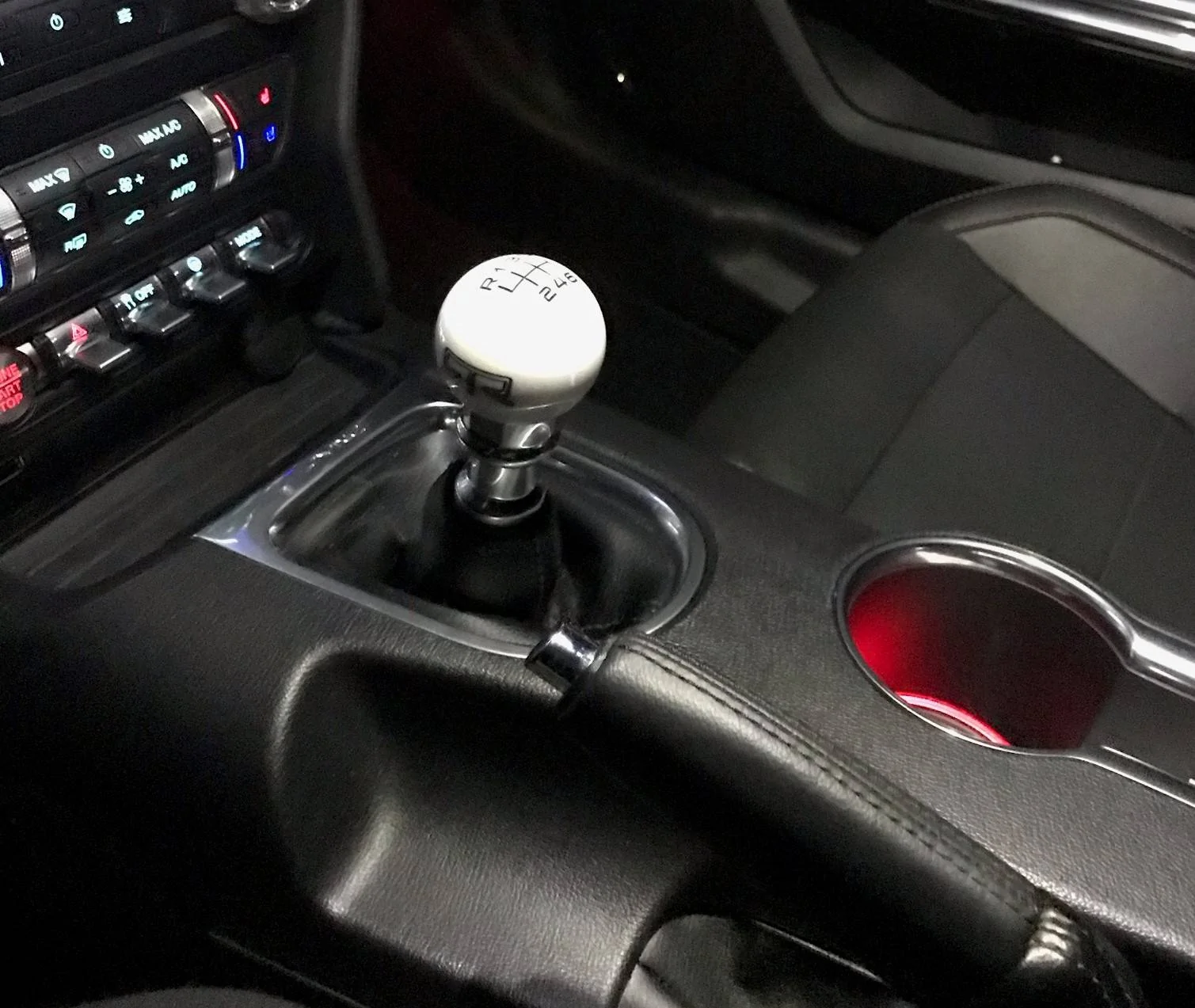

I had to re-accomplish shift knob install three times because lock nut came loose and started to rattle.
So, here is if you are going to install a White Shift Knob: View attachment 477231 View attachment 477232
