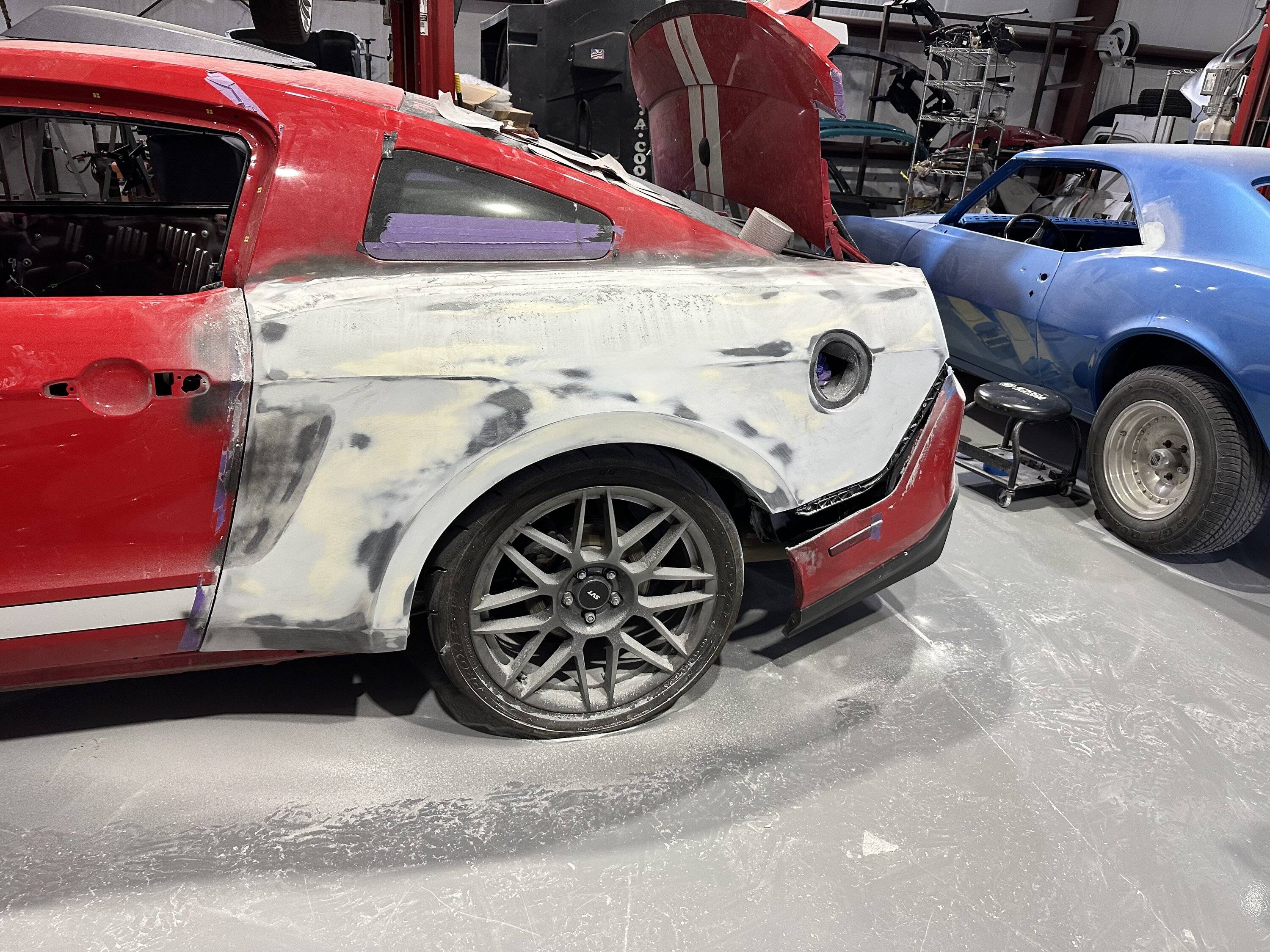

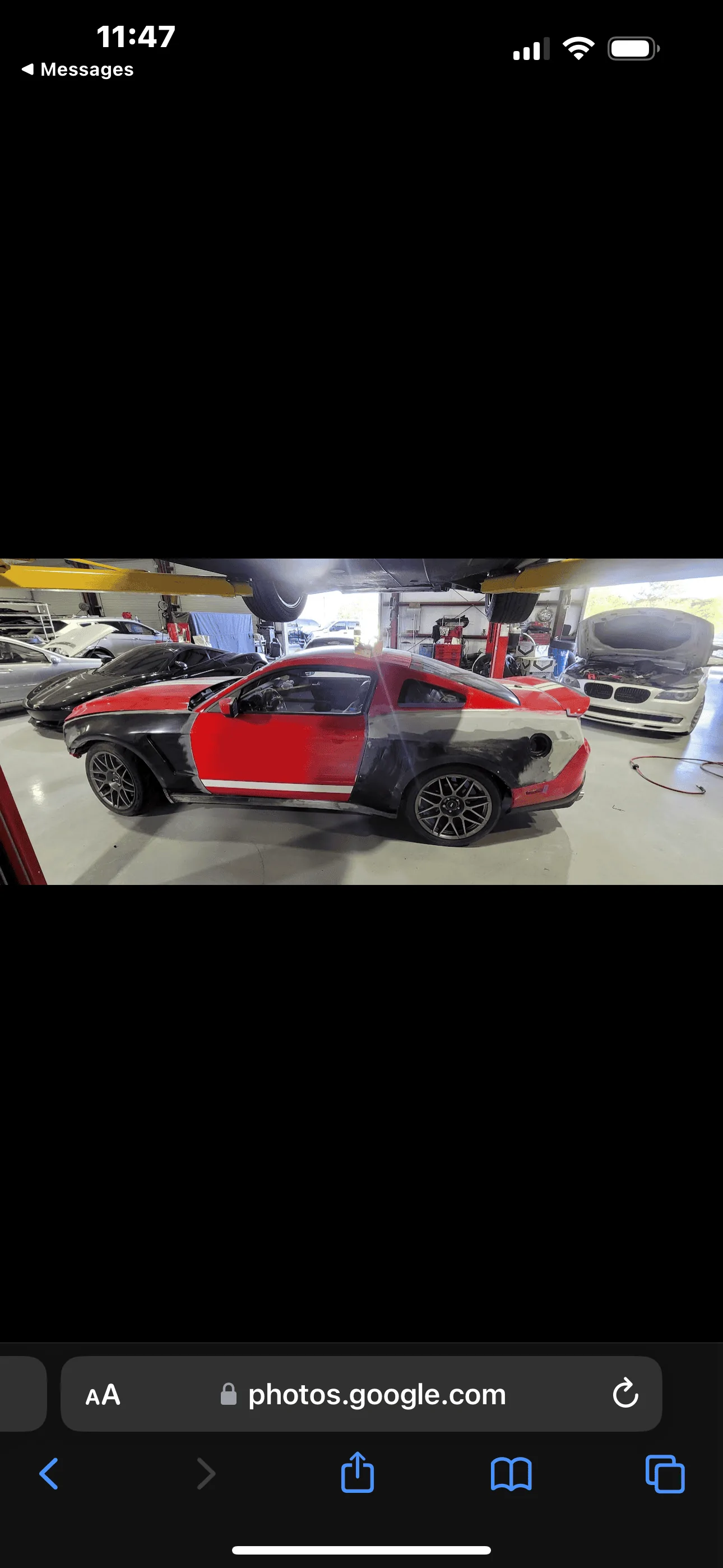

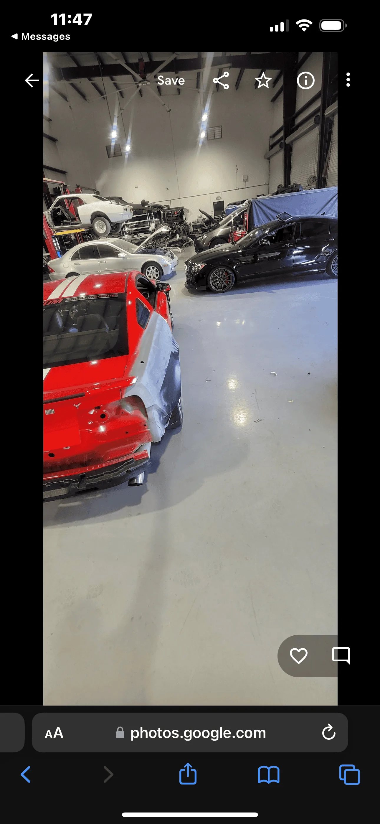

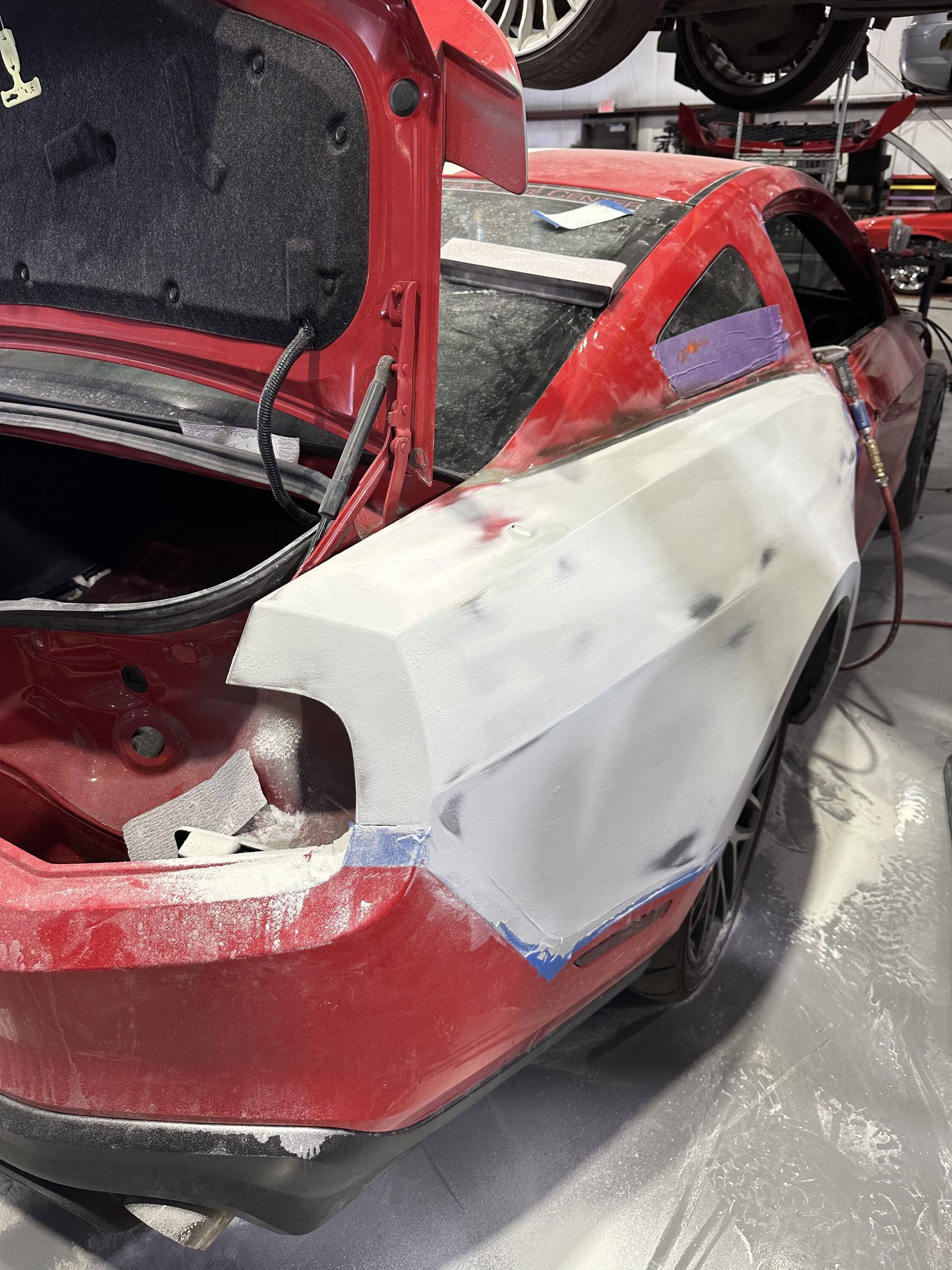

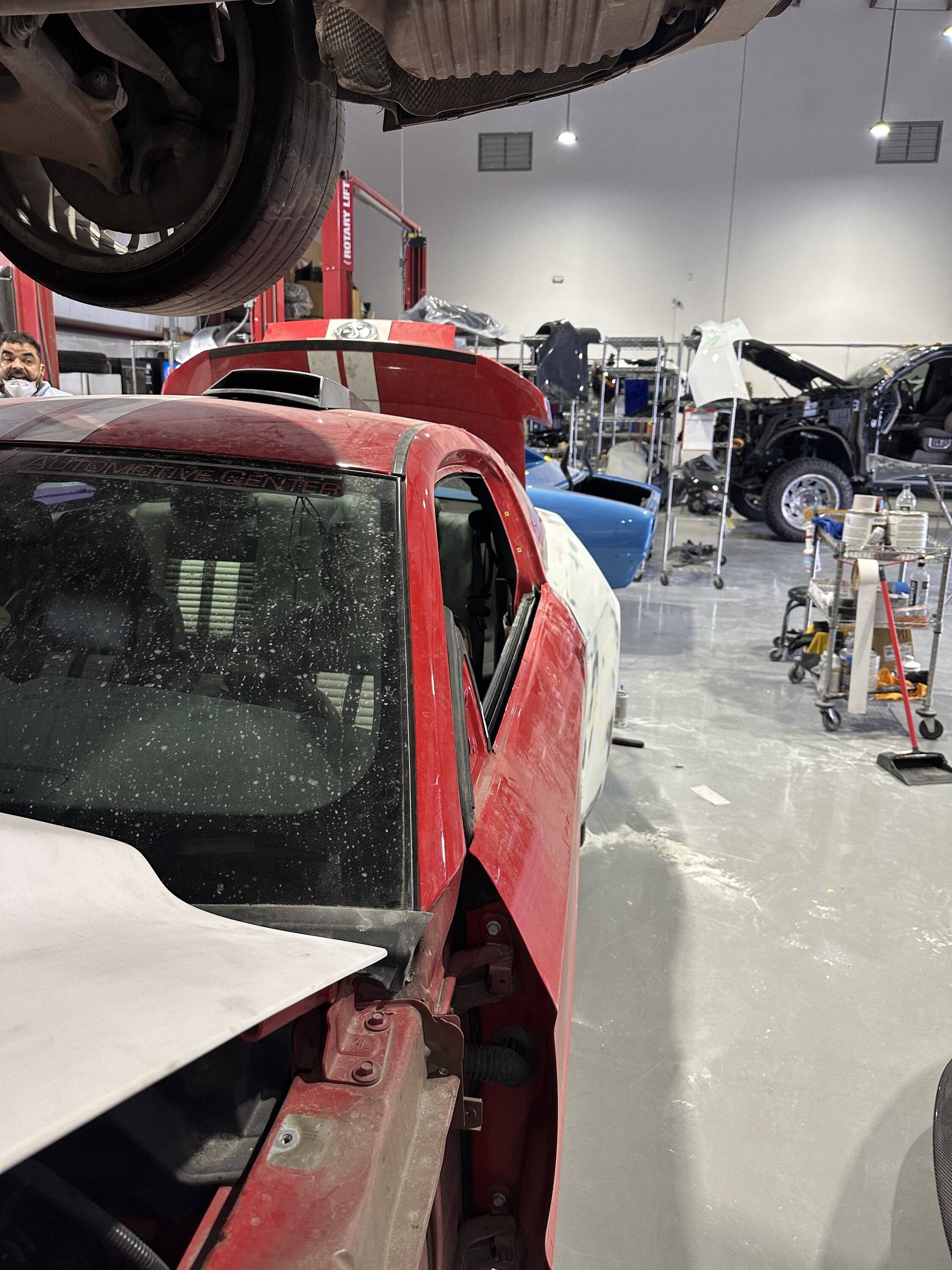

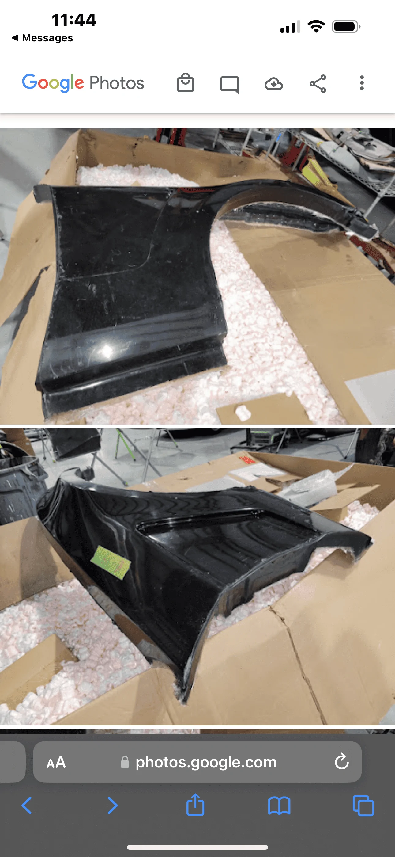

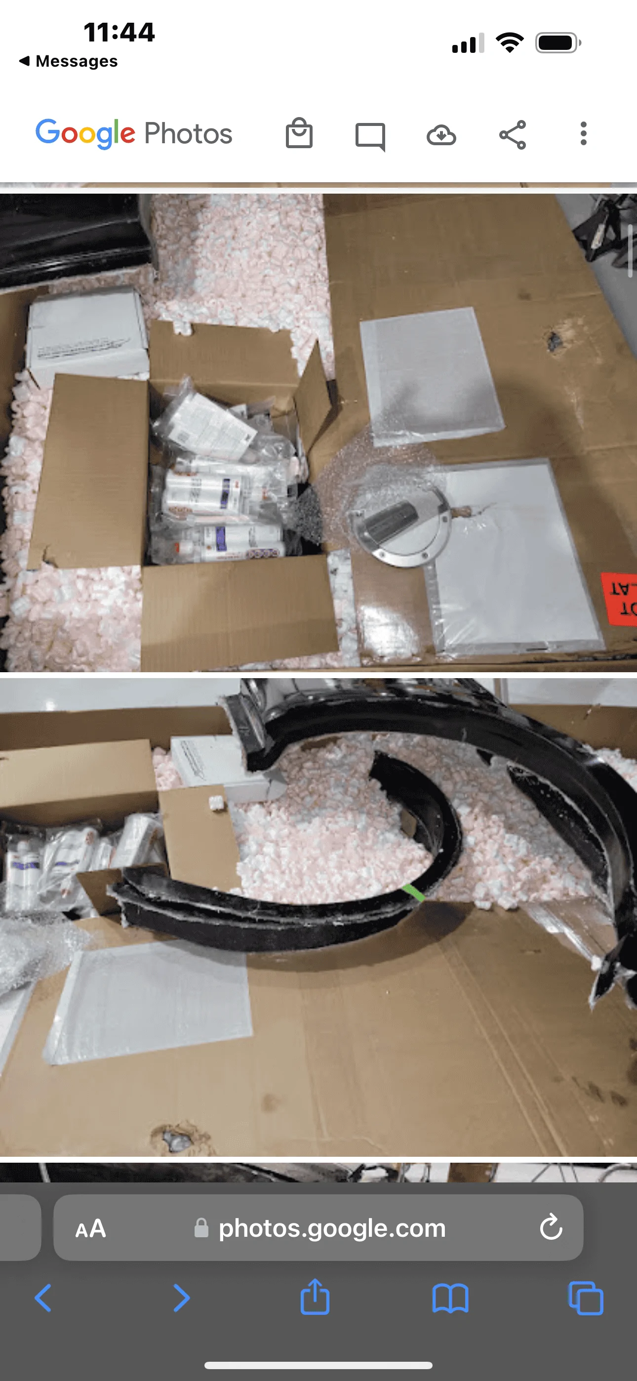

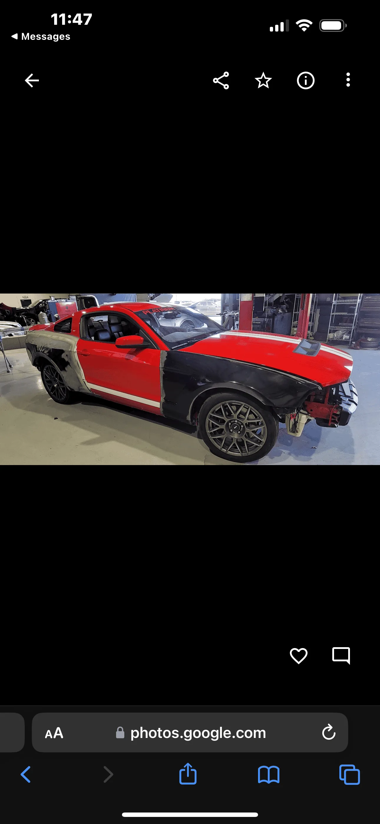

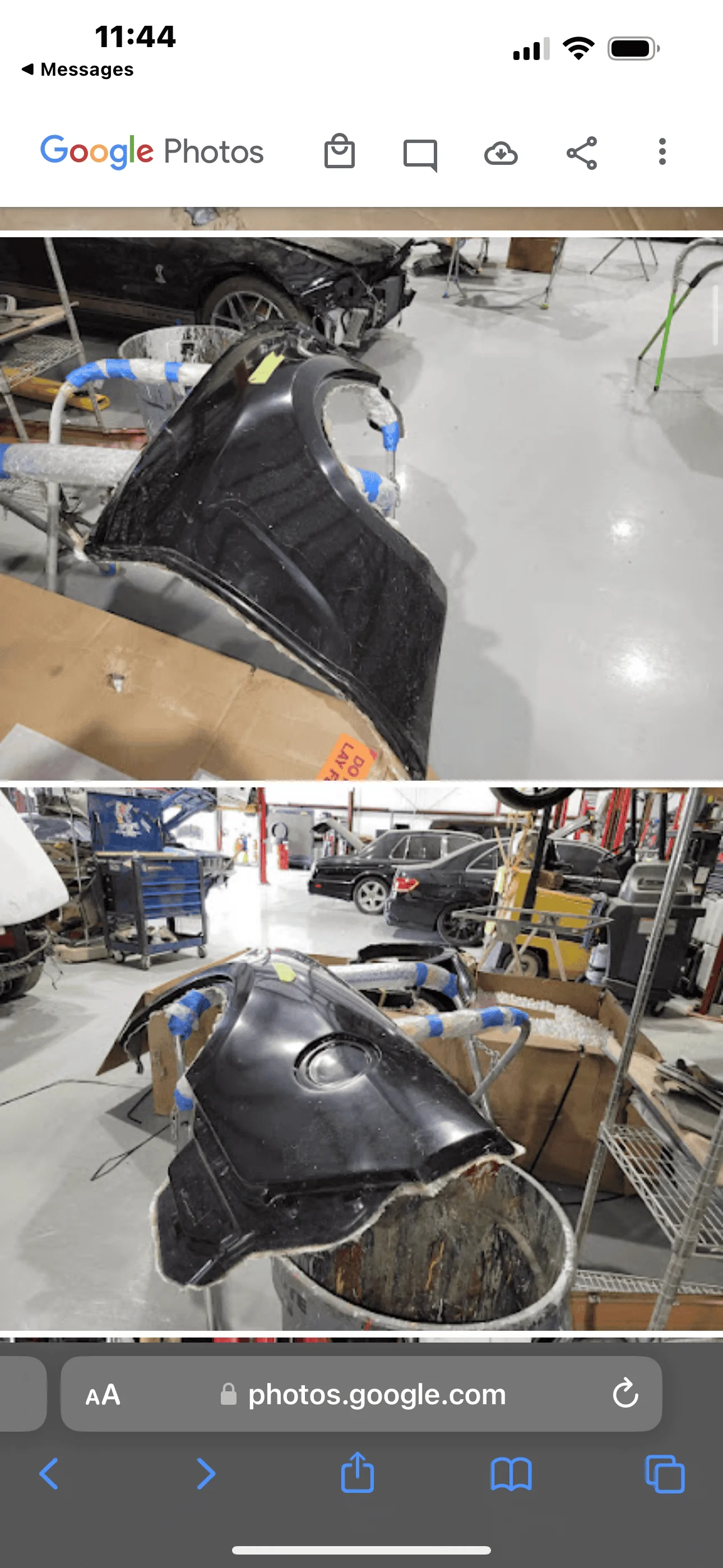

Hello ladies and gents, it is not 6G GT500 but figure some of you fans will enjoy this build in process. This is a friends/clients car, a little behind the scenes so that anyone interested can see what’s involved in a wide body kit.

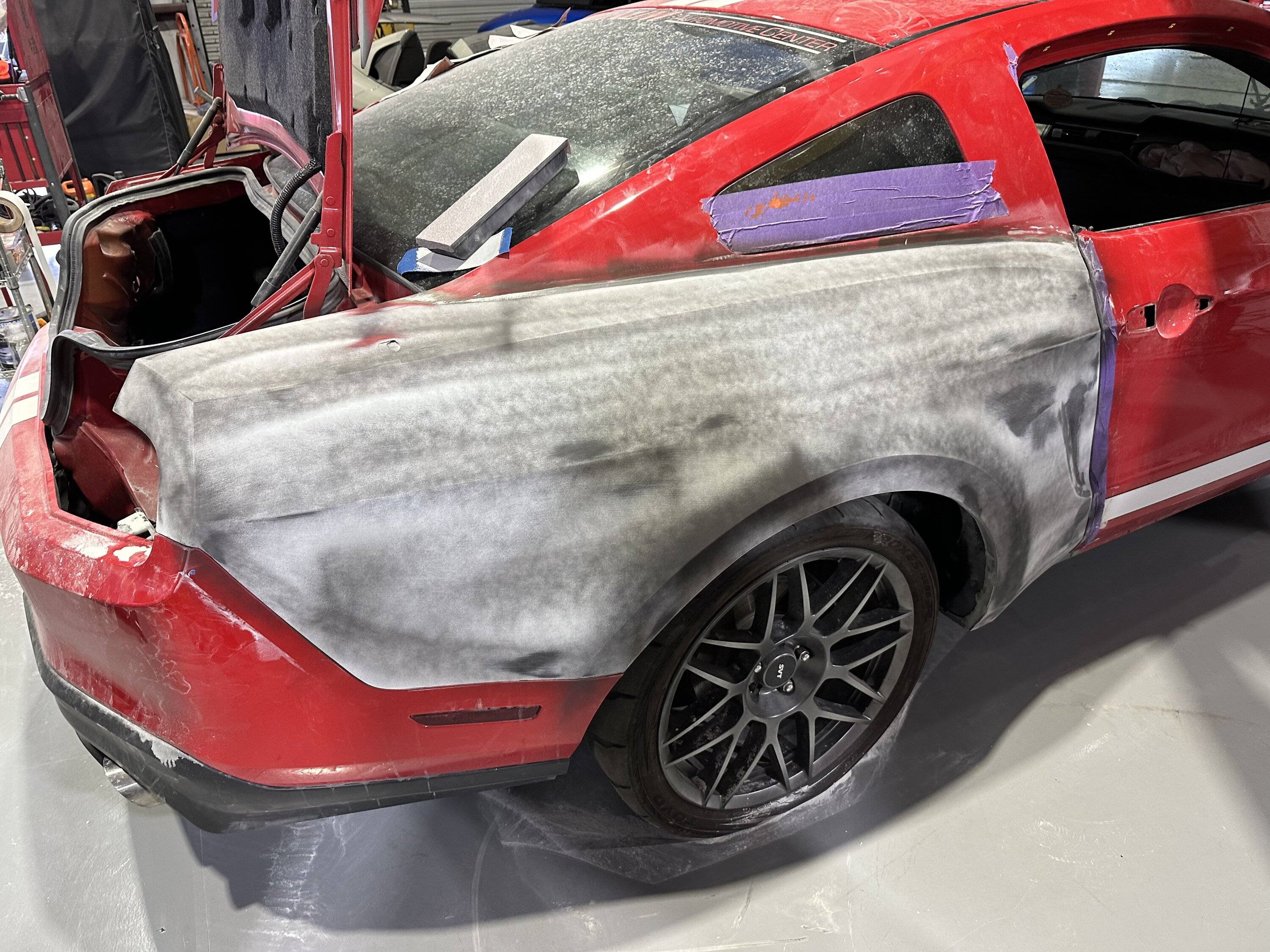

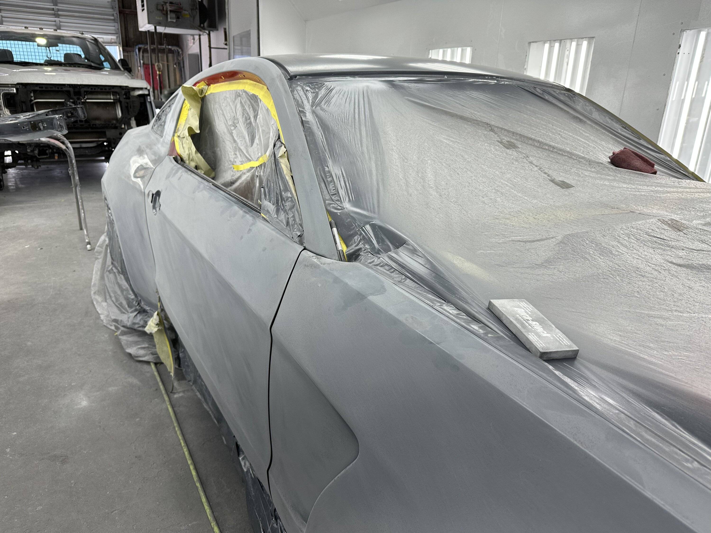

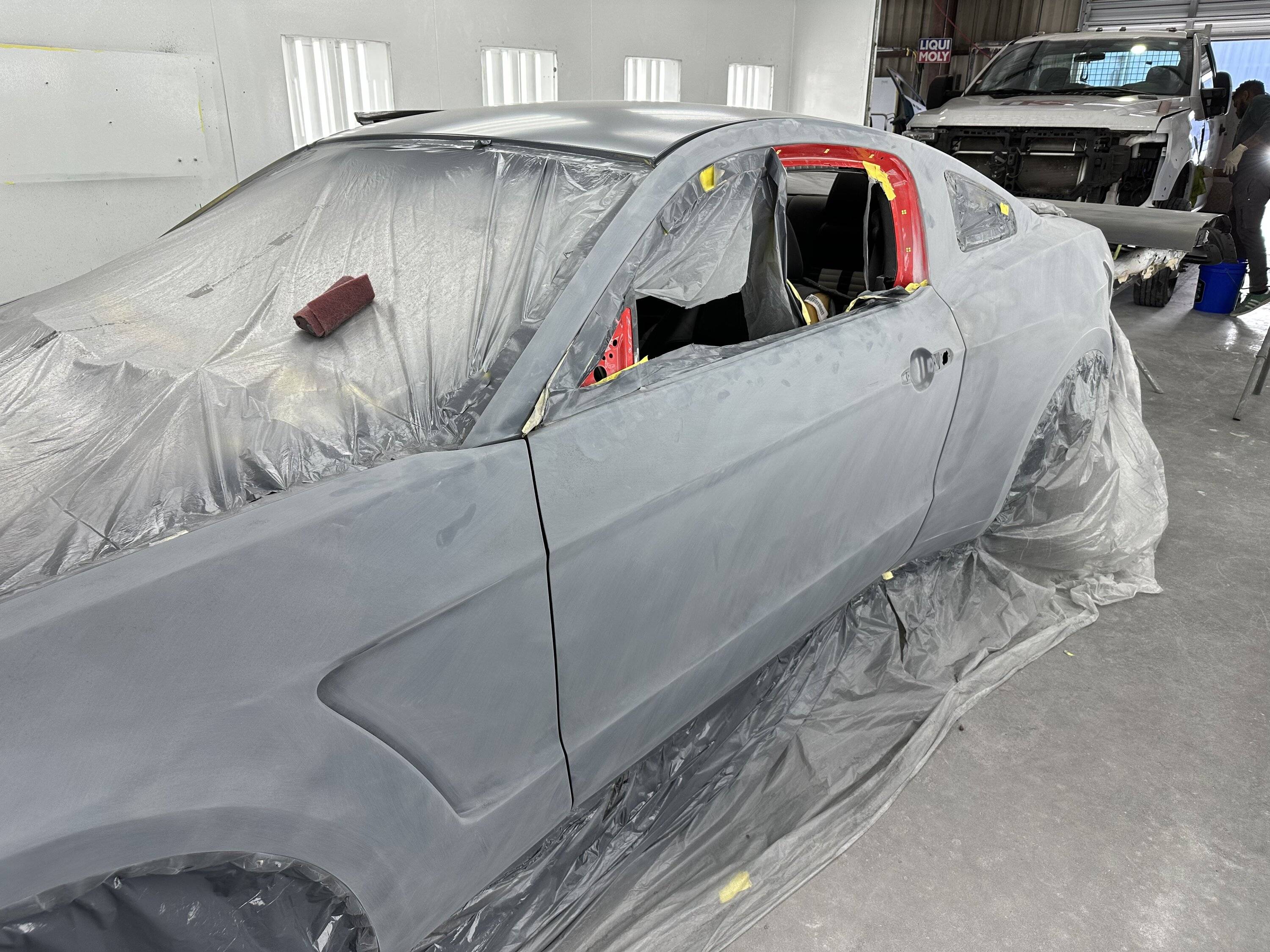

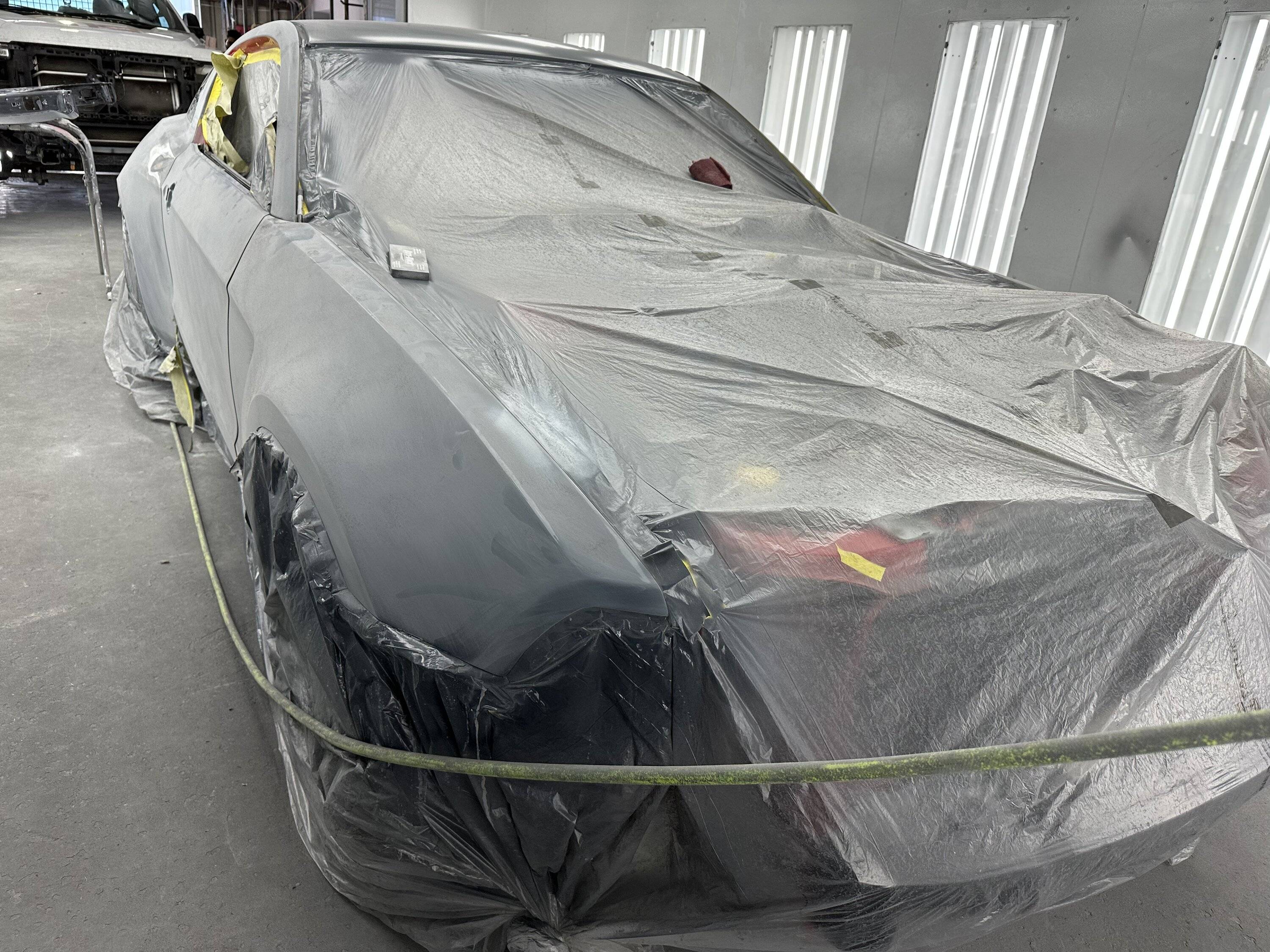

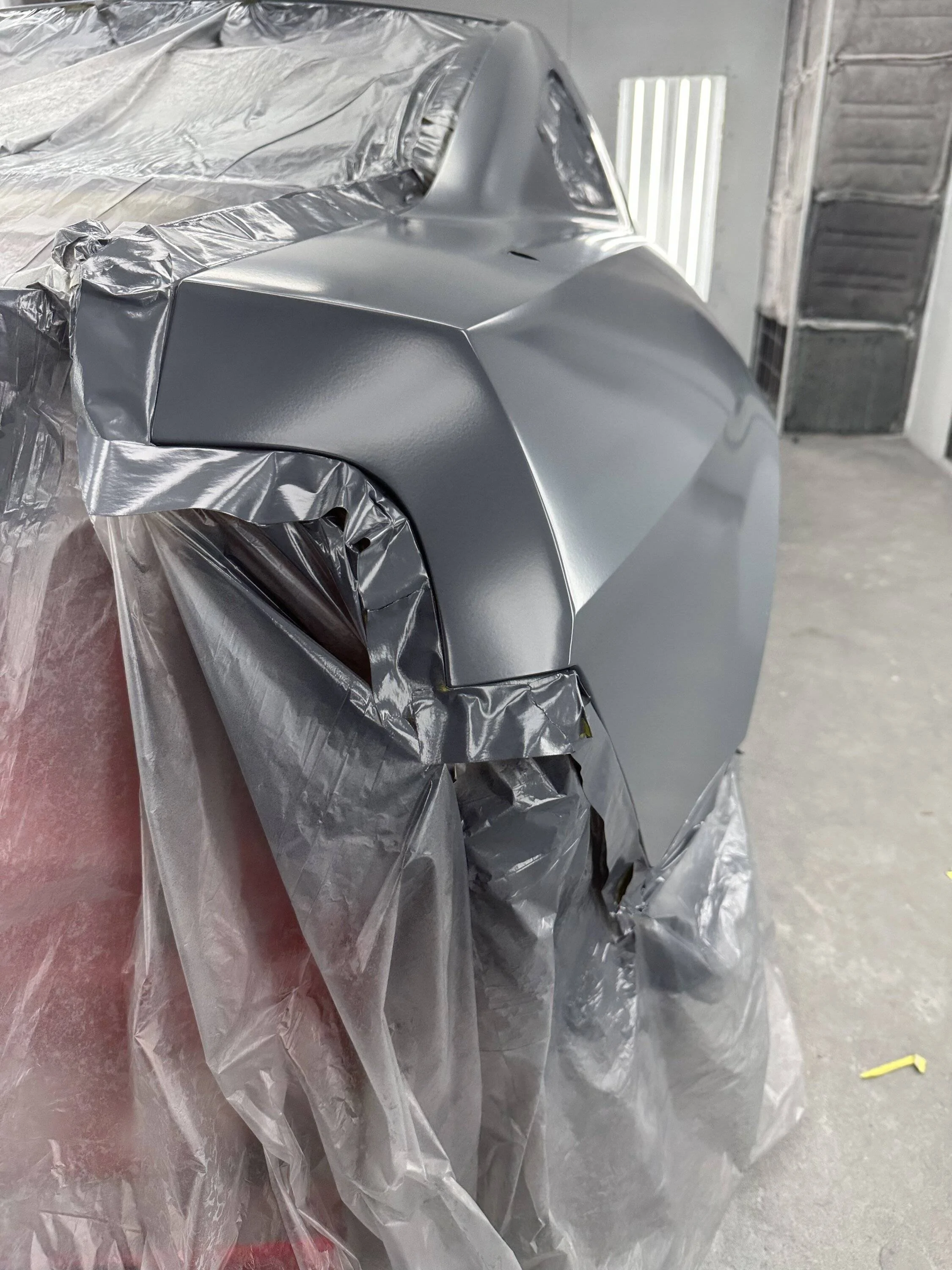

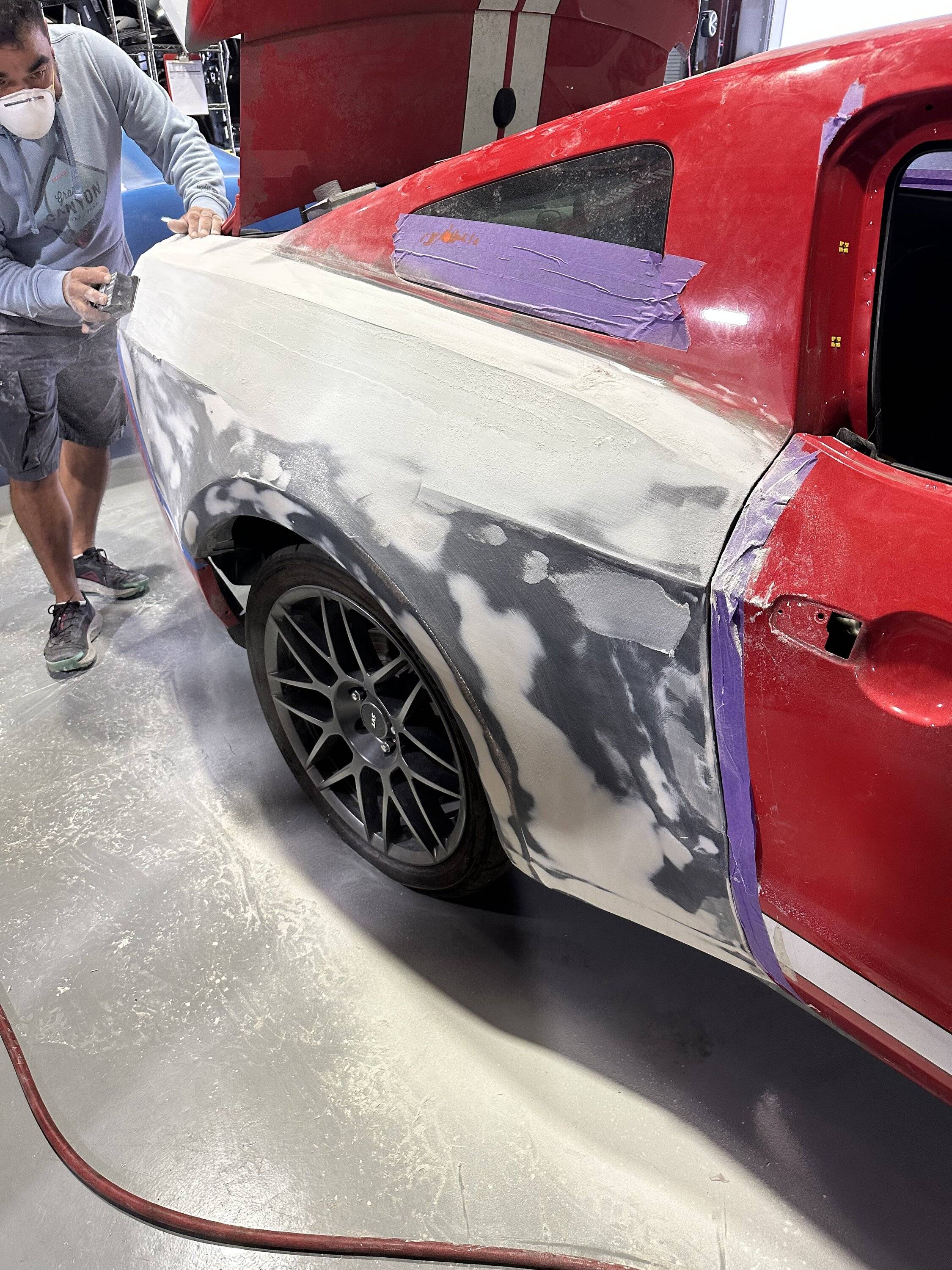

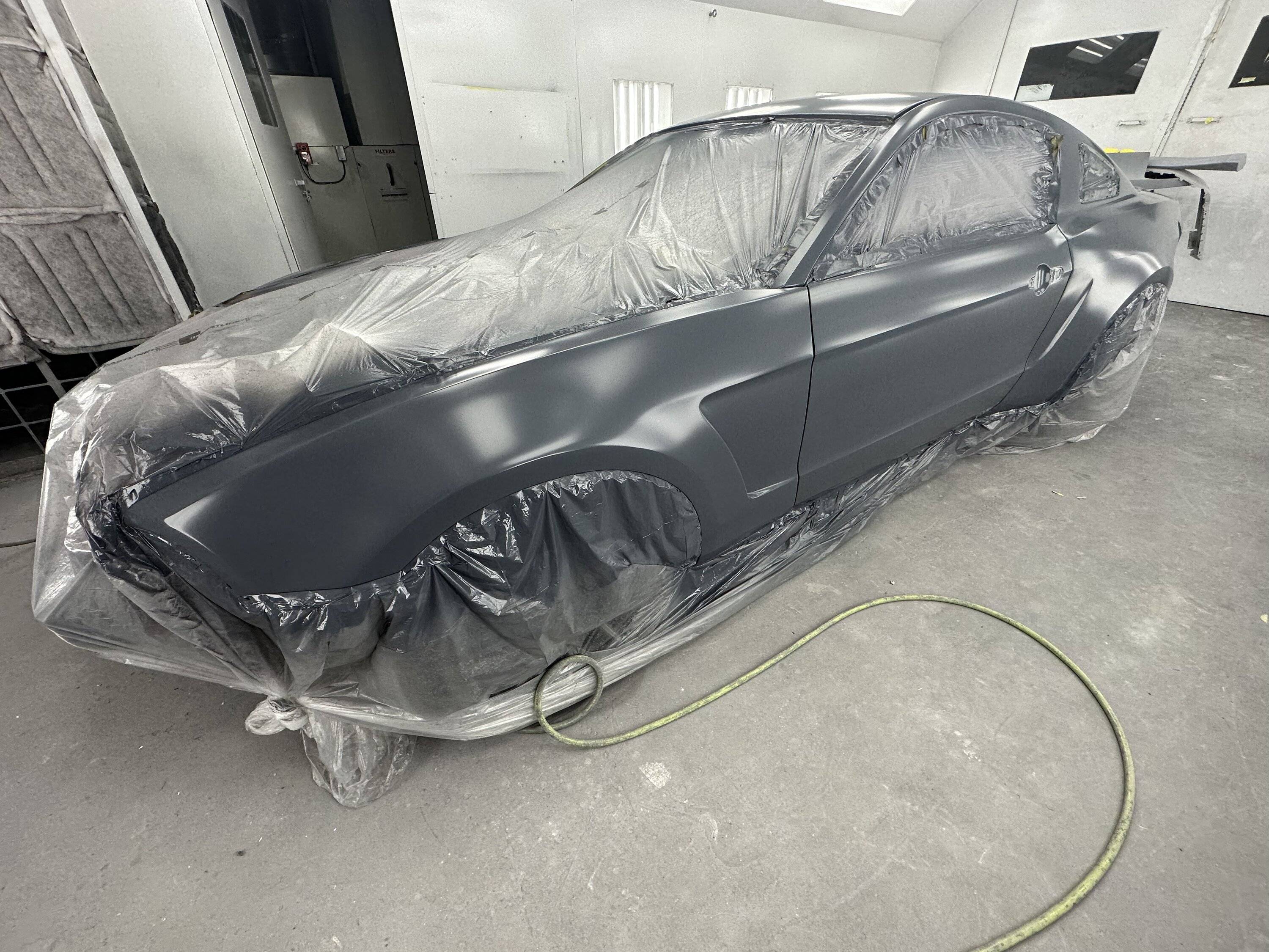

Those where some of the initials after the fiberglass work, then it got its first coat of epoxy high build primer and hours and hours of body work and line work to make everything match the gaps and door fender qtr lines

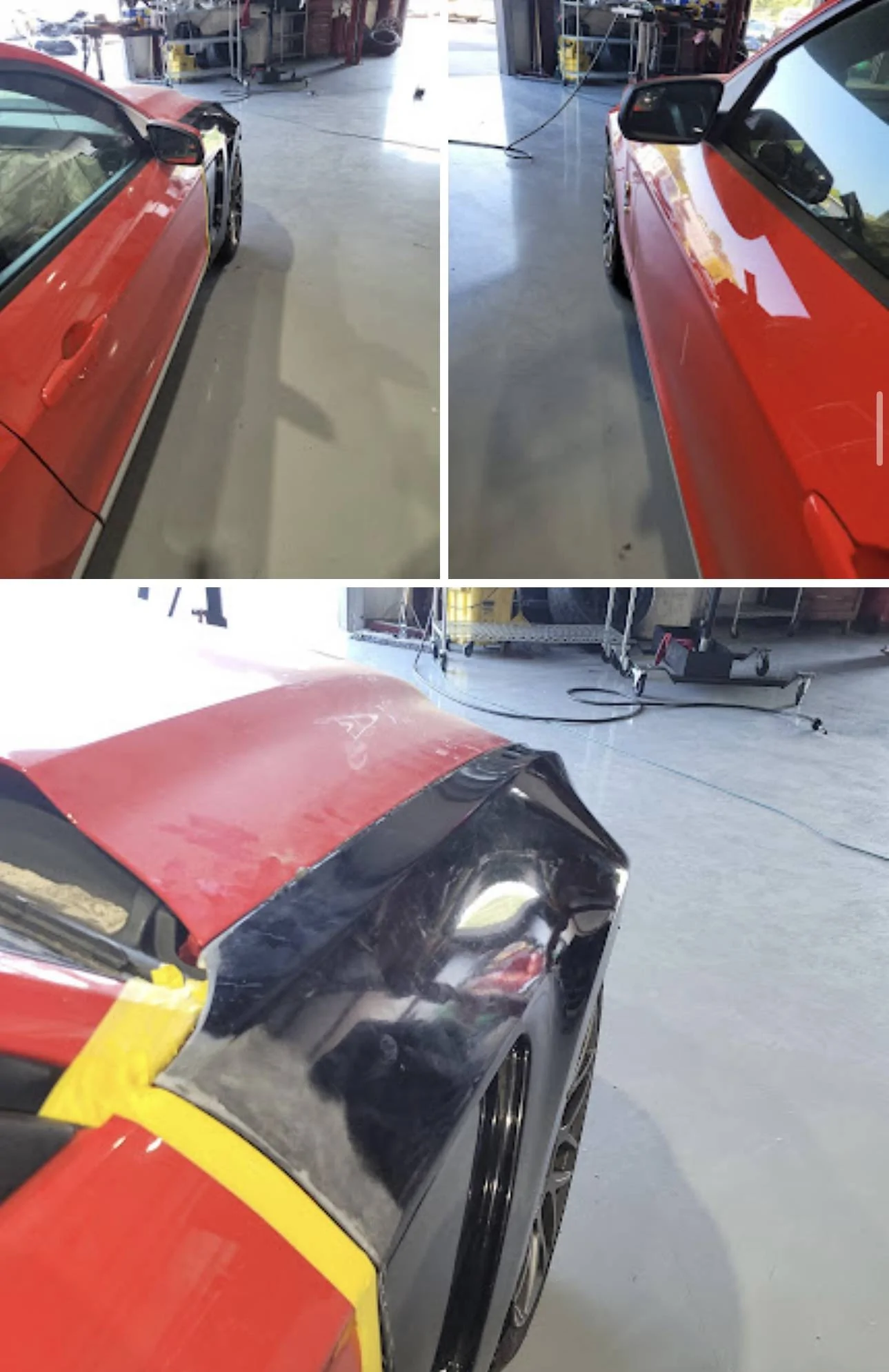

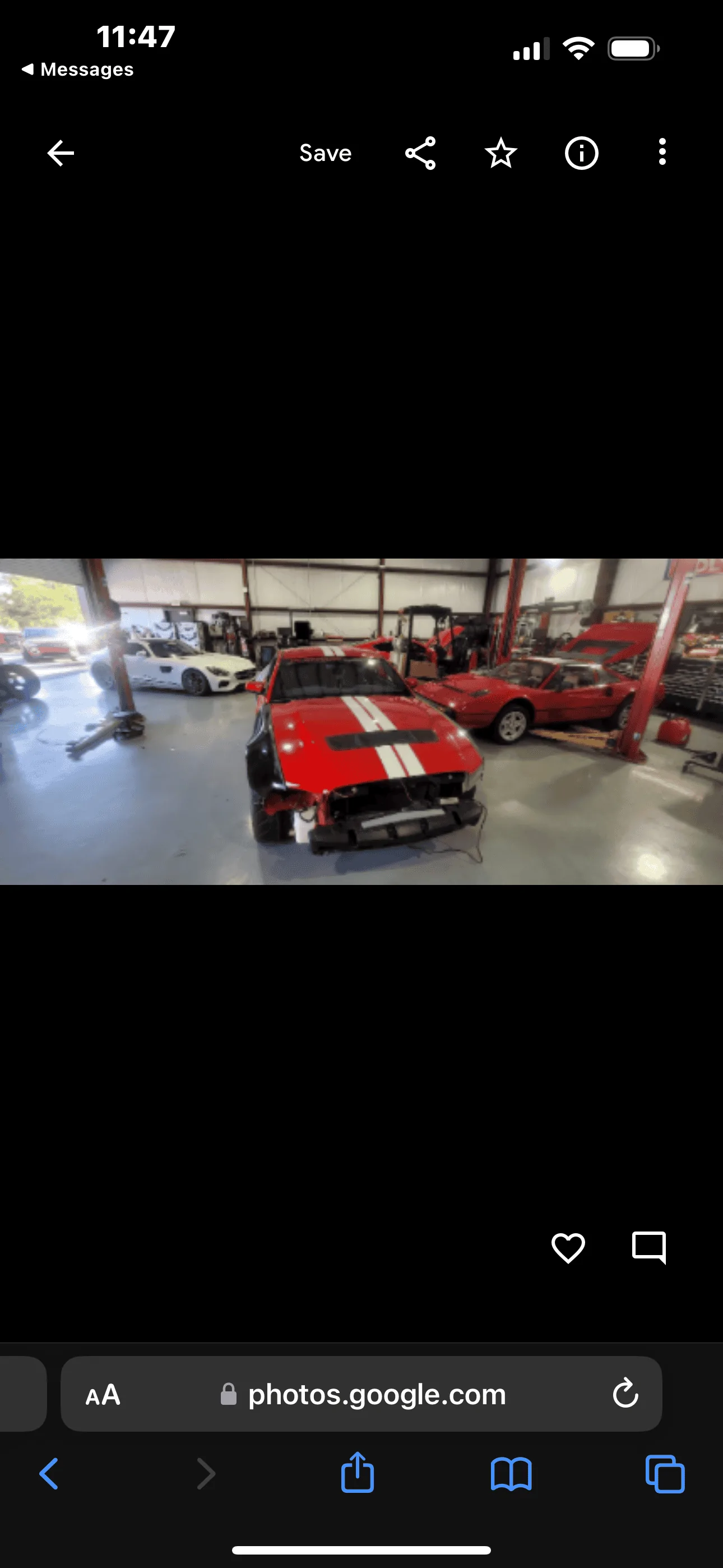

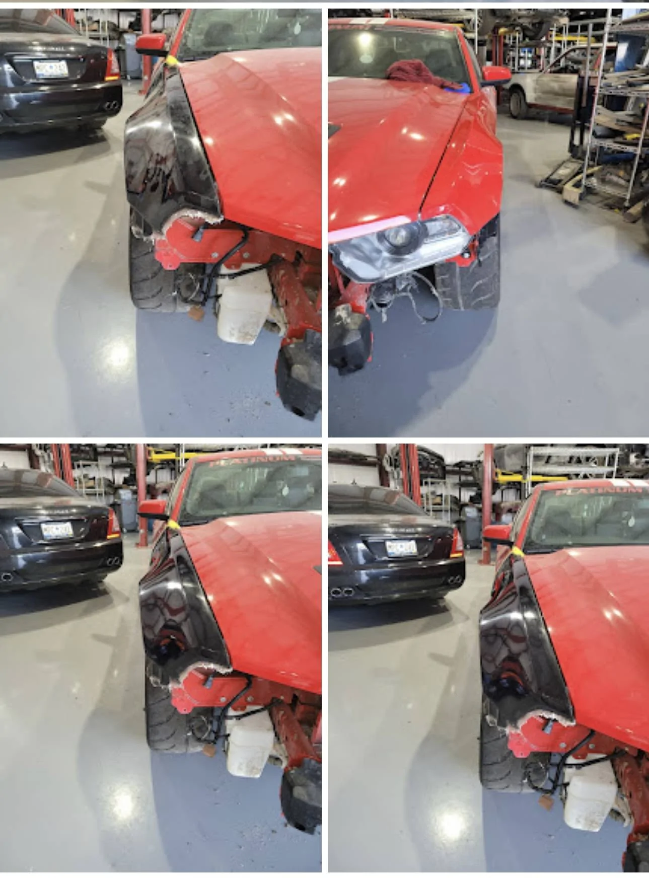

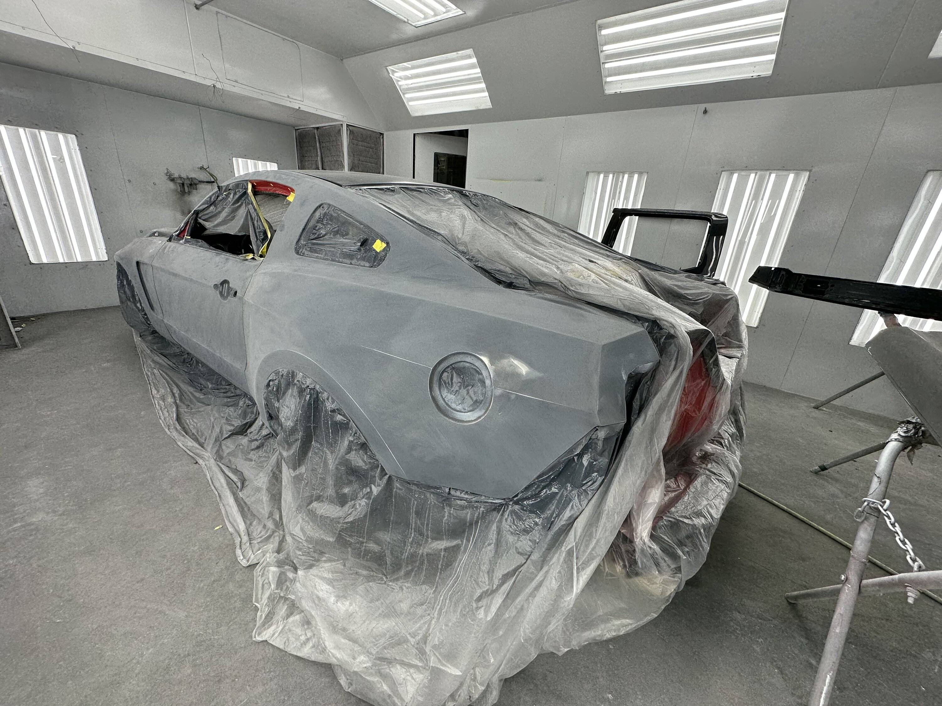

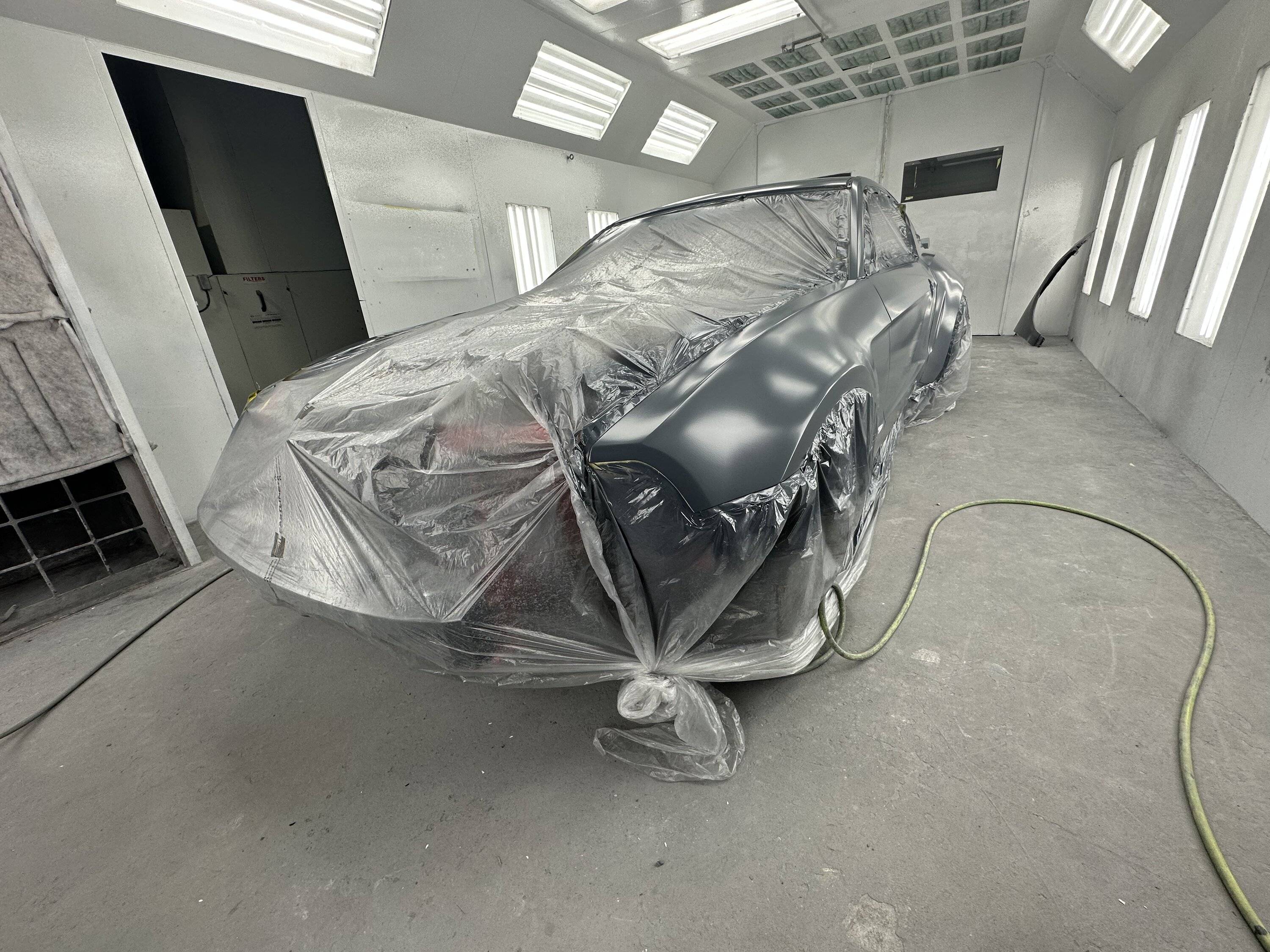

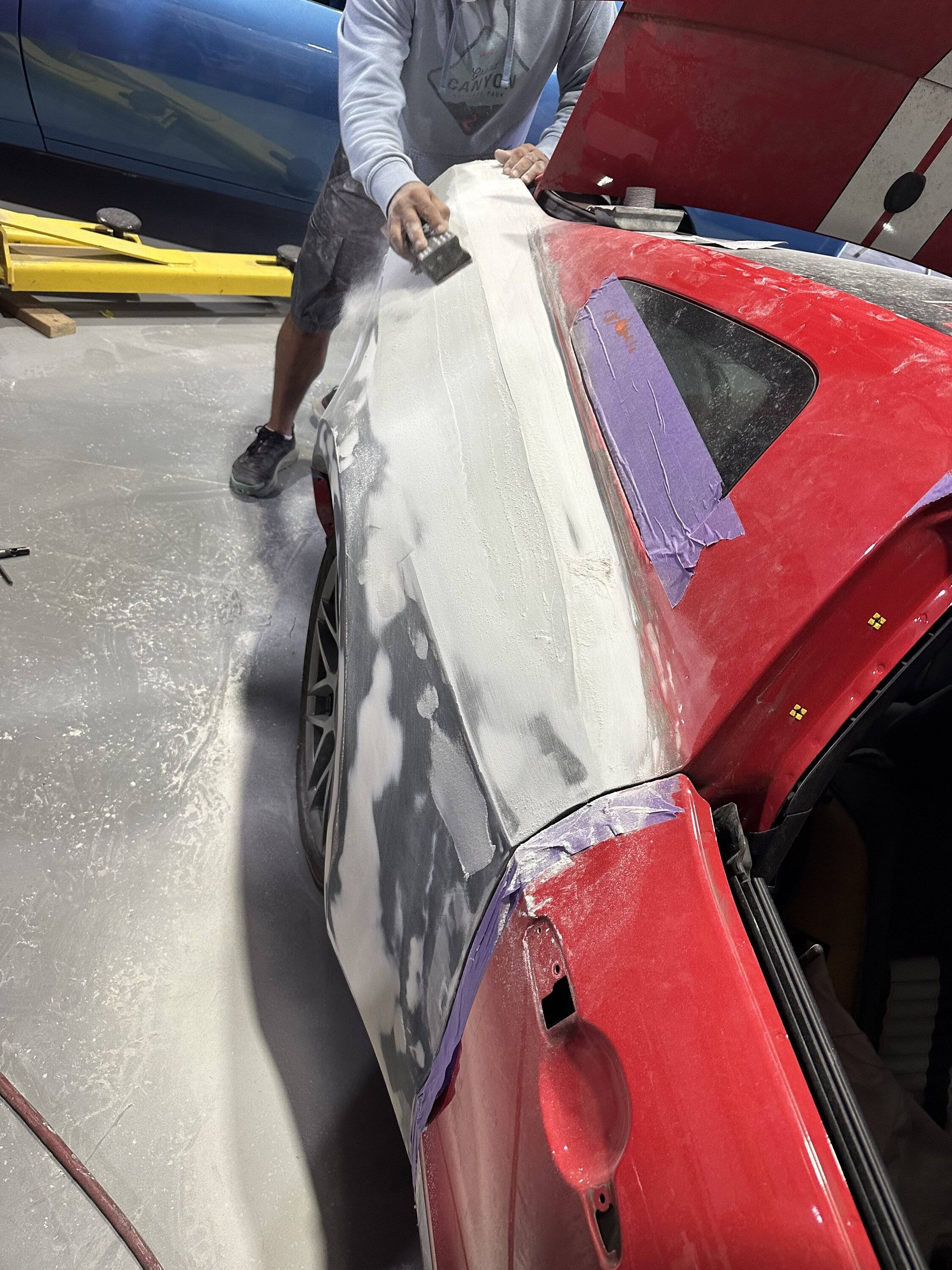

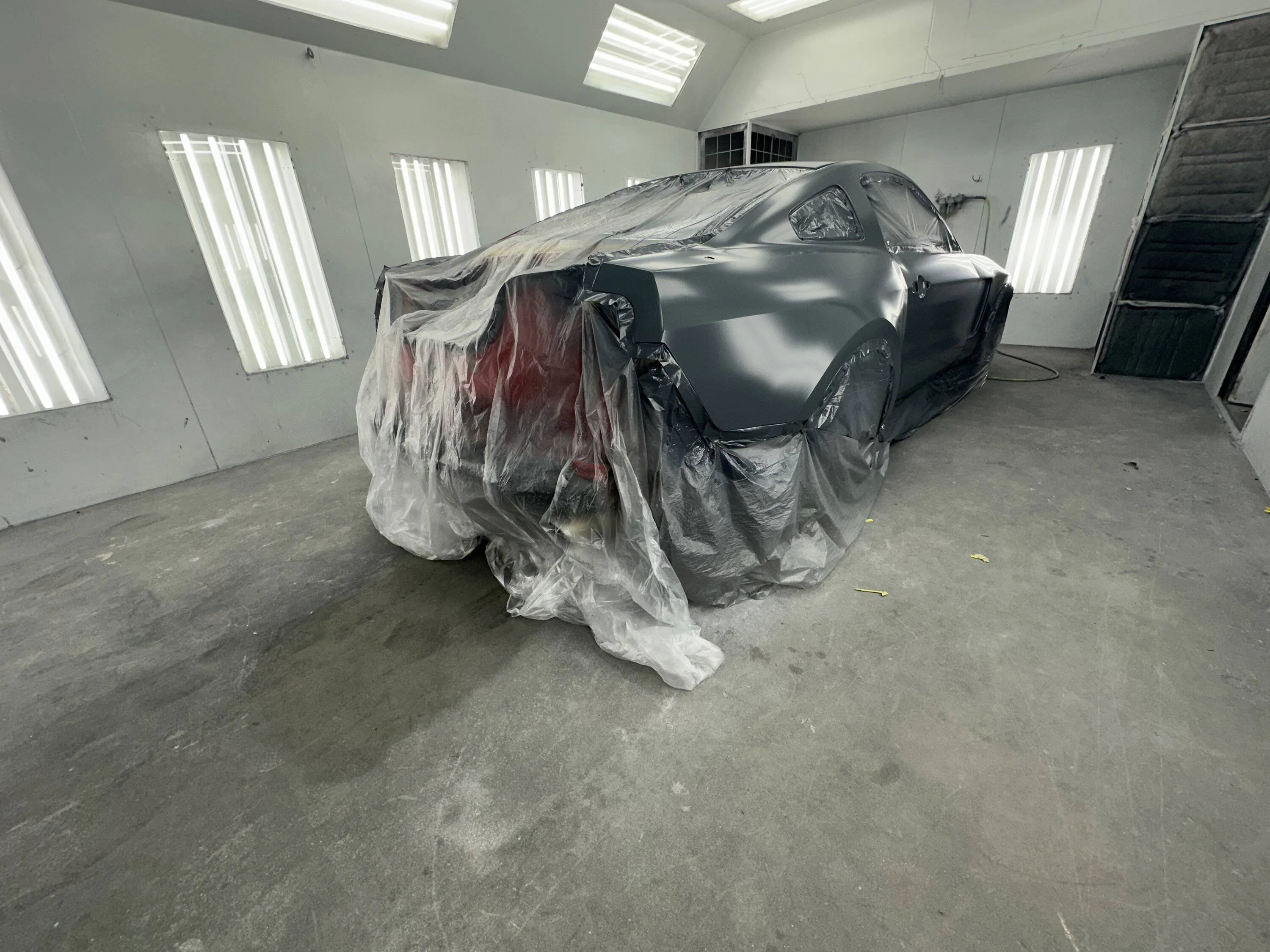

And for any divas out there this is our primer final prep booth before going in our nice booth. We don’t spray primer in it! Here’s some of the first body work matched up fender and doors, now waiting on new brackets to install bumpers to then match fenders and atr to bumper

How is the rear quarter done? Is the original quarter cut out and the new glued on In an overlay fashion or is it butted. Old p&b guy here, absolutely love the smell of fiberglass. Brings back lots of good memories. Very cool.

no, the fiberglass is sent cut to fit and it is an overlay, the fiberglass is than panel bonded and fiberglassed into the metal for a seamless look. Obviously a lot more to it just the short version.

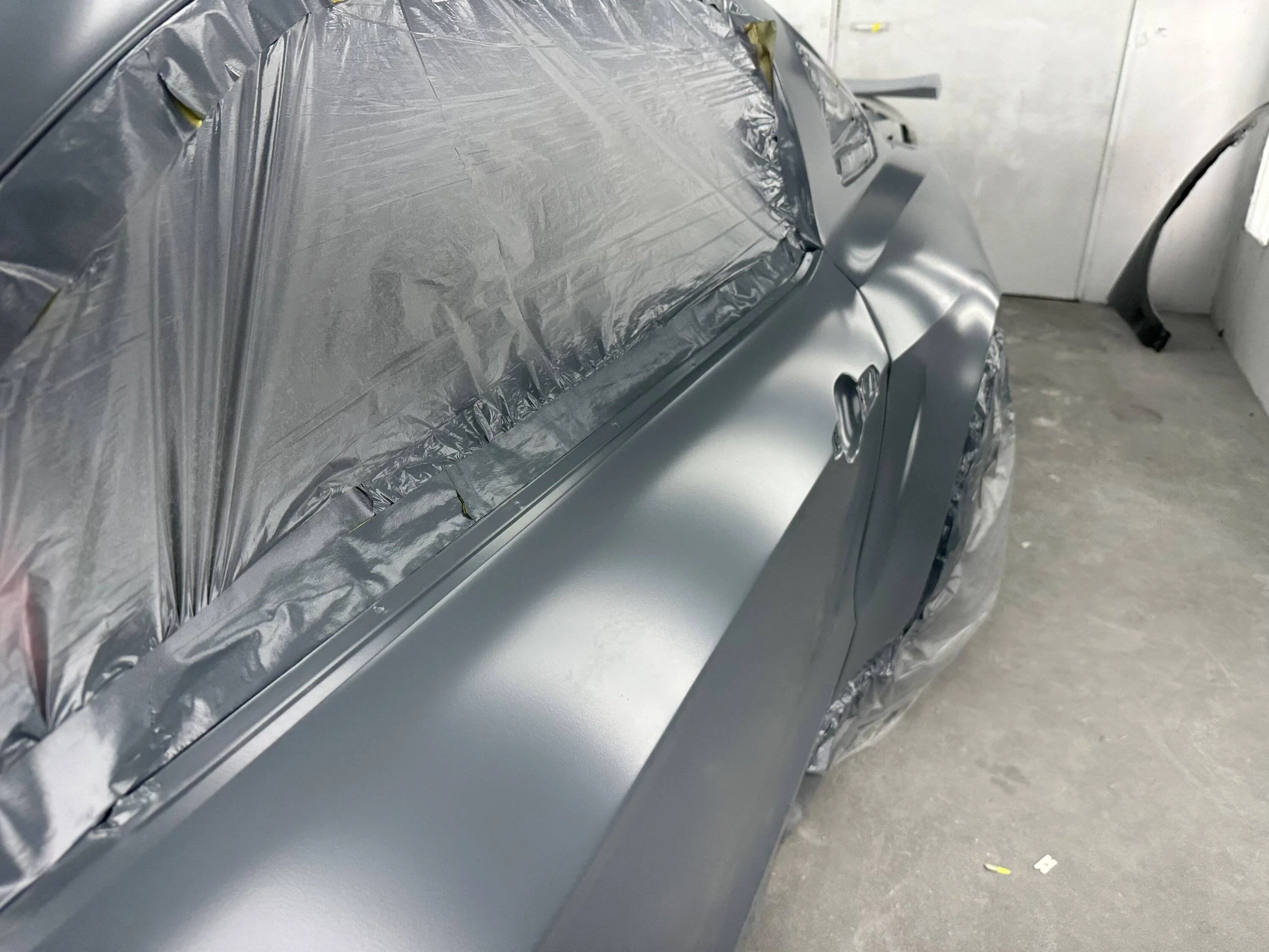

Edit response: sorry hate typing on the phone, Shelby sends it with over 2 inch of extra fiberglass so that you can trim back and make it fit, It actually fit pretty darn well. Our team here loves doing the custom stuff gives them a break from the insurance type work. We do this with no time frame as we take these in with at our discretion since insurance work is what pays the bills. We plan to finish installing bumpers this week and come in on the weekend to finish the panel to bumper finish, so we can seal one last time before painting. Since your a P&B guy you appraciate the headache lol we are even going to wet color sand, we want it FLAT FLAT.
