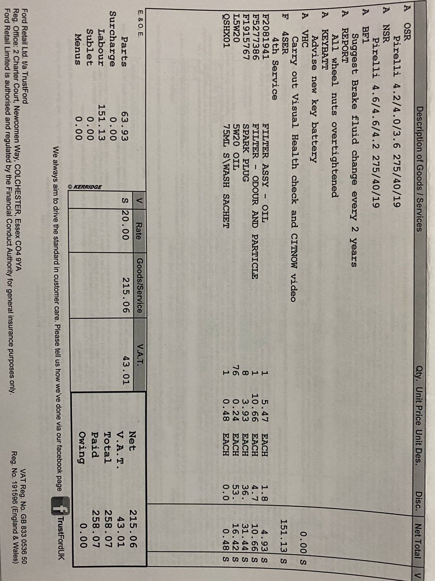

This is what was done on my cars 4th service at about 40,000 miles by last owner.
there isn’t a great deal more you can do.
engine oil/filter
Air filter
gearbox oil
Diff oil
Brake fluid
Cabin filter
Plugs
Coolant
No fuel filter on the GT. built into the pump in the tank.
Might have missed something but it about sums it up.
good inspection of under side inc pads disks etc.

Ok thanks
I’m impressed with your bill, I was expecting double that for all those fluids at dealer prices

Am i reading that right they charged 16.42 for the oil?
pdavison
Aug 9, 2019
55
UK
Paul
2016 Mustang GT Convertible 5.0 V8
That's a bargain if that's right as I was quoted nearly double that!

Paid that much for just the first service at Ford which was only an oil change. My second service in March is £330!
That’s at Hendy Ford in Eastleigh.
But those prices make no sense in the photo. There is no way on earth spark plugs are £3.93 each wherever you buy them.
£4.70 inc Vat. Not unrealistic. I have just bought a set of 8 NGK6510 for £62 or £7.75 each.
Ford Leeds called me today regards my 4th service. £435.00 inc vat!
This does include new plugs.
Wonder what they would say if I produced the invoice Craig kindly posted?
As above, plugs are supposed to last 80k+
