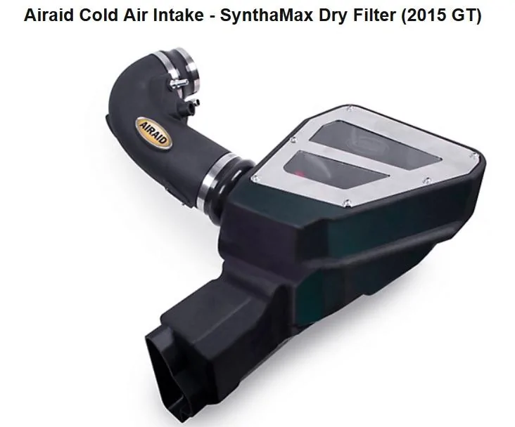

I feel confident enough with the way this is being handled that I just bought my self a Christmas present from American Muscle. A new cold-air Airaid! It will be here by the time we tune!
