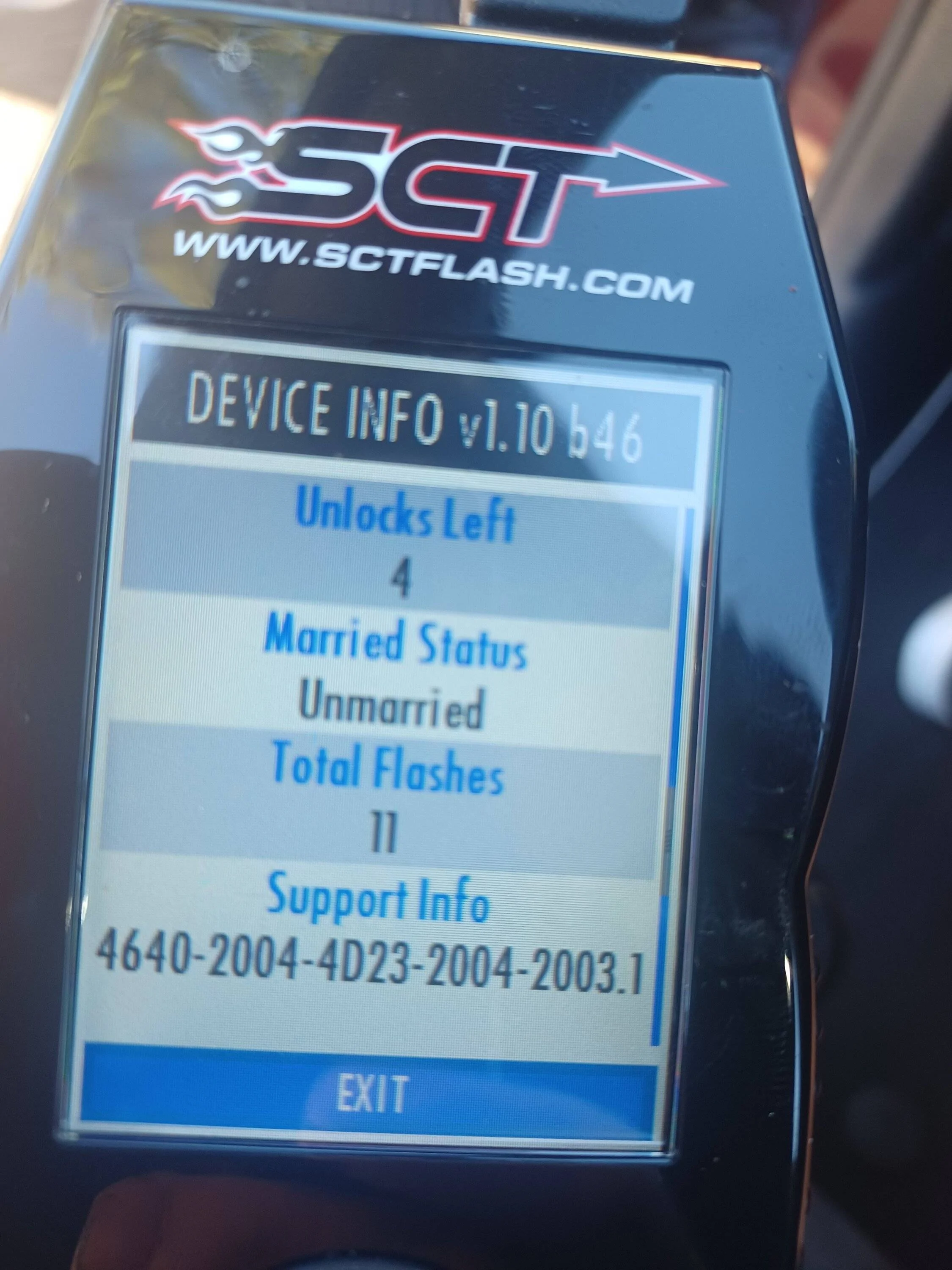

hello i have a question how do i marry my sct to the car. it says unmarried even tho i uploaded a custom tune with it. does it effect anything if its not married.( new to tuning)

Did you reload the stock tune? If so it will show un-married. If you re-load the custom tune it will show married.
Anyway that is how it is supposed to work.

thanks yes i did reload the stock tune. i got an new tuner and awaitng the new tune thanks for clearing that up
