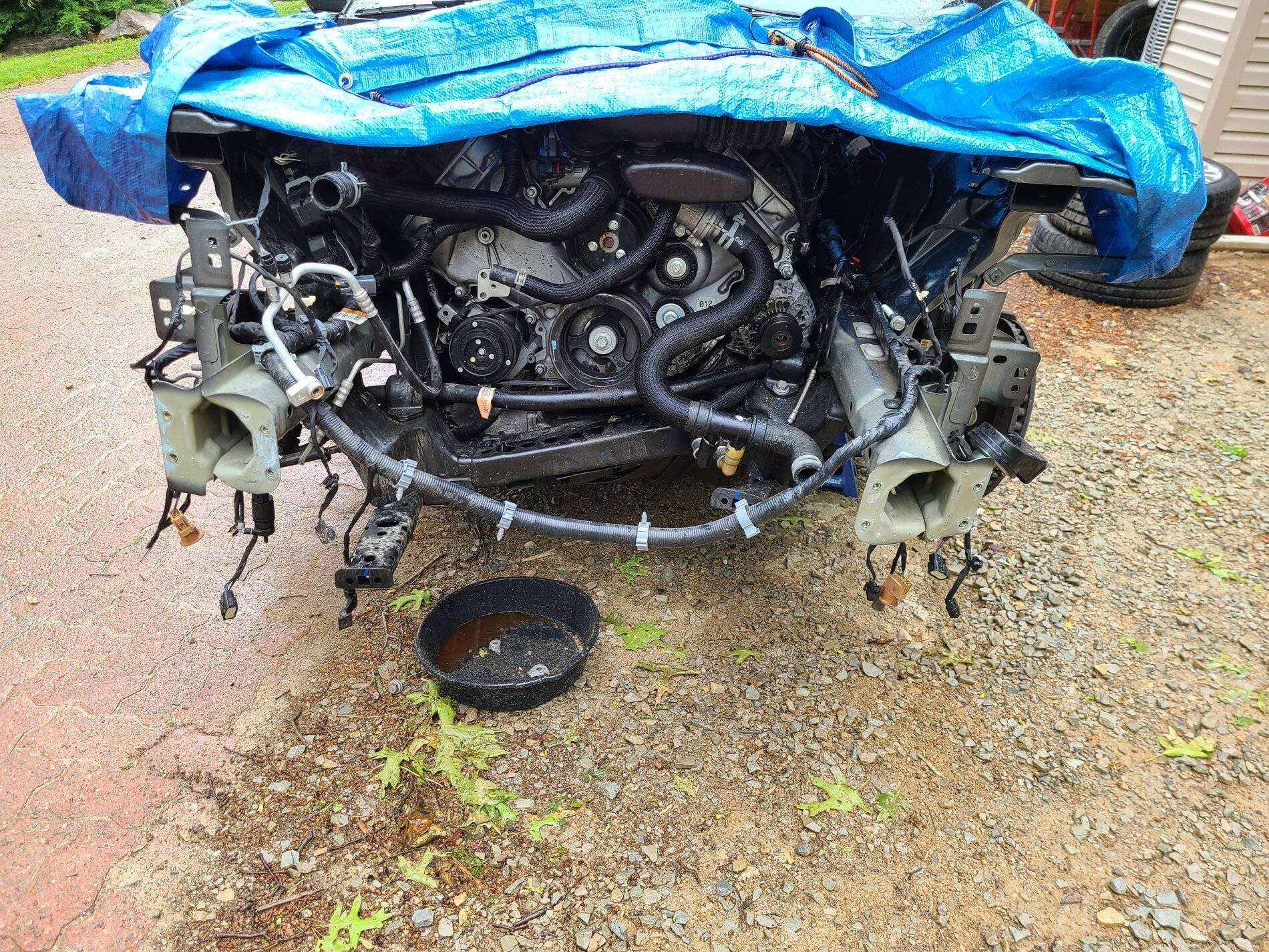

Are you trying to run it as seen in the pic or is there a lot more that has been fixed from that pic? There's many disconnected harnesses there.
Ts2016
Jun 1, 2021
39
Pa
Todd
16 gt 89 gt
As pic. Only thing I disconnected was lights basically. Maf plugged back in
Deleted member 35644
Guest
It's sounding like your ECU doesn't have any idea how much air is entering the engine, and doesn't know how manage fuel because of it. Not sure if the 5.0 uses MAP or MAF, but I don't even see an airbox in the picture.
