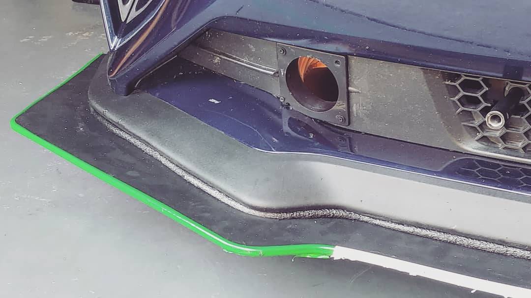

One of the perf pack Advantage is the shape on the undertray with 2 "front tunnel" pointing to a to oush air into the rotor. Vorshlag developed a bigger deflector together with marco garcia (former ford engineer who developed the brakes for the stangs) claiming better cooling performance than the normal hoses. (Testing left vs right temps with the 2 different setups)
One thing forsure is there is way more air coming from inside the tire vs outside.
So yes cooling is better with standard rotors.
Is it enough? At the beggining for sure. With speeds increasing not at all. Cooling hoses/better air deflector are necessary with the progression of the driver skills and speeds.

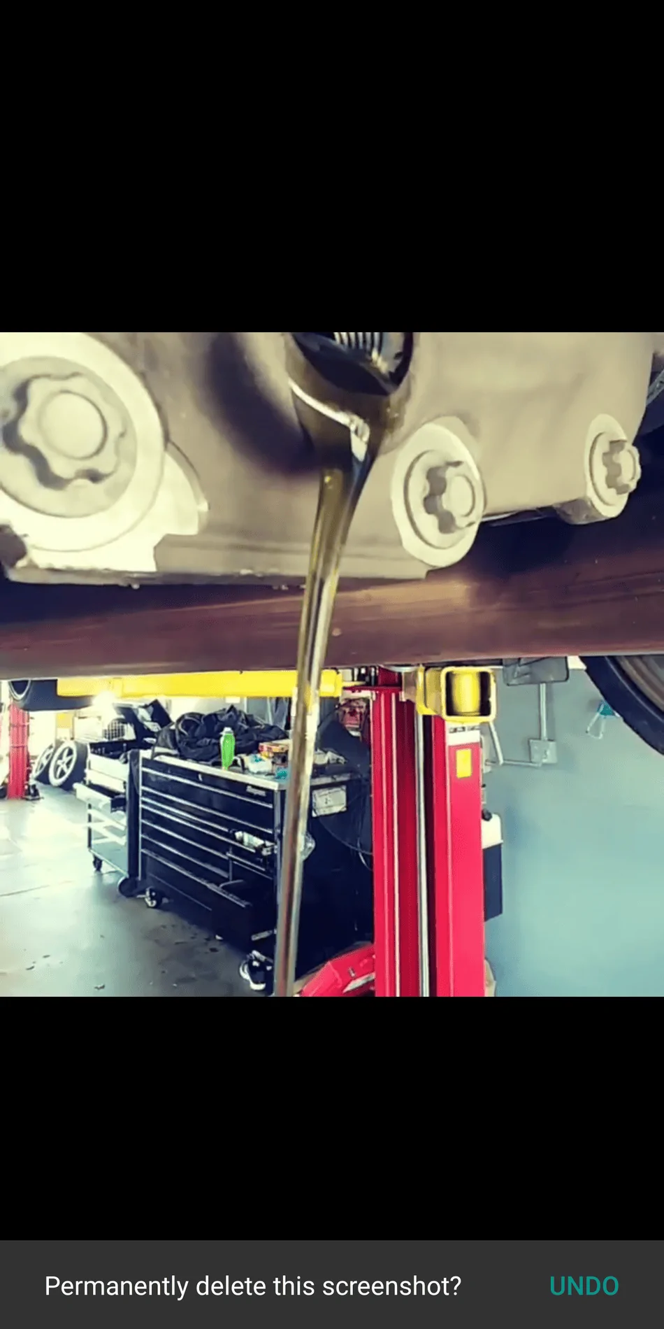

This is the fluid with 5 trackdays with 100f. Zero debrees. Clear. I really suggest it :)
