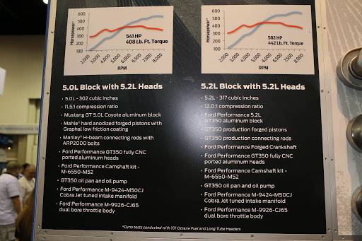

The octane # is given to illustrate what it takes to get the power advertised. Nowhere does it say that 101 octane is "required" to run these engines safely. But if you want those power numbers, that's what you have to run.
Exactly. It can run on 87 with enough timing pulled and valve overlap.
All I said is with emissions equipment and pump gas, we’ll see 40hp and 20tq less. That’s all.

Unless something changed:
101 octane.
Hmm. Strange that there's no disclaimer on the power output on the Ford Perf. website. It eludes to the 580 hp rating being achieved with premium fuel since that is the fuel listed in the bulleted list.
