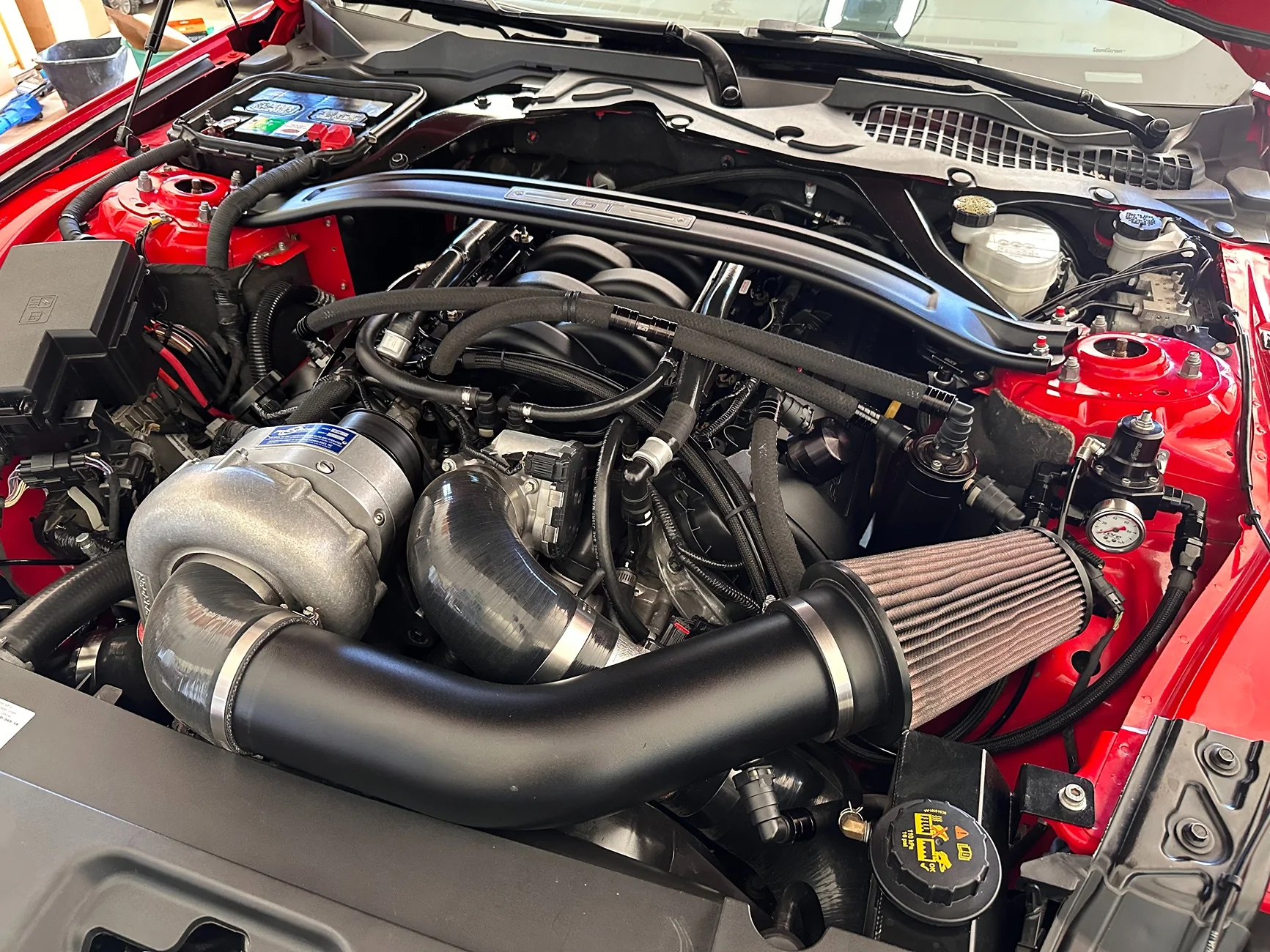

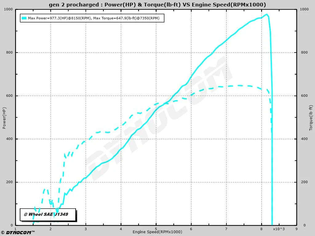

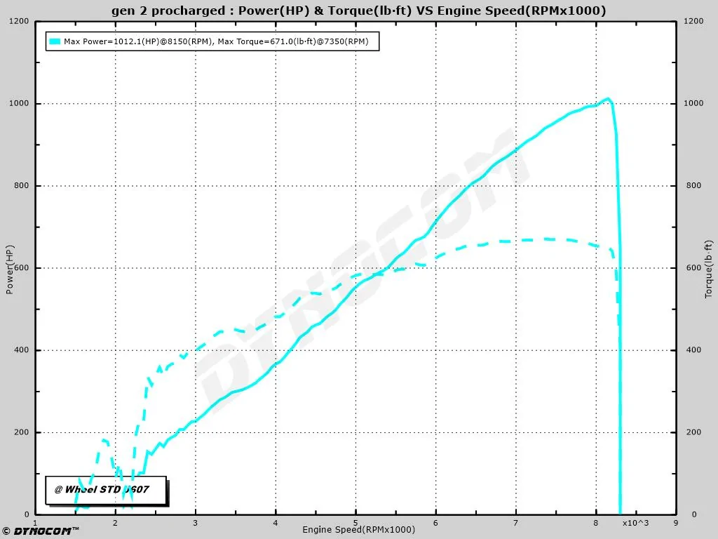

I finally got the car dynoed with my Procharged D1x RPG 5.2L build and it was pretty impressive.
Made 1012/671 STD or 977/648 SAE
Here's a quick 3rd gear pull which just blew the tires off (so added for sound) and a full 4th gear.

You are 200hp away from max blower rpm.
I had a smaller 3.10" pulley as well, but decided to leave with this setup for now. Currently with the twin 274's (450lph) and FIC1440's I am at 76% duty cycle. I am sure I can push it more but my tuner said "to make him happy" I should add a third pump.
So I'll do that after I add on other parts.
