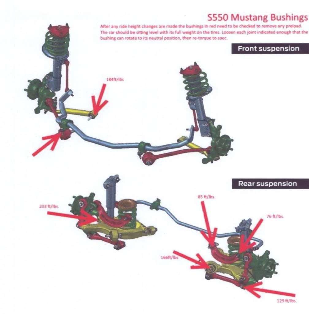

Not sure how clear this will be as it was a very low res pic when I downloaded it, and can't remember where I got it from, but this shows what should be adjusted, and the torque specs, when resetting the preload after dropping the car. There's probably clearer information out there... it's just a case of finding it!
Cheers pal :D! I take it the highest arrow on the left (for front) is also 184 like it's compatriot?
That's itemised by Ford (it appears to be one of their diagrams) as the 'tension link'. Don't know why there's no figure on that one, but would expect it to be closer to the 120-130 ft lbs region.
Will have to look into that further... know anyone with an S550 Ford Technicians Manual?
Me.
It's 6600 odd pages but when I get a minute I'll have a look.

Take a look at this post. I got some spacers made up, I think all the info is there. If not just ask.
http://www.mustang6g.com/forums/showthread.php?t=87590&page=2
I haven't got round to fitting them yet, it'll probably be spring now. It's a bit cold to be rolling around the yard floor at the moment.
The picture of which bushings to clock is in the sticky of the suspension section in the main forum.
