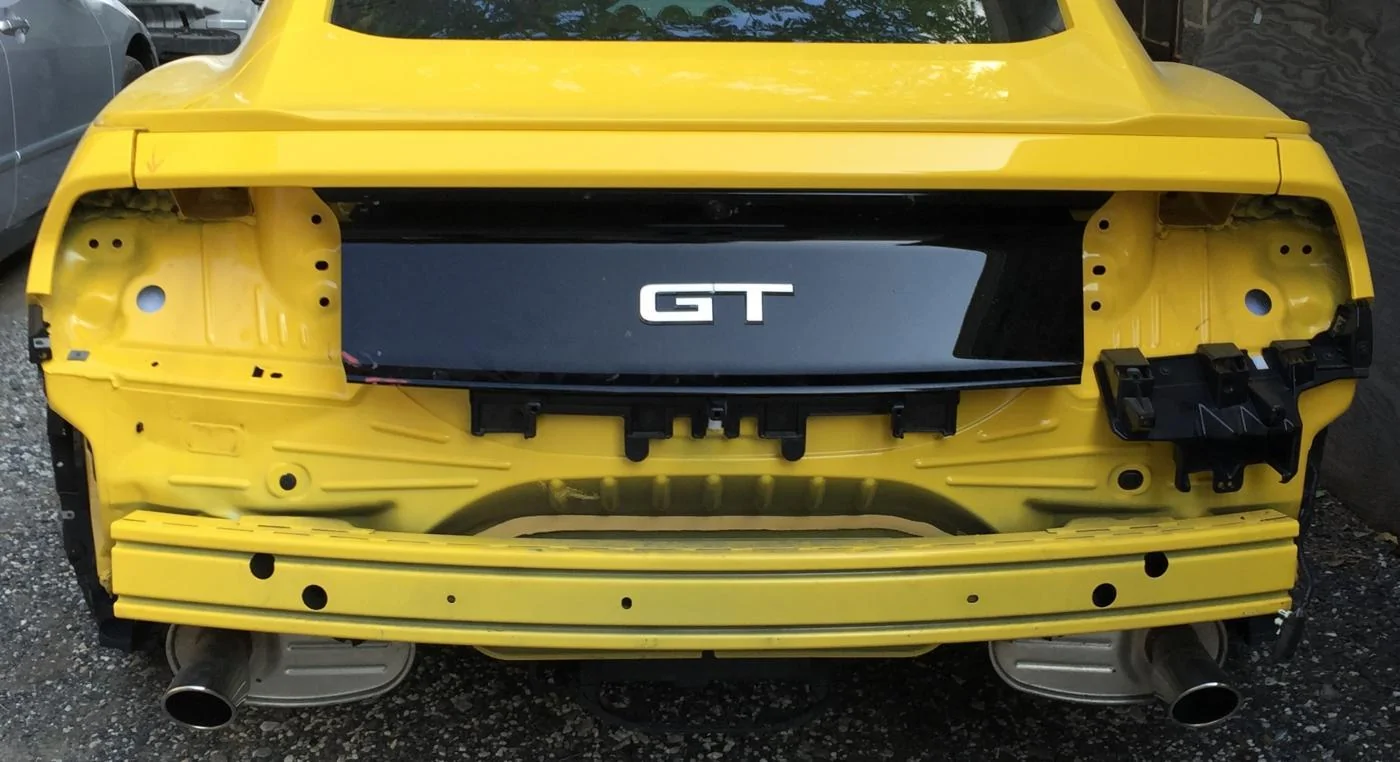

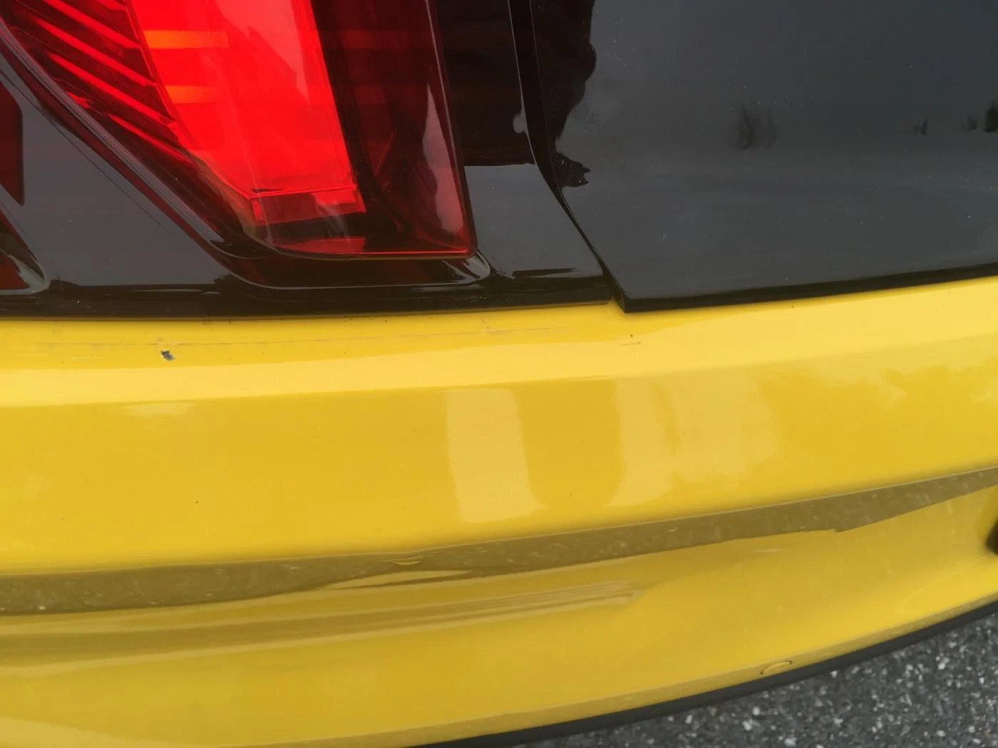

Many of the items listed are not visible in the photos you posted. You should go to the shop and have them show you each item explaining why it needed to be repaired, replaced or removed. I would also ask for a complete set of original and in process photos taken by both the shop and geico.
The shop is definitely one that likes to nickel and dime estimates. Could mean they have a bad relationship with Geico or it could just be who they are. We have Mercedes, BMW, Porscche etc... Dealers in Beverly Hills who don't get that picky on estimates.
Some of the items don't make sense. No need to remove the front windshield. Our windshields do not have moldings and have huge gaps for back taping. The damage does not look significant enough to justify replacing the rear body panel and they don't explain or provide a part number for the Inner Panel for $514 + 11.0 hours. No photos that Justin the need to blend the right 1/4 and they charged to spray color on half your roof and clear the whole thing but they aren't going to put any color on it so it should be clear only. They are not going to remove the battery they are only going to disconnect and reconnect it or attach a monitoring surge protector to it. No need to remove the doors and by no need I mean Ive never seen a shop ask for this for this type of repair and you don't want them to for alignment and wind noise reasons. They also have repair time on both side members which seems odd but again there's no photos. They have 7.3 hours for wet sand when 99% of shops charge .5 per panel which would be 3 hours. Think about it 7.3 hours means they would spend an entire day hand sanding the 5 parts they painted! No chance. You could remove all of the clear coat in that amount of time.
Like someone else posted its the insurance companies money so not sure how much it really matters to you but they are doing structural repairs, removing structural panels, pulling your unibody on a frame machine so you should make sure you understand what they are doing. Oh also ask for a copy of the frame print out before and after pulls that will show measurements in millimeters all of which should be less than 3.0 mm. If they don't have electronic measuring equipment I would be concerned.
It is possible that all of it is justified but you would need 20+ additional photos and even if so they still overcharged and did some operations that are not necessary and most would consider over repairing which is not a good thing. The less parts they touch, remove or paint the better.

The alignment between the rear quarter and trunk on the collision side is all screwed up as well, so I wonder how much "finessing" that takes
This ^^^^
I noticed the very same thing. $$$

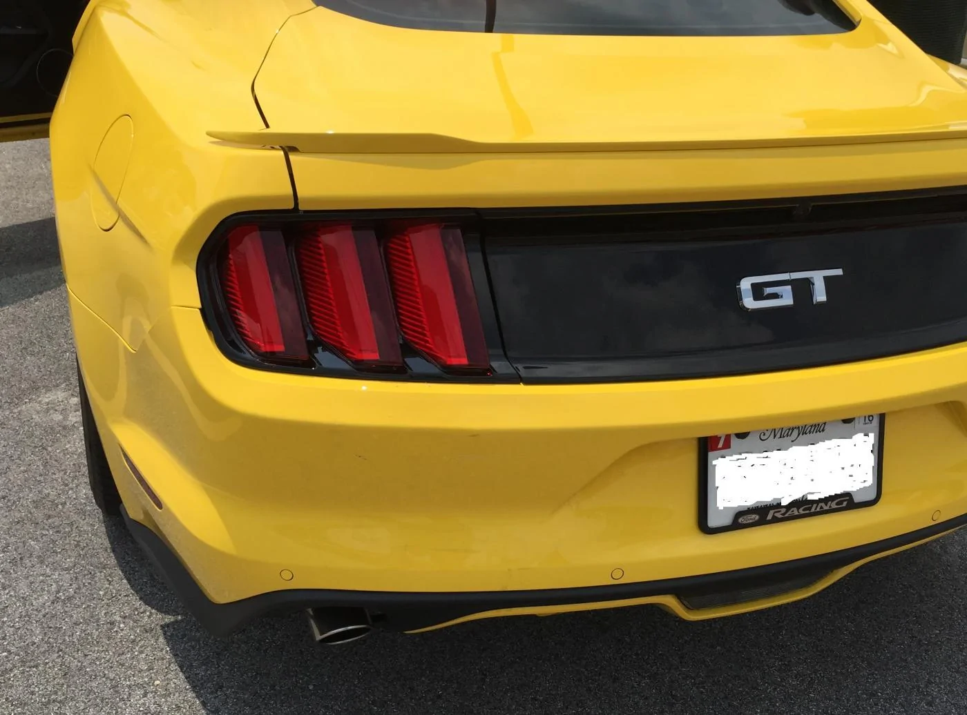

Figured I'd do a general update since it's been a while:
So I finally got my car back on the afternoon of 8/19. Unfortunately, I only had a few hours to drive it around before putting it in the garage for 4 days while I went off to Vegas.
The body shop told me at the time of pickup that they would need it back for a day at some point the following week. Apparently the paint was too soft and the car still needed to be polished, etc. They knew I wanted it back, plus they were about a week past the time that I was "promised" the car.
Came back from Vegas, made arrangements to drop it off for a day. They did the polishing. The paint job looks great overall. Plus, they actually fixed some of the crappy panel gaps that came from the factory. However, I wasn't happy with the trunk lid alignment. To be honest, I also wasn't happy with how they were trying to fix the trunk lid alignment which was by opening the trunk and literally pushing on it horizontally to basically "bend" the hinges into position.
Also, the weather strip at the bottom of the fast back glass (where it meets the trunk) was coming off. They ordered a new one and I will now have to drop it off to them tomorrow to replace this piece, finish the trunk alignment, and fix a metallic rattle that I'm hearing under the rear of the car on startup. Hopefully this will be it.
