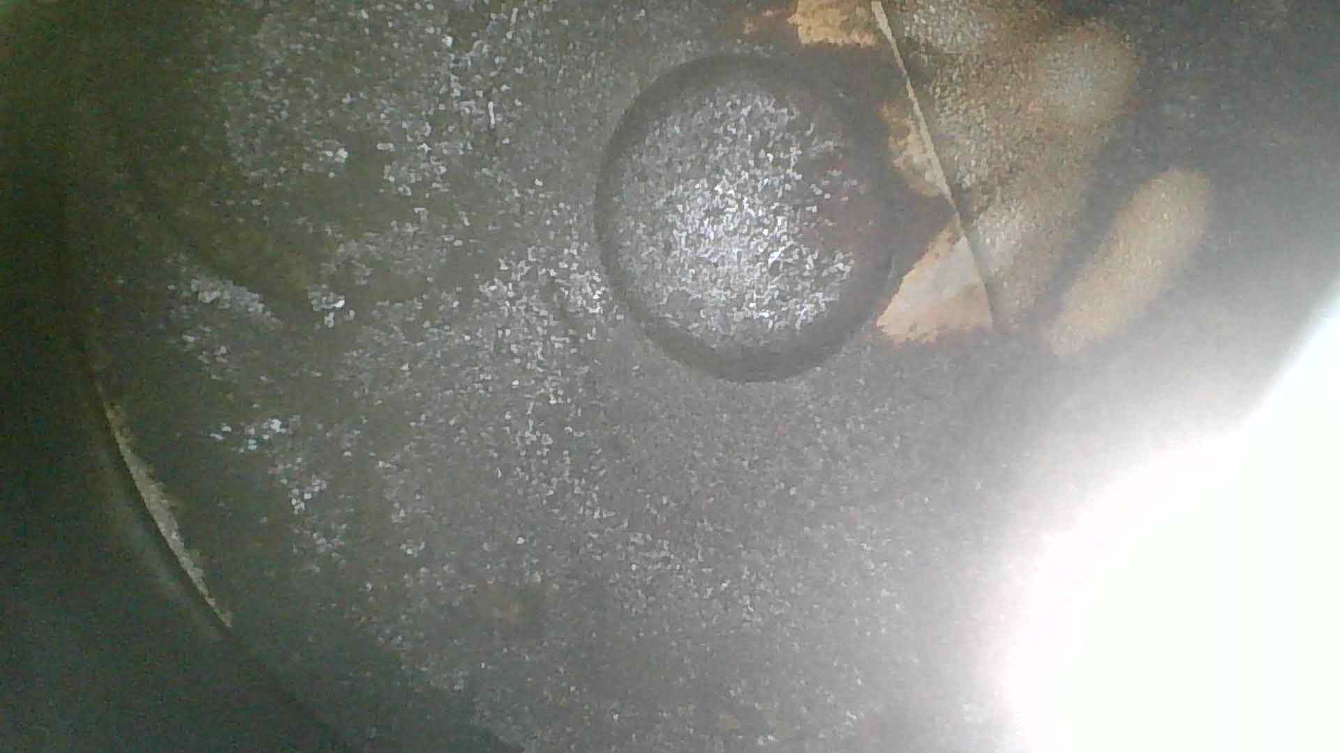

That's just very surprising that you'd get knock on the stock engine map with good fuel. I wonder what your pistons look like. I know the AUS calibration is a bit different, and it may be playing into things. But it's still cool there, isn't it? My car only did it when it was hot outside with a spicier calibration, although as I said, it seemed like the knock and the noise overlapped but weren't consistent with each other. I got it during downshifts in some cases, which is impossible if it's ping.
With that said, light ping isn't really harmful on a naturally aspirated engine. The manual even mentions this. But I do understand the frustration/embarrassment. Trust me, I tried figuring this out for quite some time. The only thing I can recommend is checking your long term fuel trims and making sure everything on the intake plenum is sealed up (this includes any catch cans).
This is what my pistons looked like after about 20k miles, fair bit of carbon but mine does not make the noise on the stock calibration anymore.

Have you tried putting in a fuel additive to reduce carbon? I was wondering if maybe adding a catch can might help?
I've read pros and cons on the dozens of forum posts about them, but in theory they should help reduce carbon build up, if indeed this is my issue...

I have been running a catch can for the last few thousand miles. Haven't rescoped since then, but I probably will soon. Have not used any fuel additives besides boostane, which seemed to help (but is not recommended for long term use due to the manganese deposits). Not sure if any additives would do much for this type of buildup on the crown.
If you do try a catch can, the Ford Performance once is what I'm using. Also swap in a new PCV valve while you're at it, just in case it's not fully closing.
