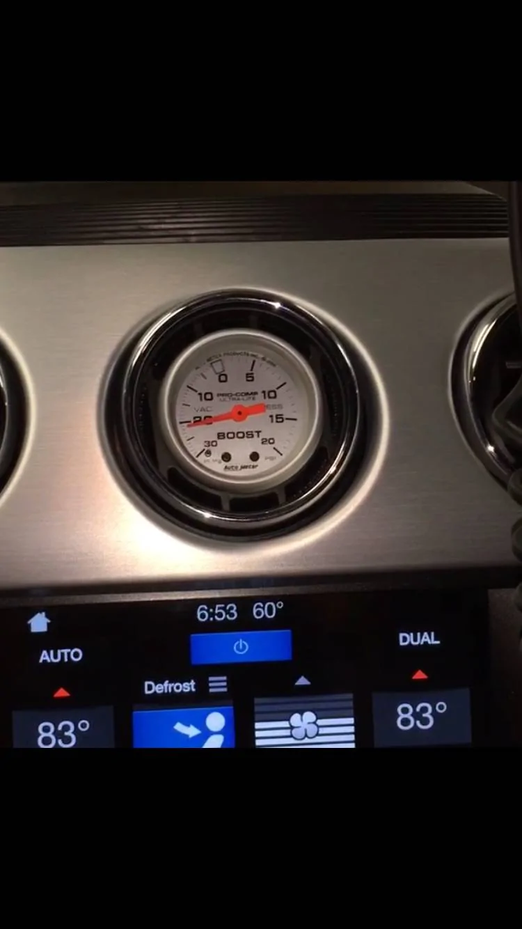

Used an ac vent, can post pics when I get home. Found the mount on here, someone prints them.

Vent mount.

Awesome!!! But how did you run the silicone vac hose??
And did you feel a loss of a.c. by eliminating a vent?
Thanks Ant
I ran the nylon capillary line down and under the glove compartment area and out through the inner fender, and back up through the strut tower....
AC is not affected because all 3 vent openings combine into 1 behind the dash. There is also small vent slots around the gauge for some air movement still as well.
Thanks Ant
How were u able to get line through a.c. duct?? Where did you make a hole and how did you get drill in there??
Thanks Anthony
Thanks Anthony
No drilling. Just snaking the line down the gap between the vent and the inner duct. When you remove the dash plate, you’ll see....
