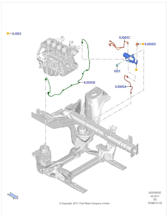

I had rough idle nothing like car wanting to shut off or anything like that. Just rough idling.
Didnt even knew i had rough idle because i import a salvage mustang and and repairing it the mechanic told me you have a ripped wire harness.
Turns out when checking it was a vacuum line that goes from drivers side to passenger side all the way down the car.
Replaced and car idling was normal.
Maybe check if you have a vacuumm leak in a hose.
There is a black vapor cannister right behind the air intake with two or three hoses one goes in drivers side other goes to passenger side.
You can identify the cannister it has like a tip pointing upwards.

2018 Mustang ecoboost
I noticed mine when idling because when i placed car in neutral and turned on RPM dropped. When replaced hose RPM stayed the same no matter is car was on D or N when stopped.
No code or anything it is a hose that was ripped in a collission. i replaced 6J005B on diagram, the cannister i mention is the one labeled as 6J005D
