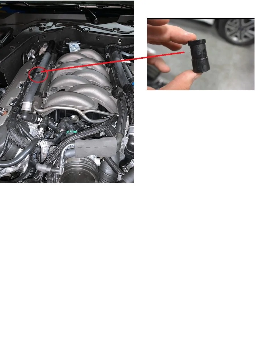

So Im doing my Whipple install and there is a restrictor pipe inside the passenger side hose area that needs to be reused?
I show a picture here. Anyone know what the purpose is for? Im assuming to restrict flow for some reason? Just curious because the driver side does not have it- just passenger.

It's usually there to restrict flow to the heater core. Probably so it doesn't get blown out by added flow/pressure.

^^^ 100% correct.
These were also common in the 1986-1995 5.0’s. In those models, the restrictor fitting was made of steel; it was only found in 1 hose located at the firewall which went into the heater core. The problem is, if someone didn’t know about that tidbit of tech info and replaced/discarded the stock heater hose, the restrictor was gone... new 86-95 5.0 heater hoses didn’t come with the restrictor.
Good find and hopefully your post helps other S550 owners in the future.

I would say it's there to slow the flow down so the core absorbs more heat from the coolant to be more efficient.
