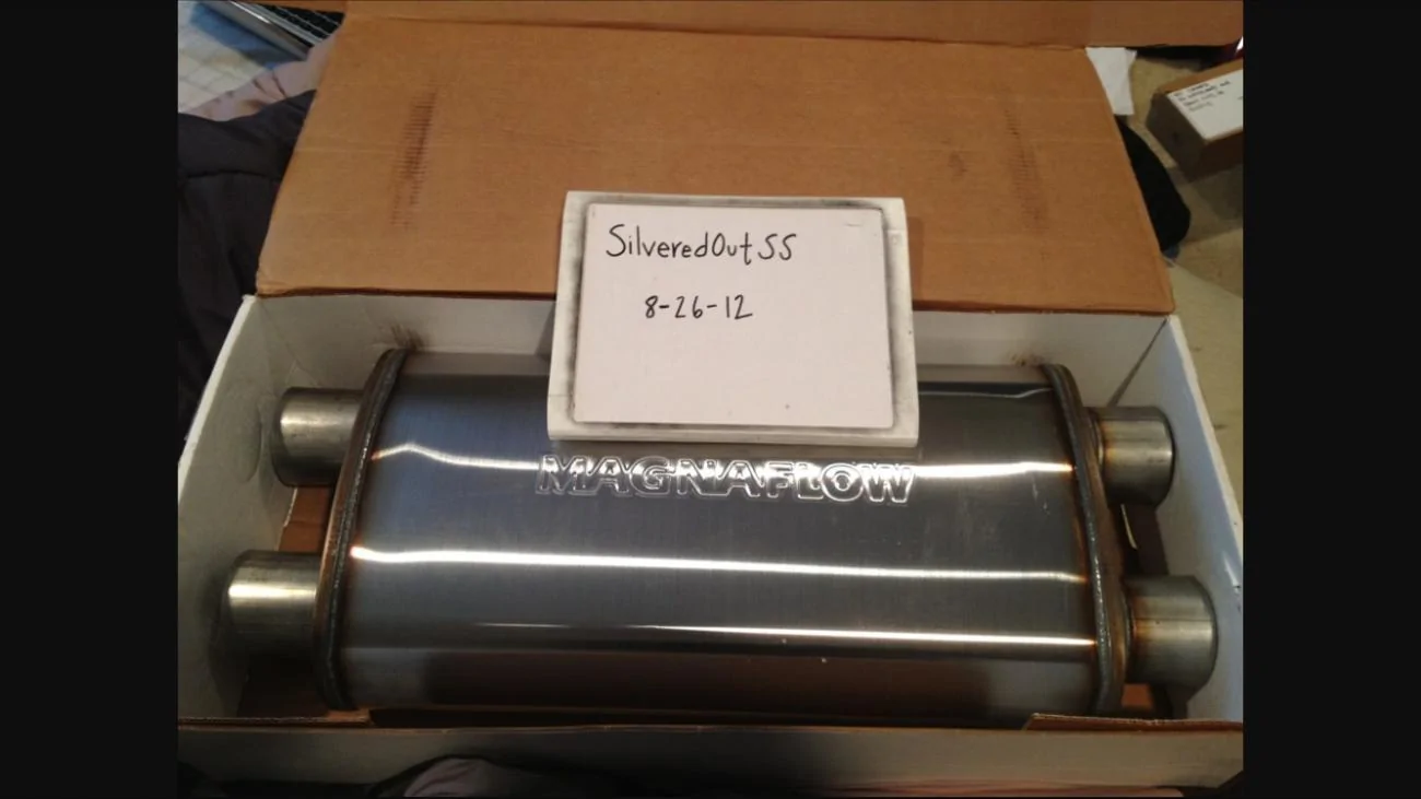

12599 won't fit on the MBRP because of how far the inlet and outlets are spaced out from each other, 12468 won't fit either because it is only 2.5 inch . im also currently searching for something that will fit my MBRP. From what I have seen there is nothing from magnaflow that will work unless you go with the internal Y pipe which I don't want to do.
I have the 12469 with stock mufflers on mine
I'm supercharged so I don't want to increase back pressure going with the internal Y muffler. Trying to find an X muffler that will fit.
You could do an after the collectors and then two bullets to keep the flow . The 12599 will fit but hangs down lower . The x with bullets will be more compact
Thanks that sounds like a good idea. Is there an X and bullets you would recommend?

I ordered the 11379, it's not 3" but hopefully it will help

Just to update everyone, the 11379 worked great
