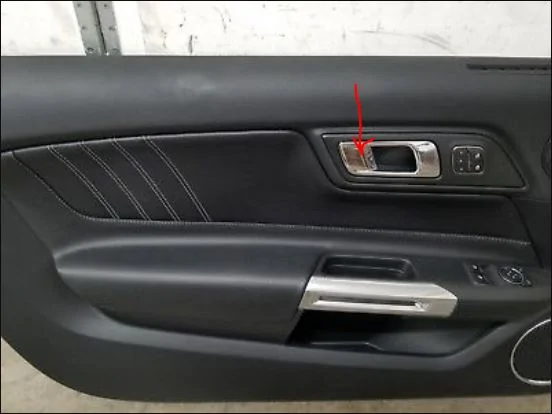

Hello,
I have purchased 2015 Ecoboost Premium PP recently.
I am looking for a tutorial how to replace driver's door handle as the chrome is peeling of. The piece is marked on a stock photo with red arrow.
Questions:
1. Do I need to buy whole piece with surrounding bezel? I believe it is part FR3Z-6322601-BB.
2. Is it replaceable without disassembling of the whole door panel?
3. Is there any youtube video? I was able to find only couple of videos for the whole door panel assembly.
Thank you!

The entire door panel has to be removed to replace that part. Once the door panel is loose, there is also a cable that is attached to the back of that door handle assembly so be careful and don’t muscle the door panel off the door shell...
There’s a few threads on here that contain vids showing removal - I think they are either in this sub-forum or the Audio sub-forum.

Thanks you! Then it is probably not worth the effort...
