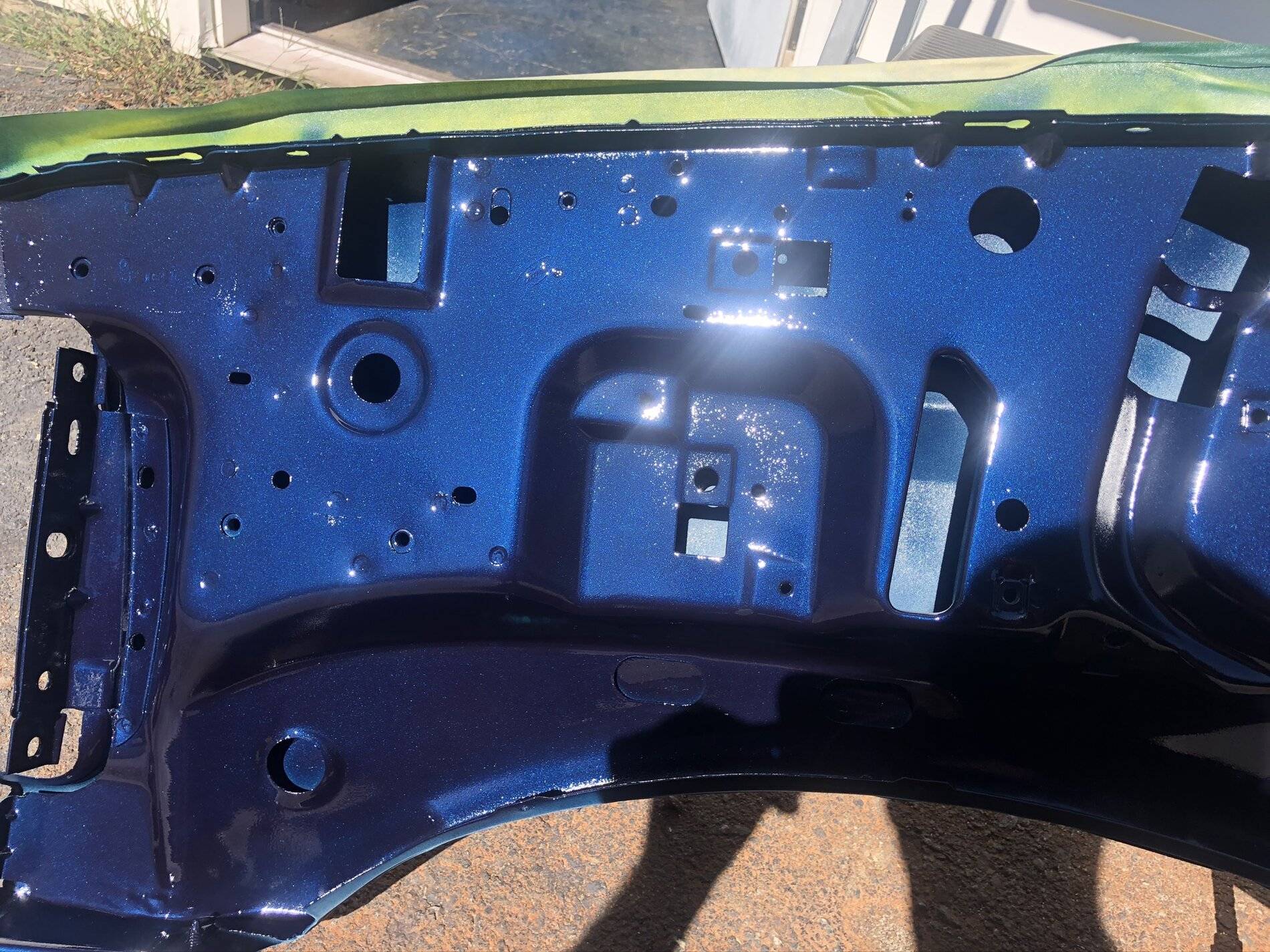

Here's the inner fender on a GREEN fender I started on for the 95 Bronco I redid with my son. It's original paint and rust free - but the RH front fender has some bondo from a fender bender repair (likely done via insurance 20+ years ago). I wanted to test the spray out on the inner fender. Hoping to spray the outer in the next few weeks.
I didn't take a ton of time with prep (it's the inner fender - just didn't want it green) and that's 3 coats of PPG base coat from a aerosol can, following my two coats of Spray max clear coat. Excuse the crappy picture........

I was planning on doing something similar to this, just masking a much smaller area
FWIW - me personally - I would NOT use duplicolor or any other spray paint for a repair. Get base coat put in an aerosol can - any good paint supply shop can do this. And if the clear you are using does not have a button at the bottom to mix the hardener - it's not a true urethane 2K clear.
