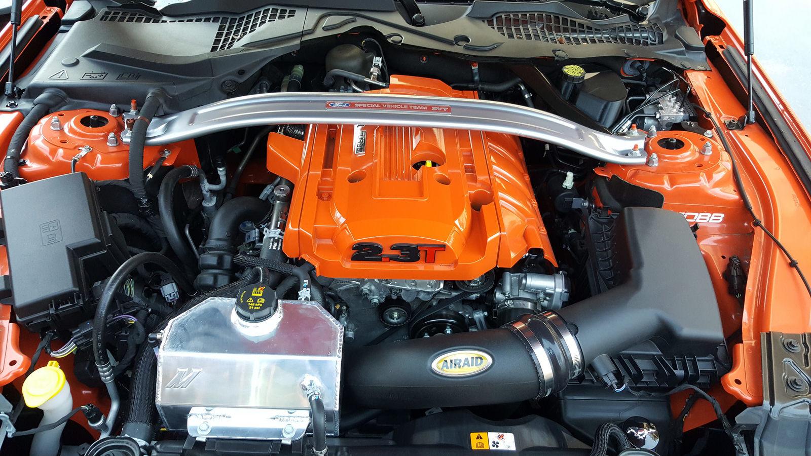

Chef jpd
Apr 1, 2016
63
2,989
3,121
Brooklyn, NY
John
I thought you could simply remove it, without cutting it off. I wouldn't feel comfortable removing it just for a minimal increase in sound. [MENTION=27727]Marvinmadman[/MENTION] thanks anyway :thumbsup:
I cut the resonator off with a dremel. A wheel center cap fit the hole perfectly.
See it just forward of the airbox
20161205_145209 by chefjpd, on Flickr
