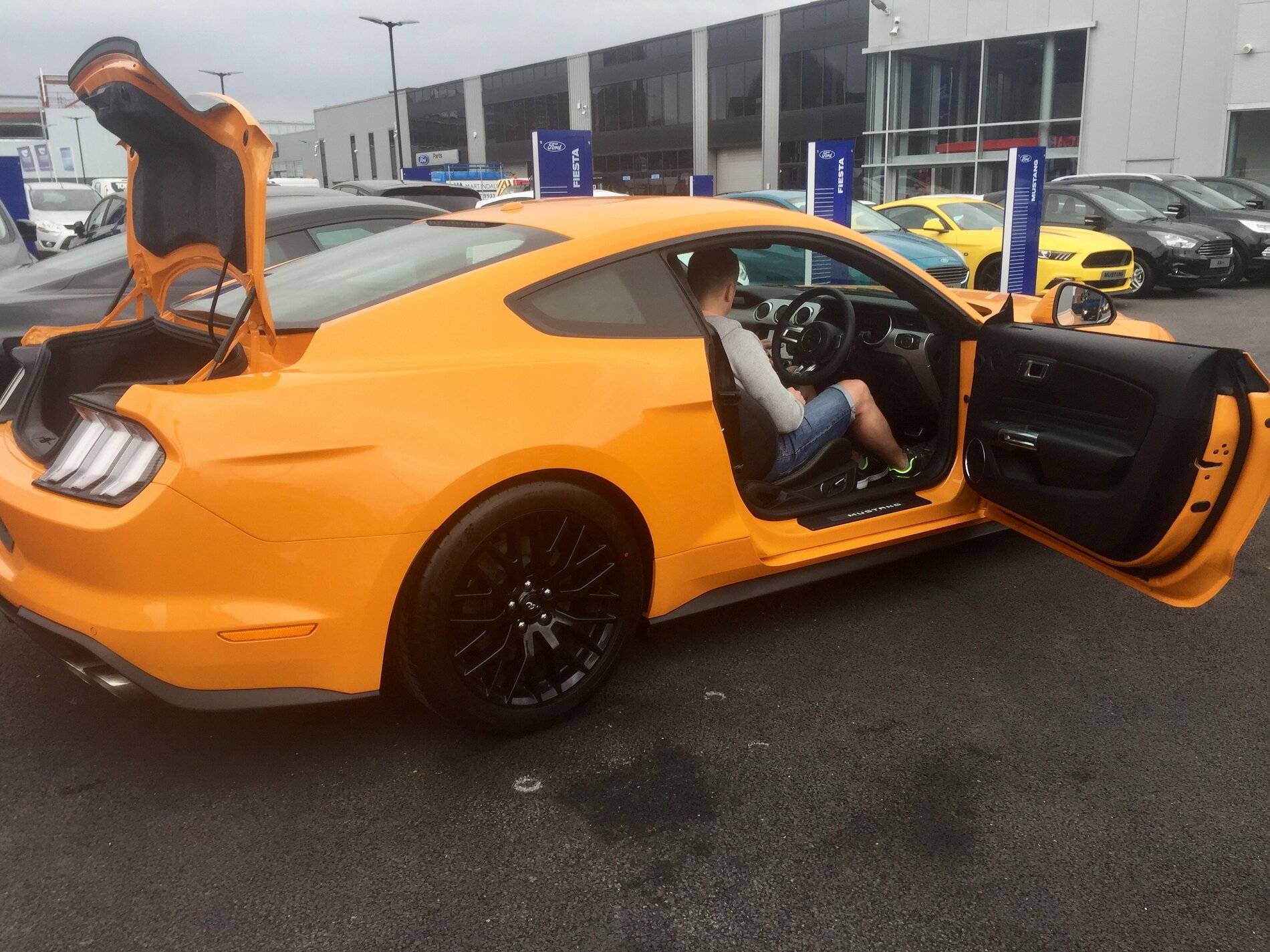

I looked and I am surprised that I don’t have a picture of that area on mine, but I found this when I tried them at the dealer :
If you zoom in the front oblong button does all the base controls and the round button does the lumbar.
That picture answers one of the questions above too - that was the first 2018 that my dealer got in :like:
