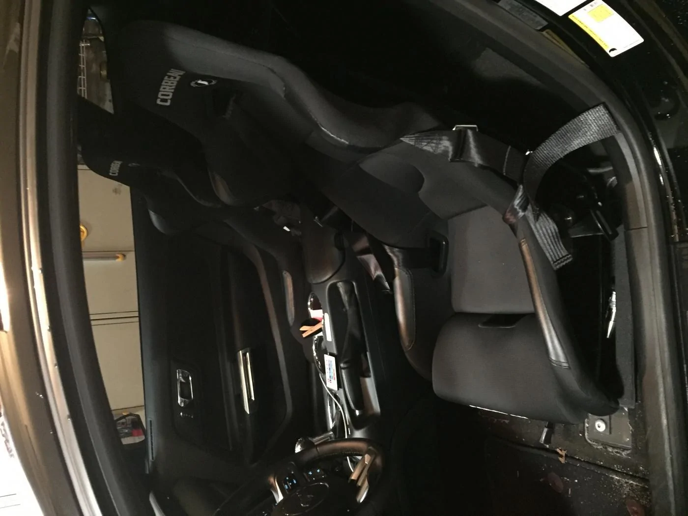

How hard is the seat swap? Has anybody done it? Plug and play?

i put corbeau fx1 pro seats in mine hardest part was getting all the wires out of the factory seat to keep the airbag light off. but other than that it was really simple took me about an hour and a half for both. but if recaro seats come with the wires then it should be very simple just four bolts and plugging in wires.

Yeah, I don't mean to hijack the thread, but can you share what you did to turn off the airbag lights?

i took out my stock seat took every part of the harness, sensor and the side airbag out of the stock seat. then i took the bag off the charger for the side airbag and plug up all the wires tucked them away under my seat and thats really all. ill post pictures soon i just have to take one.
