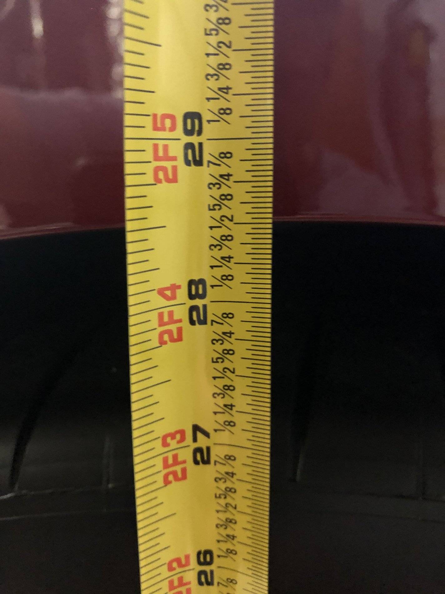

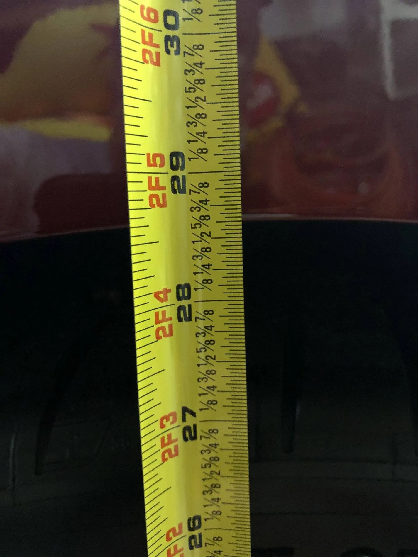

I’m getting ready to lower mine next weekend and decided to take measurements yesterday... factory 2019 pp1 and the drivers side is lower.
Freakin awesome man. I see that. Lower by like 1/8 to 1/4 on drivers side. I figured because my tires rubbed more on drivers side. I didnt measure before all my changes. So at least I know installation is good then. I measured today and about same difference as well. The only thing for me, is based on my spacers and springs I should be like 1/4 higher than I am on each side, but I am not. Long story lol. Anyway cool, good pics.

Mine was filled up before that picture....I didn’t post the pictures of the front but it is also the same as the rear... slightly lower on the drivers side

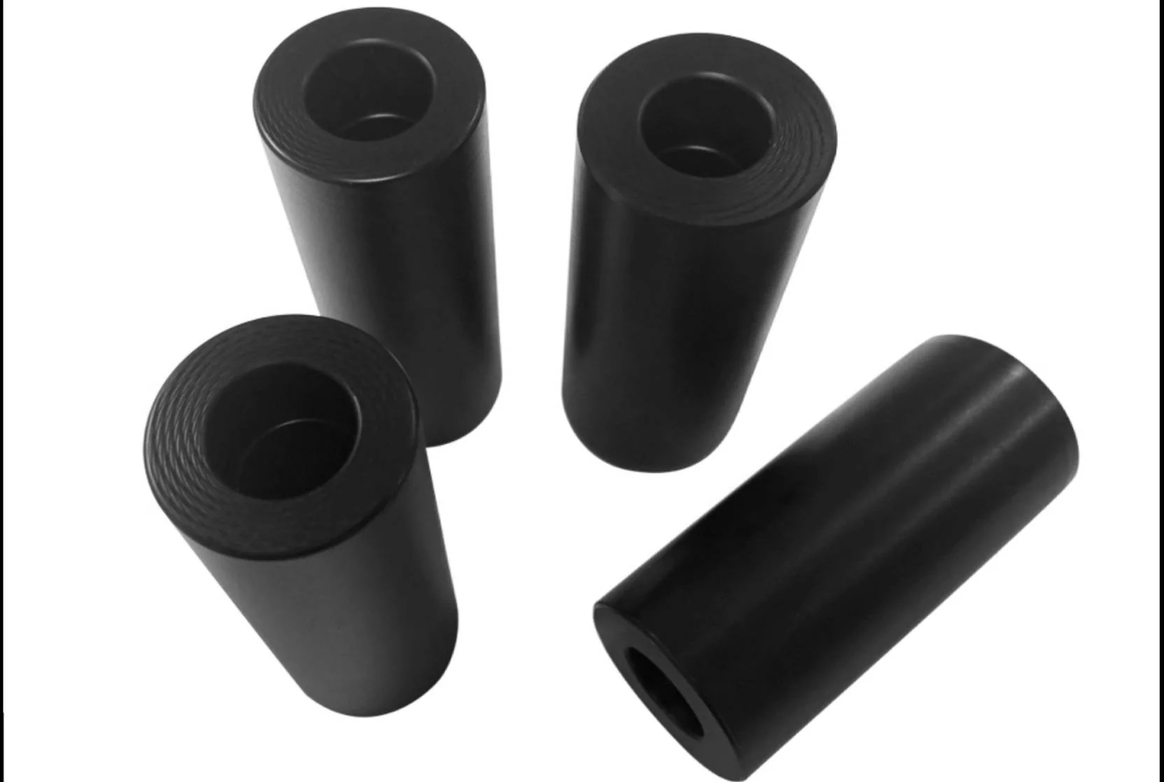

I am also wondering if at a certain thickness, spring spacers dont give the extra height. @SteedaTech . I have Steeda Spring Spacers, all three lol, 1/8, 1/4, and 3/8, which means it would raise 0.25 inches, 0.50 inches and 0.75 inches, respectively. The 3/8 didnt give me the full 0.75 inches short by about 0.25 inches. The others did raise properly. Not complaining about product of course, it's all good, and i have an aggressive wheel / tire set up, hence why I have all three spacers to play with. Do you all think the OEM stock shocks or anything else limited the 3/8 spacers from reaching a full raise of 0.75 inches? Appreciate any feed back.
