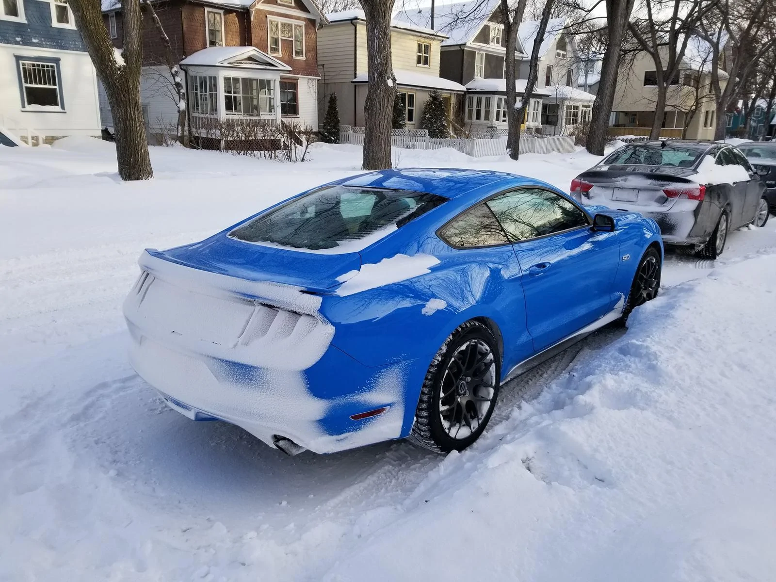

Would they stop snow/dust from accumulating on the ass? Thanks.

Negative. The entire rear end of the car is a huge low pressure zone, due to the shape. High pressure air comes off the roof, then the trunk lid, and diffuses behind the vehicle, getting sucked into the low pressure area. Unfortunately, there's really no way to stop it. My wife's C300 does the exact same thing.
