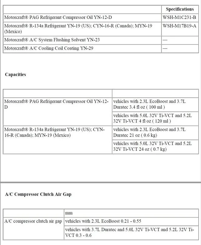

The one issue I am having is finding capacity levels. When I replace my compressor with a new one, with a new clutch and new belt, how much R134A do I need to use and how much compressor oil do I need to use when its all replaced? I have access to a garage with proper tools to do all of this. Any info or pointers in doing this is much appreciated.

Looks like 4 oz (says 4.1 oz in another section) of compressor oil and 24 oz of refrigerant. I agree with using high/low side pressures for refrigerant, but I would add oil per the spec if the system is dry and empty.
