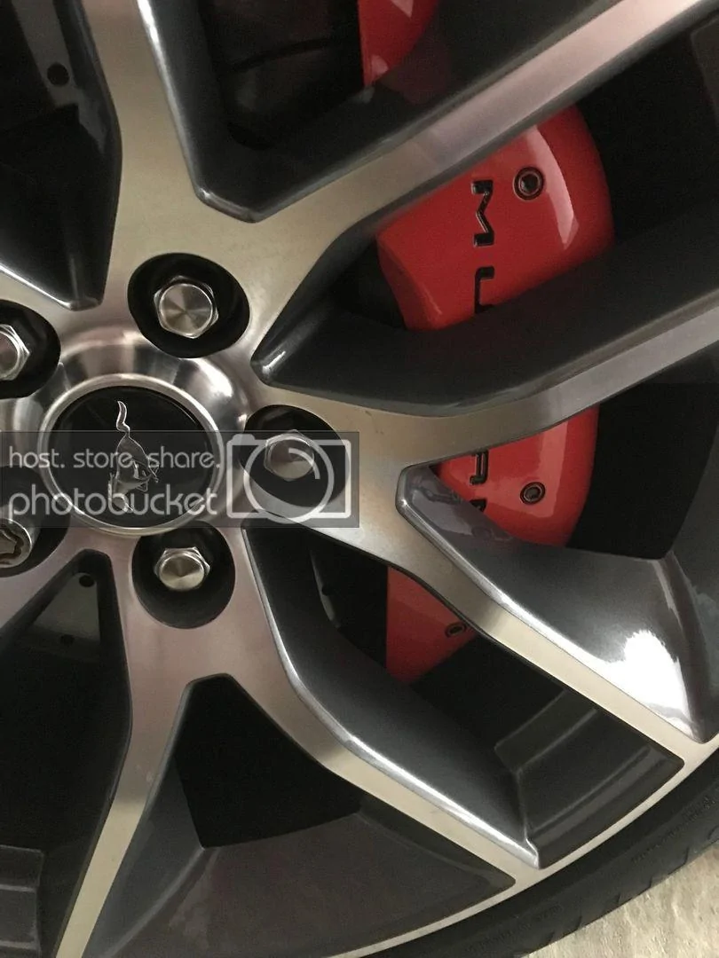

That's correct. I had to use 3mm spacers as well for my MGP's on the front to clear the factory 20" foundry wheels.

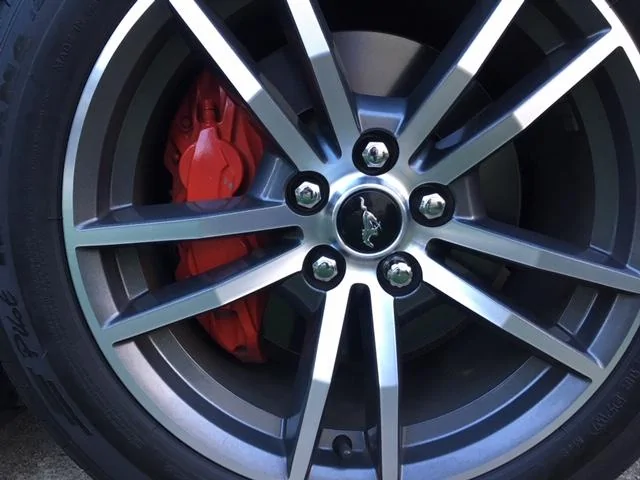

Not the best paint job with G2 but at 150 MPH......who can tell. :crackup:
Been almost 2 years now, but I do clean them when I wash the car.

Are you saying a Mustang ( '19 GT. stock 18" wheels) may need spacers?
Can't answer that for sure. I know I needed them for my factory 20" foundry wheels on my 15 GT. You're going to have to do a test fit to find out for sure. Take one of the front wheels off, install the MGP cover and put your wheel back on to see if it's going to have a clearance issue. If it does, then get the 3mm spacers or whatever spacers you want.
