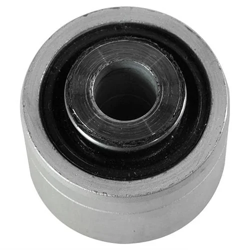

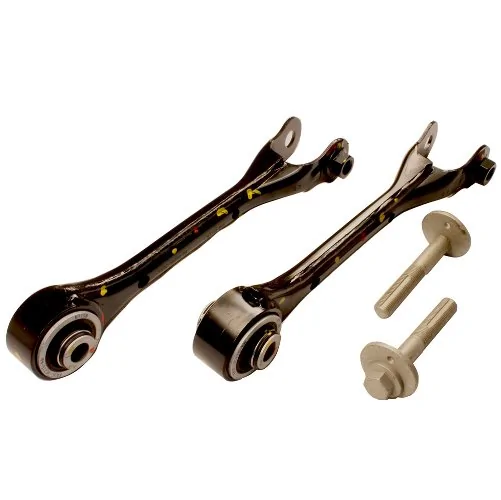

The PP has the rear toe links, but they don't have the Toe Link Knuckle Bushings. When I got my Ford Performance Track Kit installed I didn't install the Knuckle Bushings. I got those installed when I did the 4.09 gears as they have to drop the whole rearend assembly. I would do them, it made a bigger difference than I thought they would.
I assume you are talking about these.

Yes, those look like the parts. So, my 2022 Mustang GT non PP would just have whatever the base rear toe links and knuckle bushings are, and not the upgraded FPT ones? The older thread said that they would. That is where my confusion lies.
With all of the other BMR equipment I am installing, in your opinion, when I install the the FP Track shocks & struts would it be an injustice to not install the FP Track rear toe links and knuckle bushings parts? Would my base parts be good enough?

I would do it, you're already back there. Do it once, cry once.

As Dave said, install the bearings but I would just go with the J&M adjustable toe-links over the stock PP ones.
