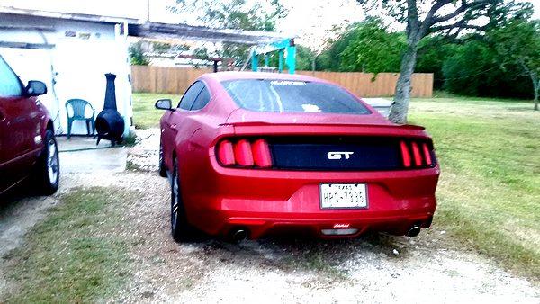

2016 5.0 Coyote Red
Spacers
PP2 wheels are nice. If you can't clear brembo's I'd try 8 mm or 5/16" spacer. I am currently using this for my pony to achieve a wider stance.
