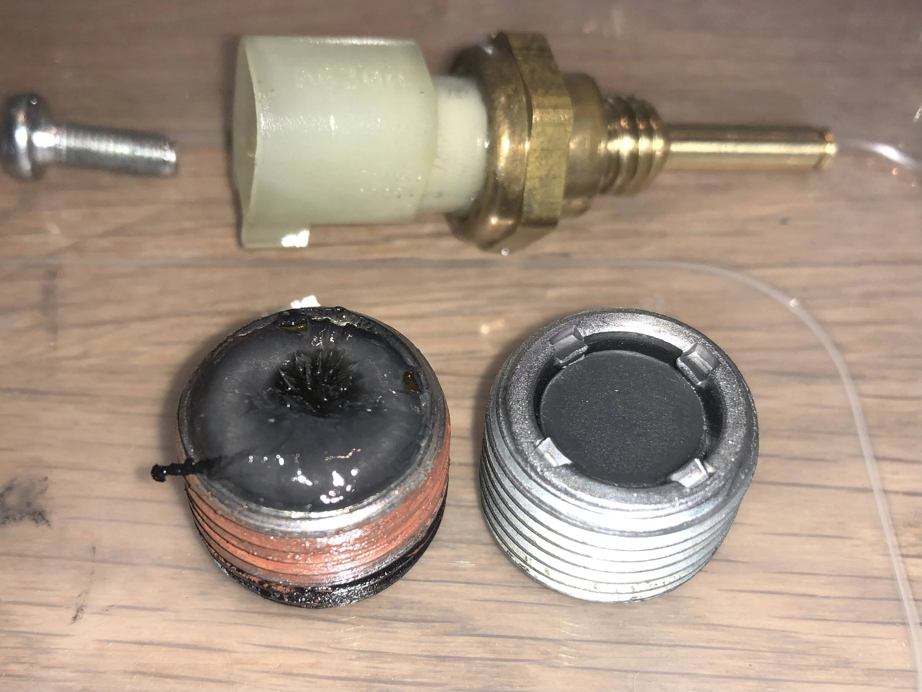

Ford renewed mine with the diff cover, backing up the one time usage.
The end on the old sensor has witness of where it has bottomed out and deformed a little where it has bitten into the cover - I wonder if it’s ability to bite in and deform is compromised with multiple usages ?
Sensor photo just for reference :
