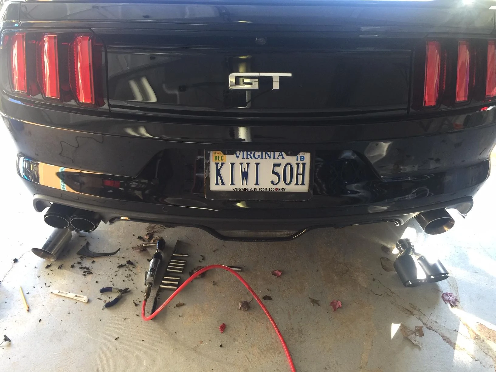

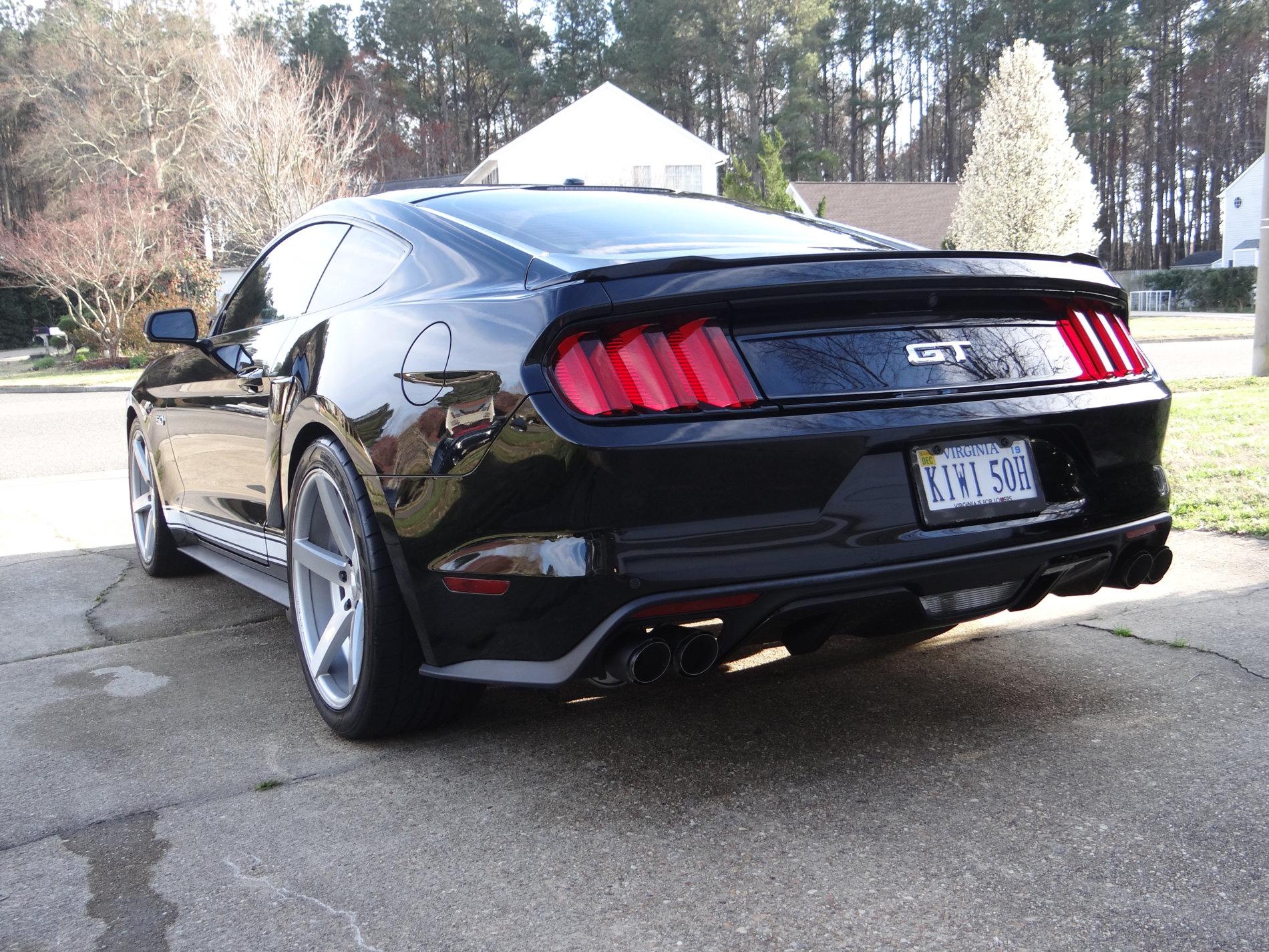

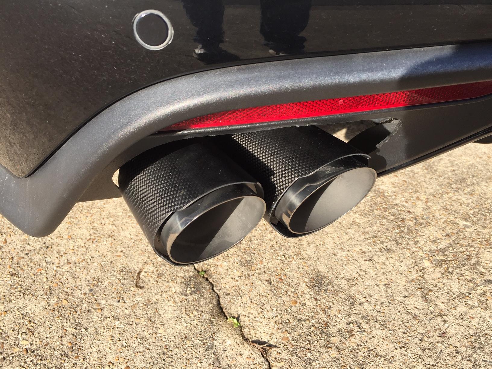

I added quad tips to my '16 and its easy to do when you've figured out the factors. In my case I found out the rear valance could be modified to accept a dual tip setup as long as it was in a 'Y' (symmetrical) configuration. Tips in a 'h' (asymmetrical) configuration would not work right unless the valance was changed to something different like the Roush with Corsa tips.
The other aspect was the exhaust being used too. I went with the SLP LM II because it had slip on tips that could easily be swapped out.
The tips I got from some vendor on Amazon. Knock off Akra tips but the price was right. They ended up being much nice quality than I was expecting for a set of knock offs too.
