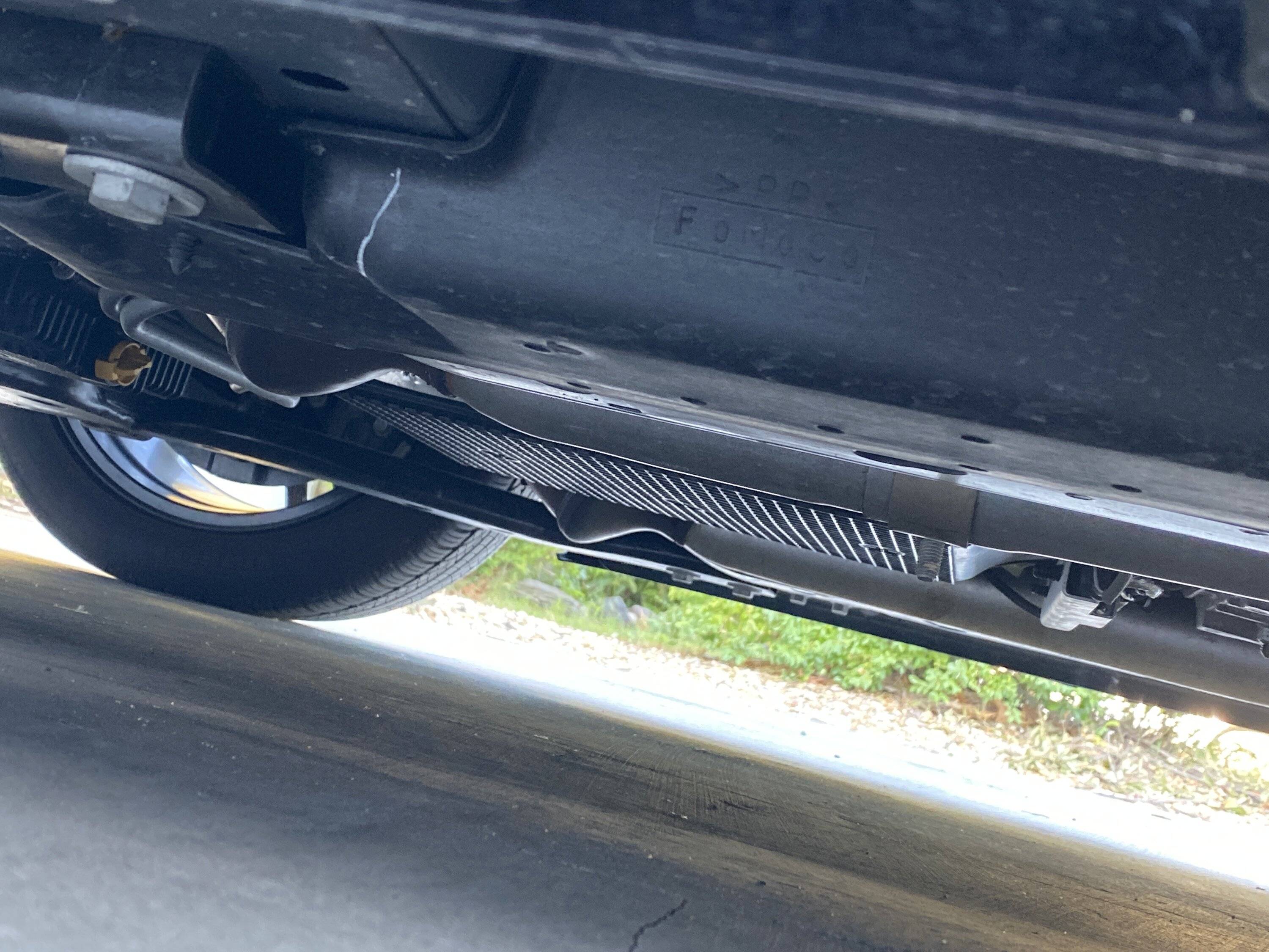

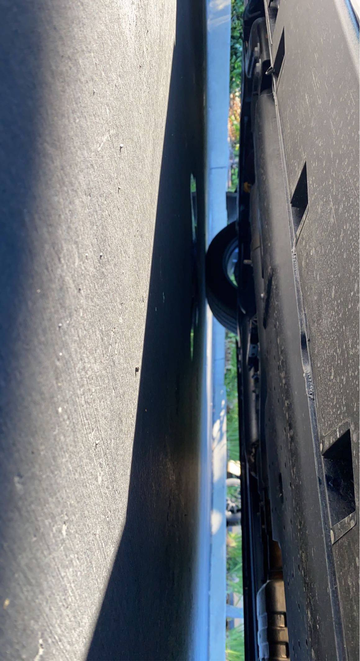

Usually in the morning & after work , I’d see a puddle in the ground underneath the car. I’m assuming it’s condensation. My car 2021 gt came with active exhaust . Anyone else have this issue ?. Thinking of taking it to the dealer this weekend. I attached pictures of the area where I think it drips from . The textured box area . No idea new too the s550

Are you running A/C or defroster? If so, it’s normal and is the condensation that drips from the HVAC drain.
Also look at the exhaust pipes themselves at the connections. If there is black soot on the exterior of the pipes under the car, it’s an exhaust leak and condensation can leak from the breach.

I noticed this on my 19gt with active exhaust (if that has anything to do with it) during the colder months. I determined from the location is was condensation from the exhaust. Specifically the suitcase resonator area. The condensate was also leaving behind a carbon residue which first clued me into the exhaust.

I’m pretty sure it’s condensation, it appears only once my cold start is over with , the ac turns on during remote start . So I think I’m good

Just reach under there, grab some of it on your fingers. Then touch, smell etc. find out if it’s either AC condensation build up or a fluid/lubricant before you panic.
