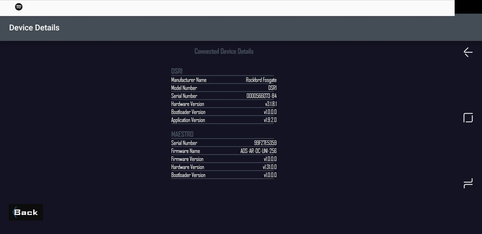

I am having the damndest time trying to get an almost identical setup configured. The perfecttune app thinks I am in universal mode even though I have selected the af03 from the maestra setup site and also in the vehicle configuration. Can you post a screenshot of your dsr1 connection details? This is what mine is showing...
Thanks,
Chuck
