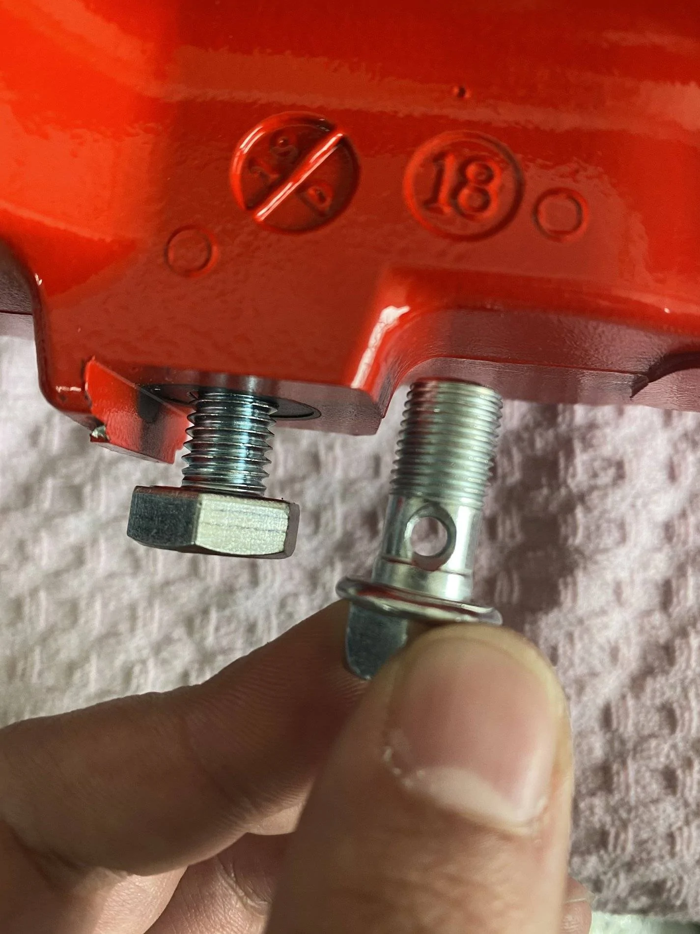

I am 99% sure that every 2015+ Mustang Model including the Shelby uses the same banjo bolt. M10X1.5. The thread is the same front or rear. The Goodridge product had been on the market since the S550 launched and like other kits on the market fits all 2015+ Mustang EcoBoost, V6 and GT's.
I do not understand the different thread for different models. We have not seen it...yet :)

I know this thread is old but I just got the hoses for my PP brakes and they sent me the wrong thread. Where can I find the correct ones?
