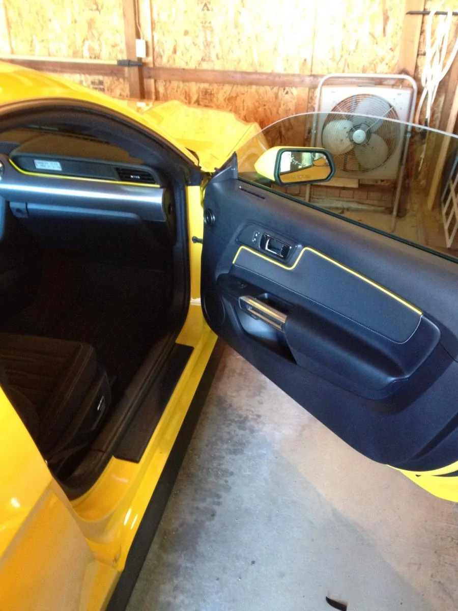

Update:

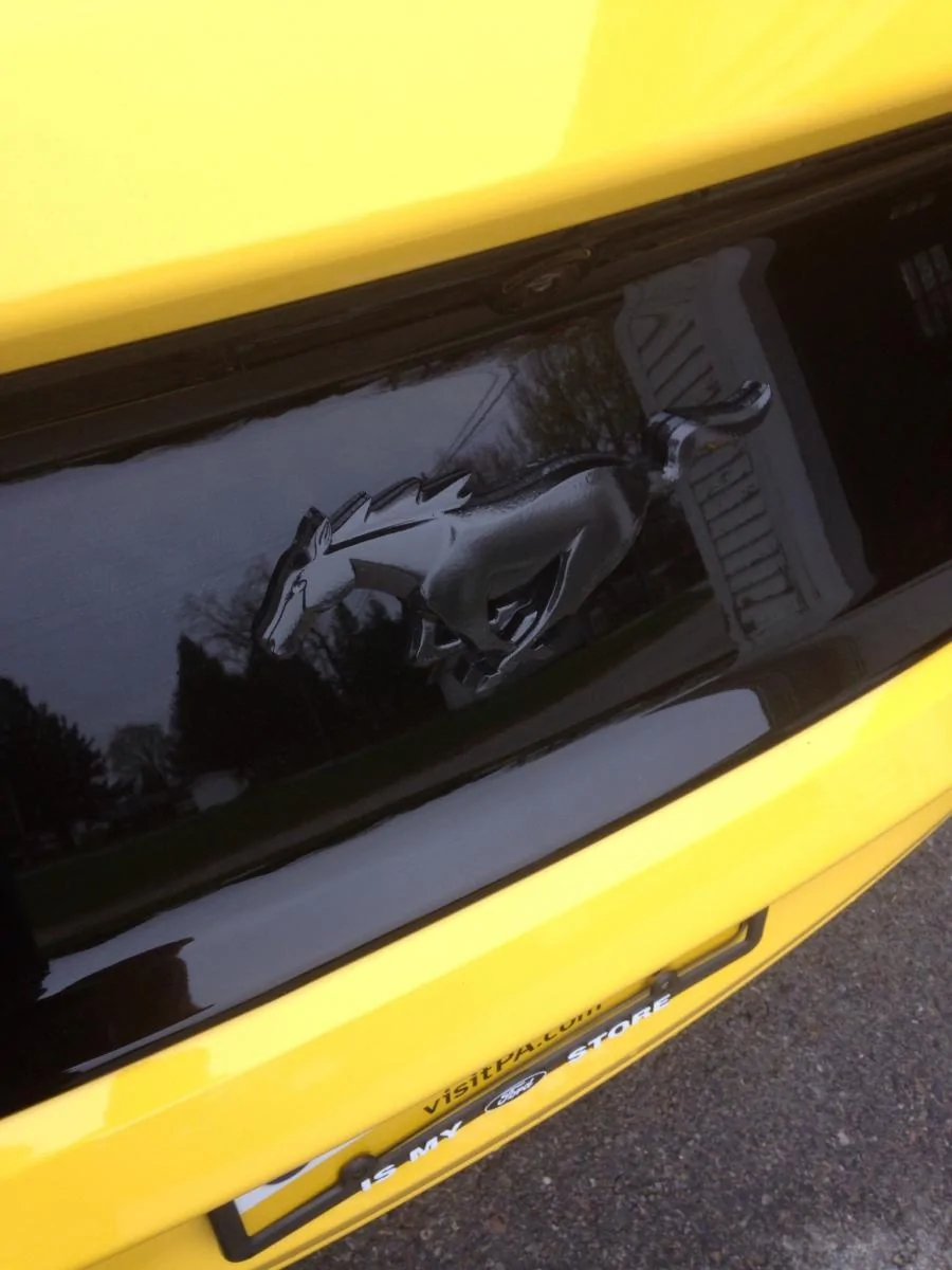

Black and Glossifier Dipped Emblems
LED Glow million color interior illumination kit
Yellow Trim Welt Interior
Just want to update my page with some pics. If anyone has questions about anything I've done so far let me know. I think I have the basic stuff out of the way and now that the weather is finally warmer I can start on some performance related upgrades. Mishimoto CAI is at the top of my list. Boomba BOV Adaptor will be installed tomorrow.

Yellow Trim Welt

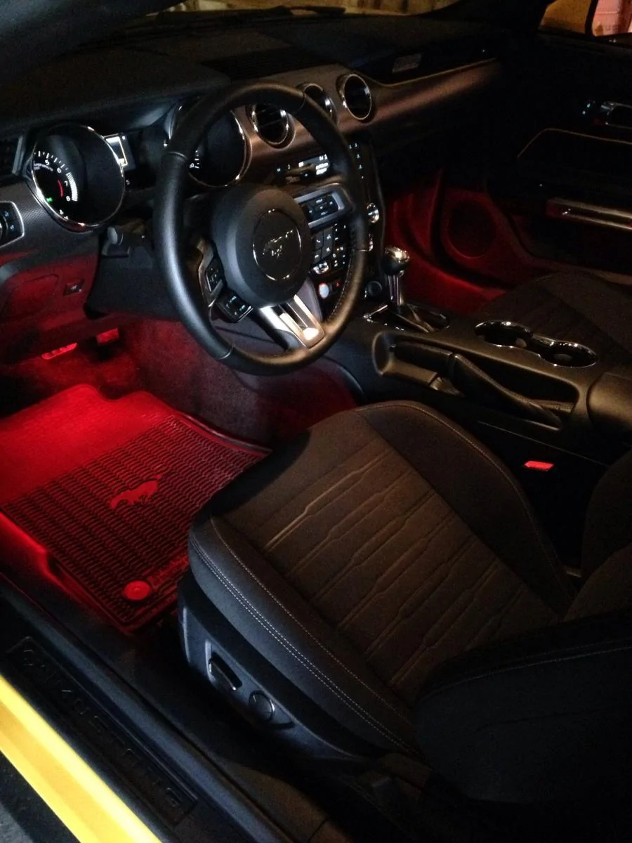

LED Glow

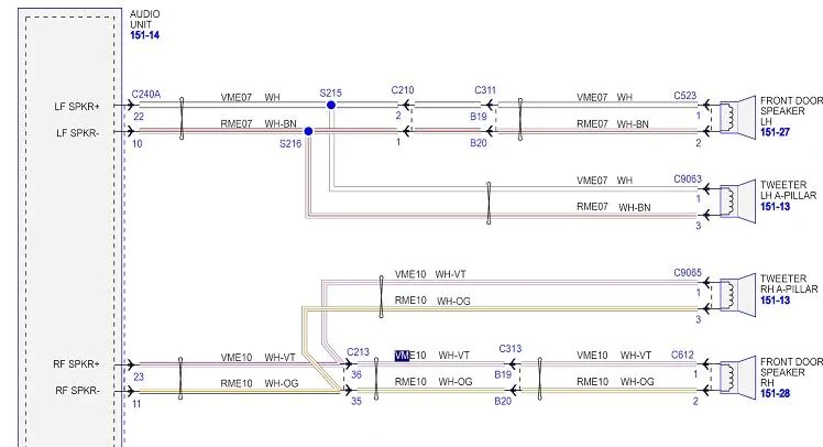

I used this diagram as reference. I think it is the front speakers diagram since the tweeters are routed from these wires. But On my phone calls I don't hear the sub working, but I am good like that. Sub works just great!
Thanks man!

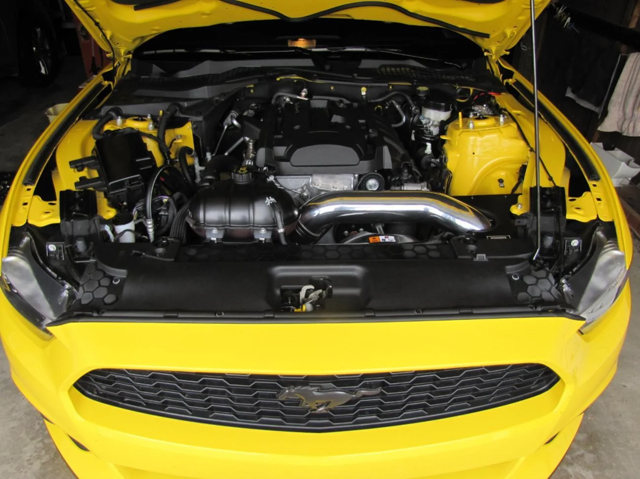

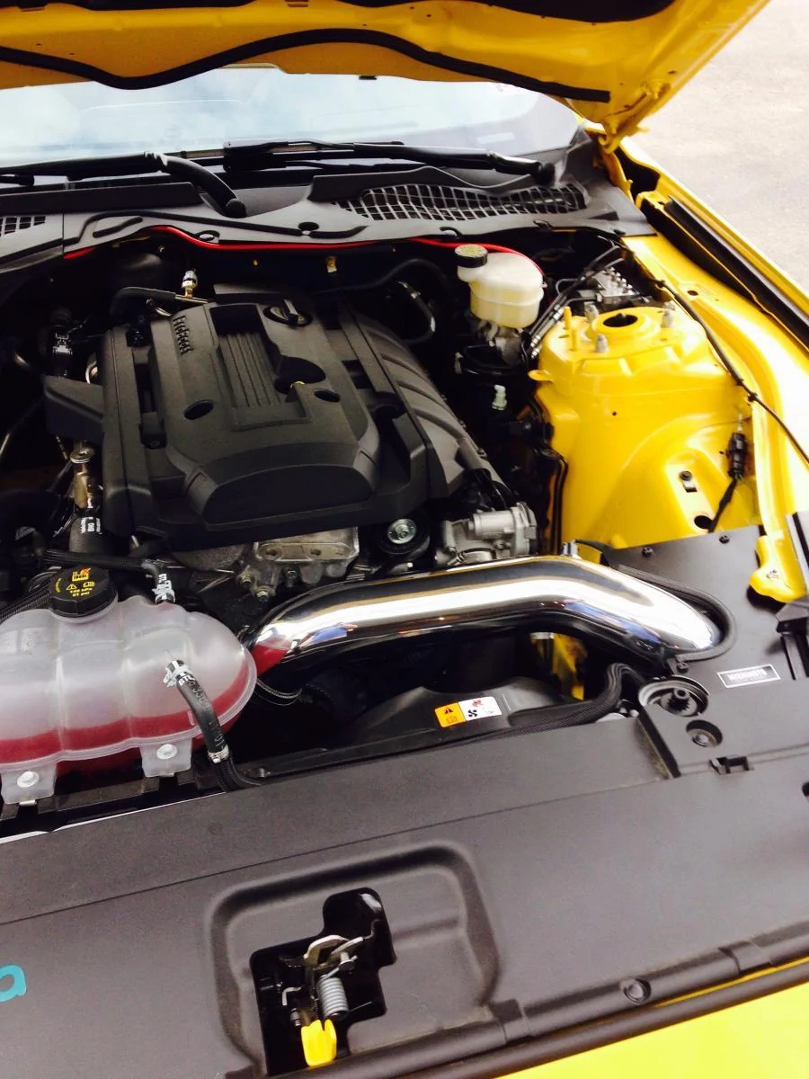

Just installed the Mishimoto Performance Intake. Love it! Easy to install and really adds quite a bit to the sound of the vehicle. It feels likel the car breathes a lot easier now and you can definitely hear it. I think it looks amazing too.
