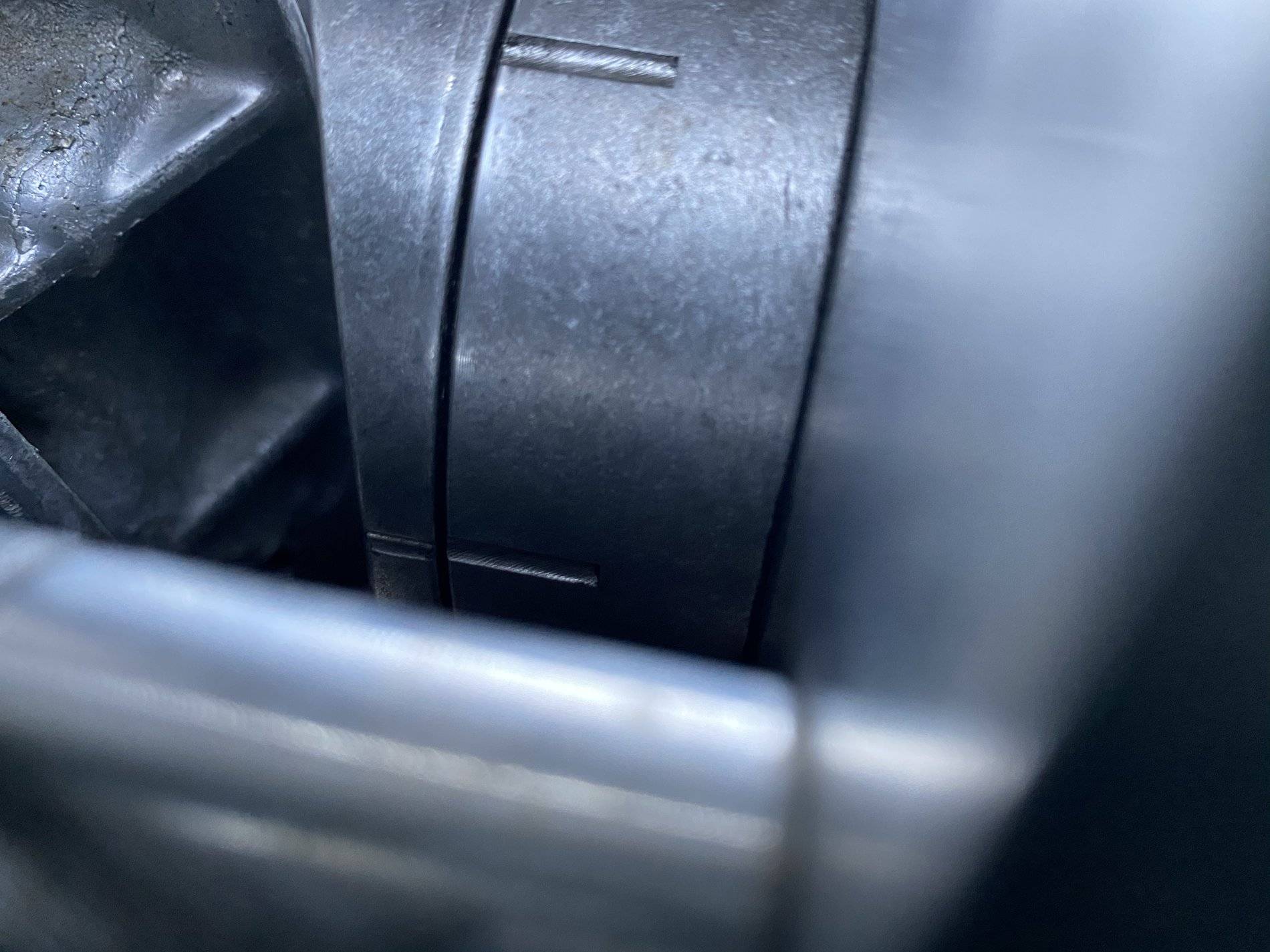

So my buddies car is a little different, a stage 2 the tensioner looks loose to me, it is a P1X but mine has 3 lines it has to be in between these two lines preferably around the center which is 40-60% tightened correct? So this is loose on this procharger.

Hard to determine belt tension by the pic. Refer to install manual to properly set tension.

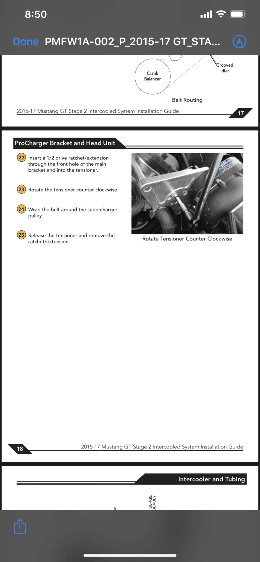

manual just states how to install the belt and release the tensioner once in.

Oh well that makes sense, because i turned the tensioner with the 1/2in extension and all it does is remove the tension from the bracket (works as a bolt) so it's useless. I can't stick the smaller wrench either on the opposite end because the valve cover is In the way. Procharger in other posts have said their shouldn't be any adjustments on this one, that it works straight out of the box

I have the old style tensioner as well. I’m curious to see if this one work any better, it certainly looks easier to use.
