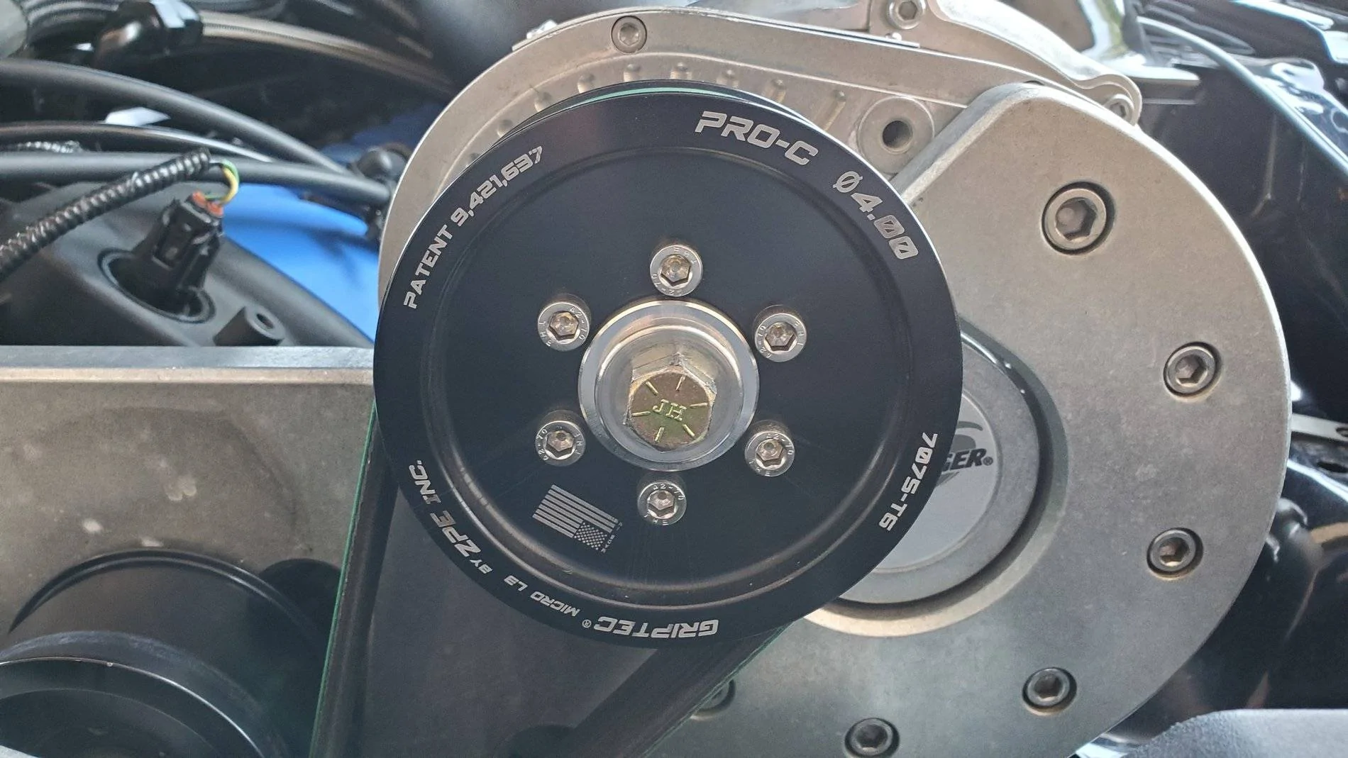

And if you want to make subsequent pulley installs even easier, you can get a griptec pulley. Its a 2 piece design so to swap pulleys you just remove the 6 allen bolts that attach it to the hub. Only downside is the price compared to a standard procharger pulley.

Why pay more and deal with 6 bolts over one? Stage 2 procharger does not have any belt slip issues, so grip surface isnt needed.

I mainly got it for the bling factor. I know that procharger stage 2 setups dont really benefit from using a griptec pulley compared to the other manufacturers.
