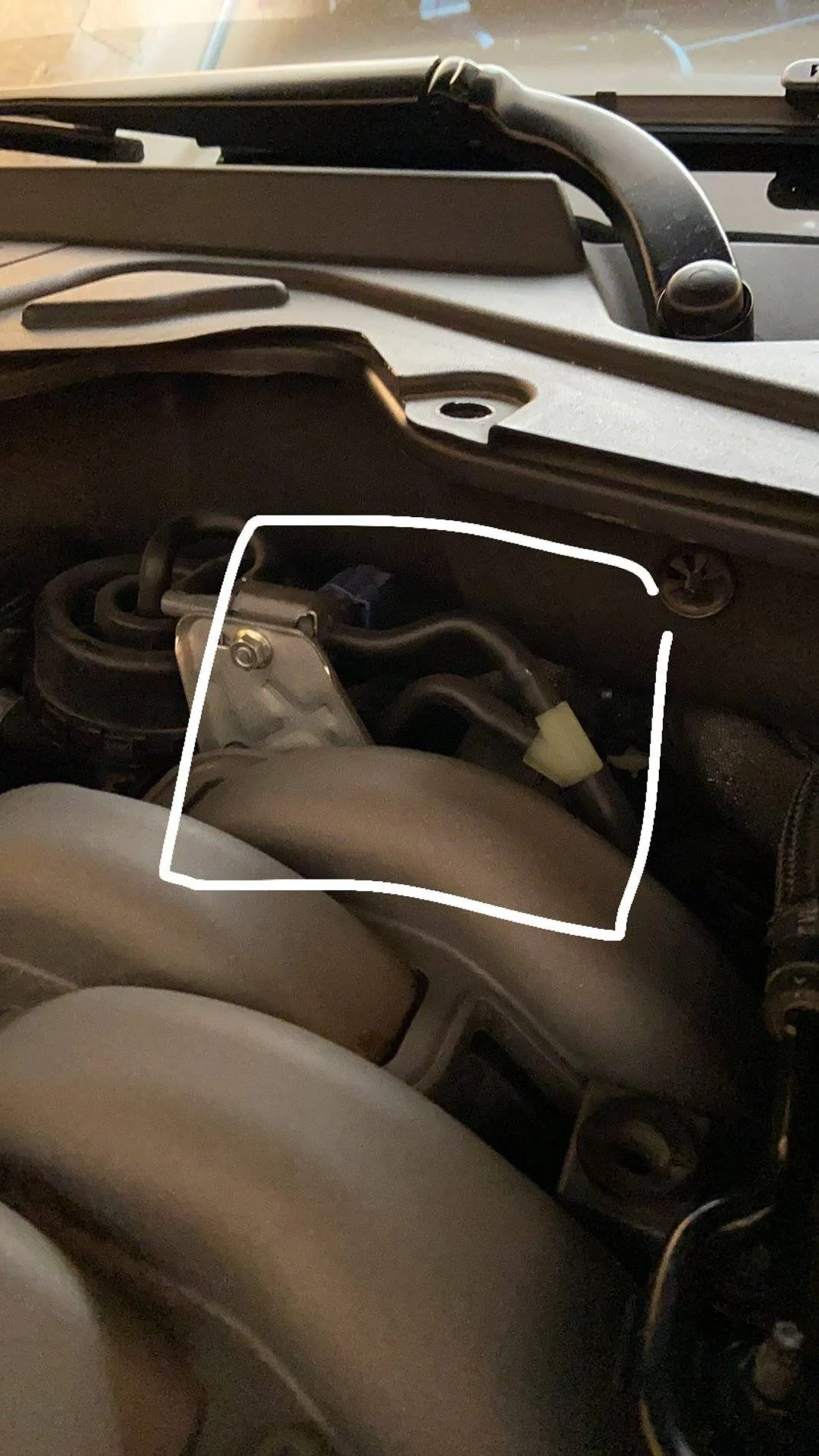

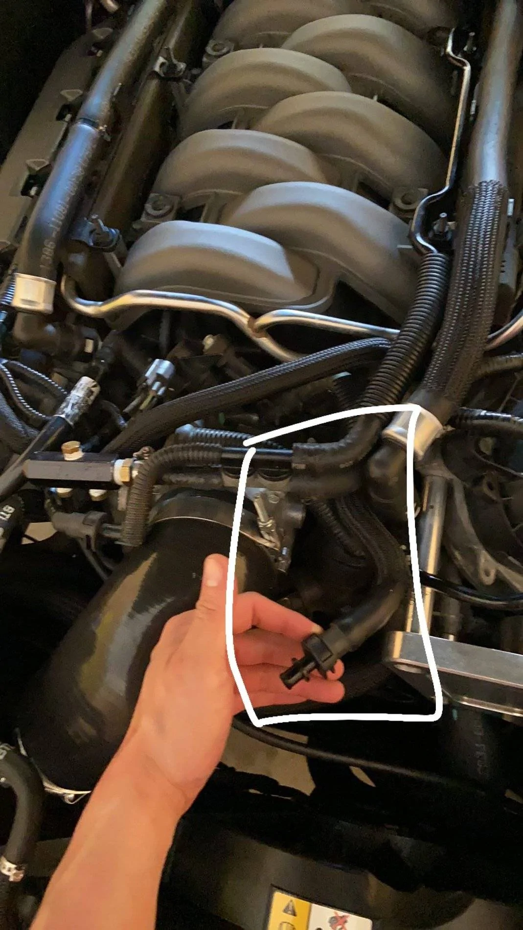

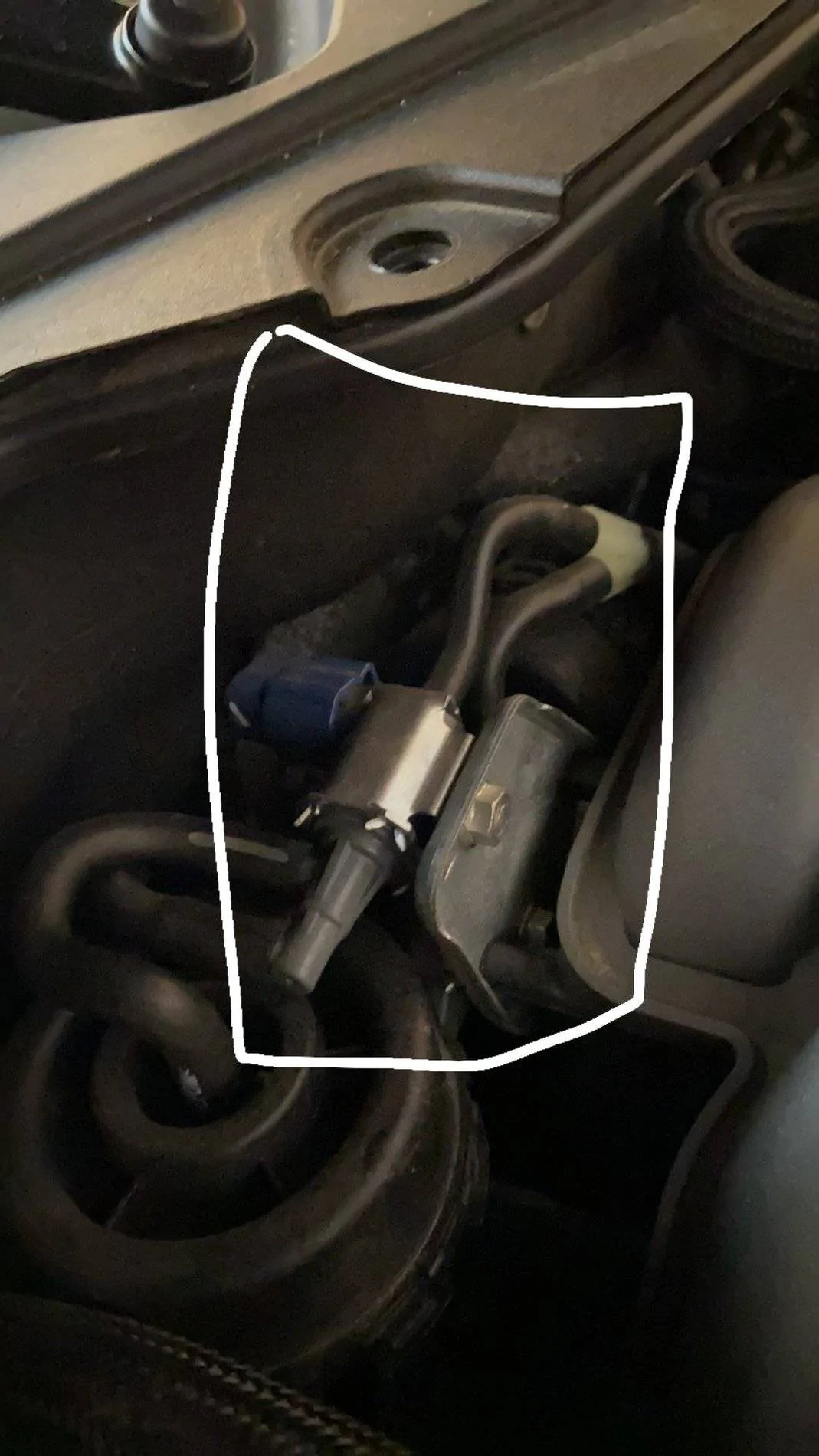

What did you guys do with this hose that’s running from firewall underneath the intake manifold?

I don’t see that on mine, is yours a 15-17?

Deleted IMRC on my car.
What did you unhook it from and why did you need to?
Airborne
Airborne
Apr 3, 2018
NC
2017 Shadow Black GT Premium
It was hooked to my old intake. Removed it because I have a procharger on it now

Still running my imrc, but I’m debating on whether I should get rid of them or not. Oh and I’m not sure what the hose is on the ops car. Mine is a 19

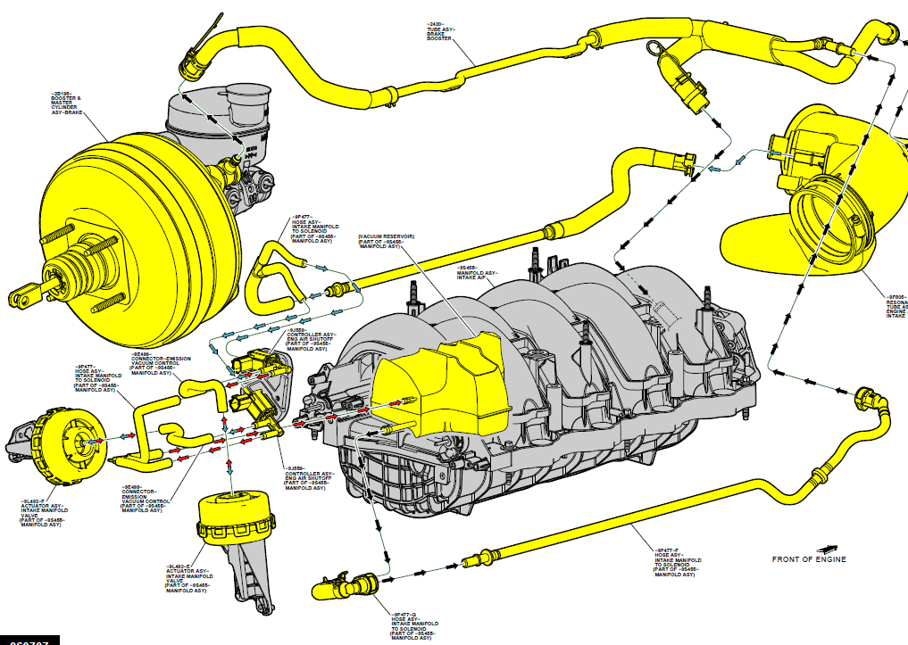

That is the vent line for the IMRCs. When the IMRCs are under vacuum the diaphragm in them move back and forth, need a place for that trapped air to go otherwise they would always be actuated. I removed the line from the Y and left the Y open to atmosphere.

+1 you can just vent it to atmosphere.
Some cars (mine included) come with IMRCs with black caps in place of the vac lines that vent to atmosphere from the factory.
