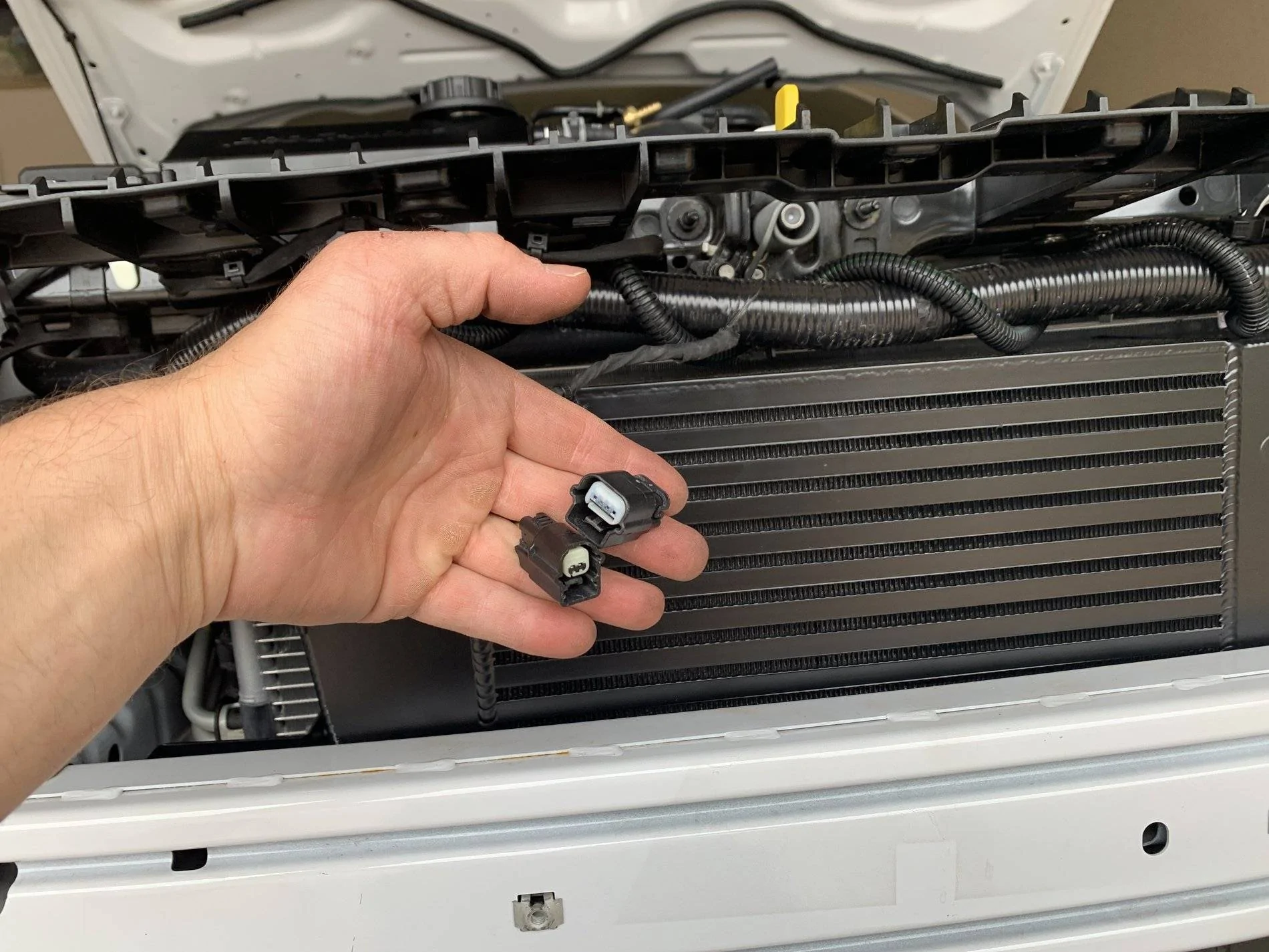

I can’t remember where these two connectors go that are on the wiring harness that runs along the front bumper. Any ideas?

I think one of them is the Airbag sensor if I recall correctly.

It plugs into the airbag sensor, I had to relocate mine, so that smaller plug looks familiar. Should be near the driver side headlight to the left.

My car doesn't have shutters, so I'm not sure.

Is one the air temp sensor?

crash sensor and hood latch ?

Finally figured it out. The larger plug is for the shutters. The smaller plug is the ambient air sensor. Thanks guys!
