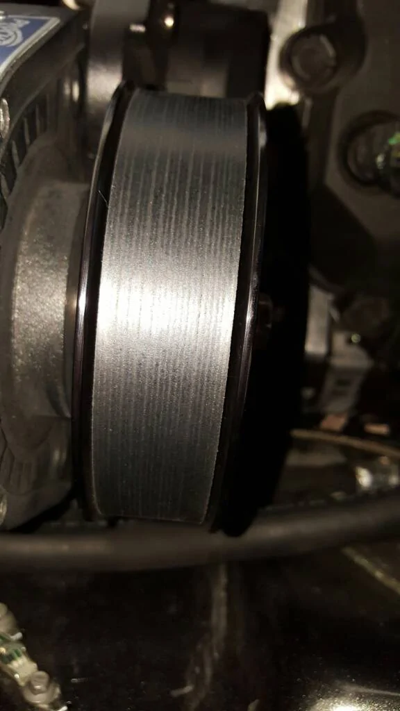

I installed an 8-rib I had here that was a half inch shorter. It tensions properly and had more room for tightening it up later. Doesn't have much deflection, maybe a quarter inch at the longest run or a tad more. Can't turn it 90 degrees anywhere along the run. Those were the two things Procharger told me to check for. I don't want it overly tight because I'm sure that will cause it to fail also.
I ran it for 5 minutes and stopped it and took this picture. I'm wondering if this is too tight? I can see the striations in the belt smooth side already. This might be normal.
PC feel free to chime in, too.

ProChargerTECH
Oct 23, 2014
105
2,408
1,297
Boostville
2015 Mustang(s)
Sounds like the first belt was far to loose, got hot and snapped.
But without more details little lost.
The image you have now show, I see no issues.
Make sure everything is lined up with the balancer.
Nobody has had a belt issue so far, or alignment, so it would be odd.
Follow the proper tensioning steps, make it tight, and all will be well.

Thanks - yeah the 68.5" belt worked great on my 5" pulley and made between 10-12 psi at redline (depending on the measurement instrument) consistently without slip or issue. I dropped to the 4.63 and I was surprised that I had enough room on the tensioner to adjust that same belt to the smaller pulley, I had a smaller belt for the install and ended up not needing it.
It turns out it was at a hair shy of it's maximum adjustment, and was slipping very quietly at high rpm with that belt. I didn't realize the light dust in that area was from the belt. That explains the boost needle fluctuation at about 10psi up on the smaller pulley.
I installed a half inch shorter belt I had so it's a 68", and I adjusted it to how tight I believed it needed to be, stepped on it in 2nd, about 9psi it started squealing. Tightened it a turn, repeat, same thing. Tightened it up a turn, max adjustment. Stepped on it in 2nd, same thing. So I am babying it until my total of 5 new size belts get here. I have ordered 3 green stripe belts in incrementally smaller sizing and a couple of Bandos as well.
I will say this - the Bando was slipping pretty sneaky like. I think when the belt began to stretch over a little bit of time that's what got me.
So like you said - too loose and got too hot - makes perfect sense.
Some people are saying crank these belts down, but I remember you guys saying no more than a 90 degree twist on the belt on the longest run or more than 1/2 inch in that same area up or down on the belt.
What's the right way to know? I'm assuming if the belt ends up squealing, it probably glazes it or weakens it the first time, making it less tractable. Am I wrong?
