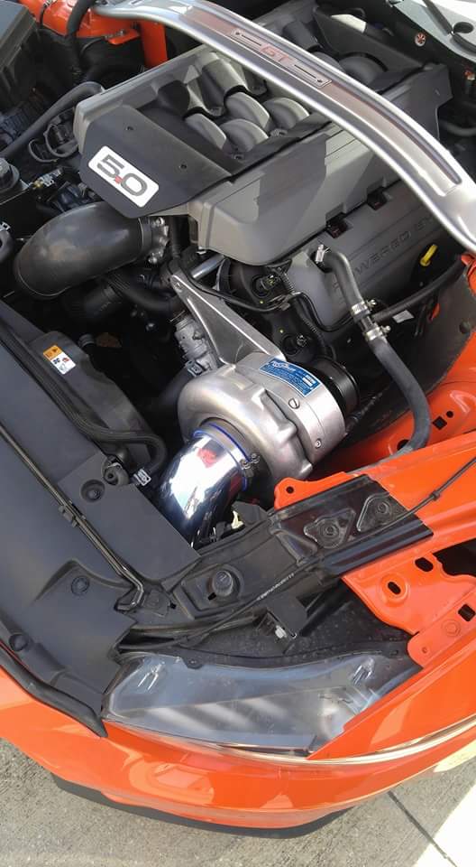

ProCharger ate it's intake elbow

Mine did the same thing. We called procharger and they told me you not supposed to run that intake they sent with the kit on the F1A Procharger. Pissed me off.

Wrong air filter?
How are yall pulling so much vaccum to fold these?
Does this setup need like 3X more air filter surface area?
That much pressure drop across filter sounds like filter is a bottle neck.

I understand what you are saying but the initial hose sent in the kit was thin and would fatigue in that spot.

After the nightmare or buying the kit used and Process not sending me all the parts, now the head unit ate the intake and bent the compressor fins. Was out doing a log for Lund and was at WOT around 7k and the car bucked real hard and I let off. I also head a breif squel. God I hope the engine is ok. I'm crossing my fingers that the rubber came off in large enough pieces to get caught in the intercooler and not make it to the engine. FML :mad:
Hate to break it to you...
That is NOT our elbow... (not the old one, nor the new one)
Looks like something whoever sold you the kit, included a "custom" part.
Id suggest contacting the seller.

Well this just got interesting. OP so sorry for the damage caused by this. good luck sorting it out

Yeah that is 100% not a procharger elbow, new or old. I have both setting in front of me.
