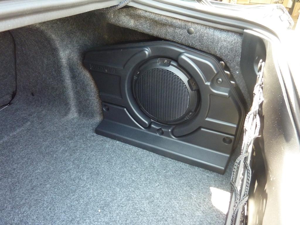

I have installed the OEM sub in my base Mustang GT.
Should be a similar setup for the Premium setup with sub.
Would you guys like the info I've learned from this setup? I'll try to explain the best I can because I had a pro shop do the install.

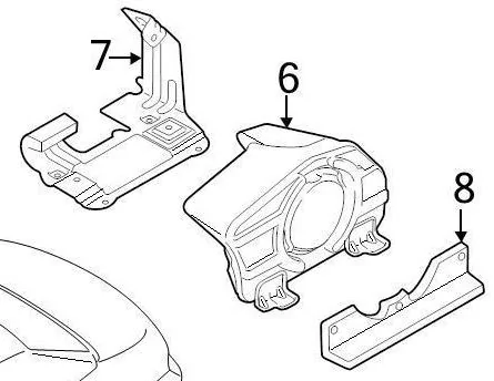

You will need to purchase these parts. There are several. Purchased at our vendor here on the board.
[ 6 ] BODY HARDWARE / INSTRUMENT PANEL / SOUND SYSTEM / Woofer
Part Number: FR3Z18808A
woofer SPEAKERS-COUPE, w/branded audio
MSRP Core ? Online Price
$281.06 $0.00 $216.41
[ 7 ] BODY HARDWARE / INSTRUMENT PANEL / SOUND SYSTEM / Woofer bracket
Part Number: FR3Z18807A
5 bracket bolts
1 U-Nut (speed nut)
woofer bracket SPEAKERS-COUPE
$103.47 $0.00 $79.67
[ 8 ] BODY HARDWARE / INSTRUMENT PANEL / SOUND SYSTEM / Woofer cover
Part Number: FR3Z18B947A
3 T-20 Torx screws
2 13mm bolts
1 T-40 Tork screw
woofer cover SPEAKERS-COUPE
$30.04 $0.00 $23.13
White Bear Lake Ford
Talked to Mike R.
651-484-8888
$318.21
$338.29 total + shipping
approx $20 in screws
approx $15 shipping
Total= 353.29
You will also need the replace the stock subwoofer amp. Use the ALPINE KTP-190U. About $100. It is nearly identical to the stock amp. It will bolt in place of the stock amp. You will need to remove the subwoofer driver to install the wiring. Since the Alpine amp only has 2 wire for the subwoofer you will need to wire the subwoofer in series (?), I think that's the terminology used. The subwoofer needs 4 wires connecting to it and the Alpine amp only has 2 wires for connection.
The Alpine amp was connected to the rear speakers for the signal and the power wire just simply went to the open subwoofer fuse in the passenger kick-panel. Cross-over the amp at 100Hz
The result is more bass mainly at high volume. This will not blow out the windows or rock the boat. It is intended to give you more bass at higher volume is the best way I can describe it.
I also used the instructions from the JL Audio site for their own subwoofer f or this model car. They are pretty good.
I think total cost was about $500-$600 with the Pro install. I know people with just assume just go with the JL Audio setup (and I agree it's a much better power setup) but when you talk about the outlay in cash this is the most feasible now. The JL Audio setup in $800 for the enclosure and then $300 for the amp and then $200-$400 for install? You are close to $1500 at this point.
Please ask questions if you need to. :cheers:
