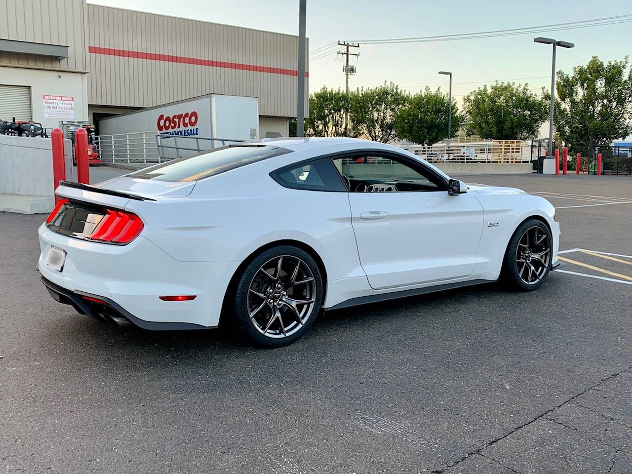

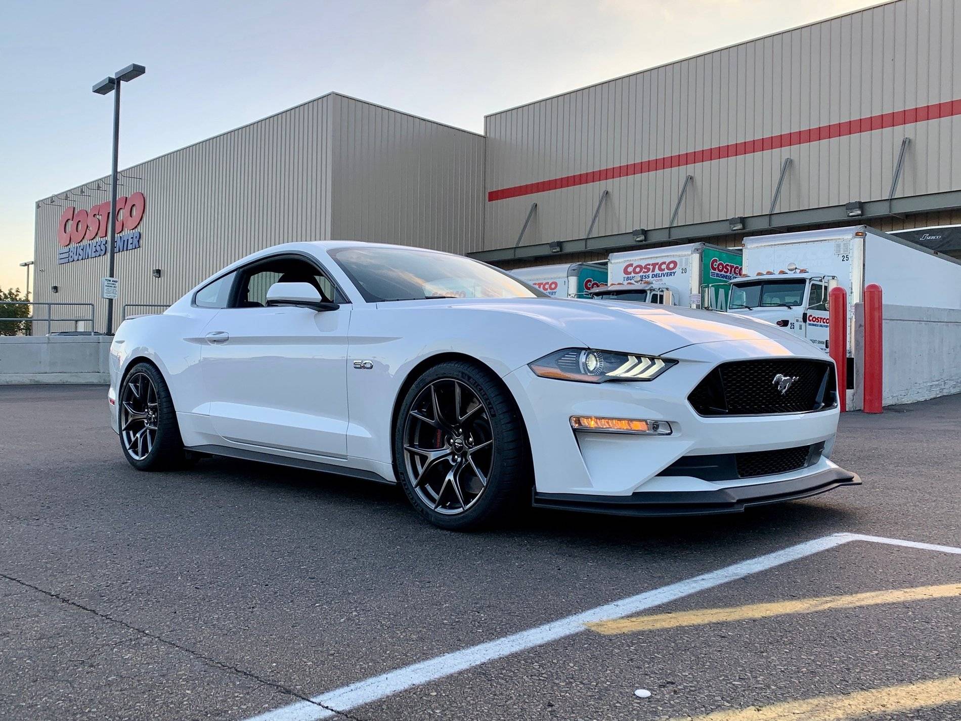

What are you lowered on?
Short answer: Steeda Sport springs part # 555-8242.
Long answer:
The PP2 has more wheel gap in the rear than the front from the factory and I didn't like that look. I'm OCD and like things even. This isn't an issue on other Mustangs because they all have rear tires with thicker sidewalls than the front. Aftermarket springs maintain that rake since they are made for those cars (PP1, GT350 etc).
I was not interested in putting a thicker rear tire. That would have a negative impact on the effective final drive ratio and the car already has tall gears. I also didn't care to lug extra weight around.
To compound the issue I wanted to add a bit of negative camber up front and the more camber you add the lower it looks.
Anyways, my setup is:
* Steeda sport springs 555-8242 (trimmed rear bump stop as per instructions)
* Steeda rear subframe alignment kit 555-4438.
* Deleted lower rear spring pads. This helped drop the rear by ~5mm.
* Spiral wrap to isolate the lower rear coils. It's completely quiet, not a peep or a squeak.
* Ford Performance camber plates M-3050-A. These have none of the harshness typical of full metal aftermarket units.
* All bushings loosened and torqued at ride height w/full tank to eliminate preload.
* '19 GT350R "track" alignment. -2 1/4 front, -1 3/4 rear, smidge of toe in. (It's really not that aggressive).
* Michelin PS4S 295/30 front 305/30 rear. Same weight but 0.7" wider front and 1.2" wider rear than cup 2. I wanted to maintain a stagger like the wheels.
Prob not the answer you were expecting but the car drives like a dream AND looks nice and even! Hope this helps.
