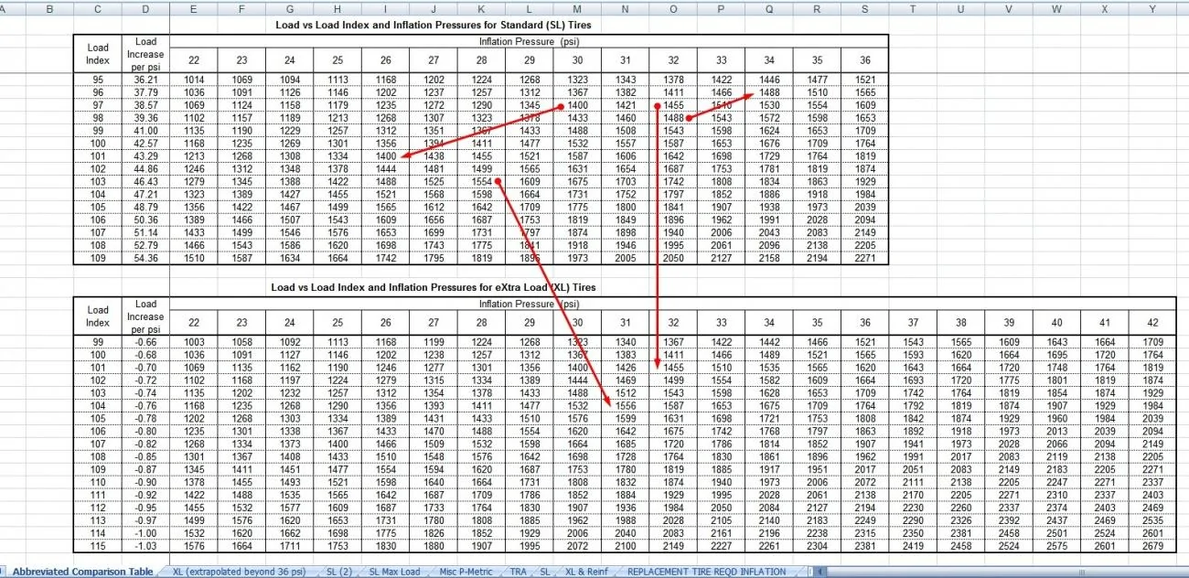

Be careful with Load Index comparisons, because there's more than one Load Index table, and they don't "line up" with each other.
IOW, a Load Index 97 in SL (Standard Load) compares to Load Index 101 in XL for rated load at the same inflation psi up to 36 psi. Not 97 SL ==> 97 XL like you might first think. It's only for inflation pressures beyond 36 that the 101 XL picks up any more rated load.
Working with the tables, you can adjust inflation pressures over a small range to at least match your car's rated load at the placard psi number(s). I do have the SL and XL tables (and a spreadsheet that takes the grunt-work out the lookups).
That's for rated load purposes, which you can take as a starting point for any psi tuning for handling, same as you would with the OE tires and OE inflation pressures.

Is there anyway you could throw your tables together in a google docs spreadsheet and post it for us to download and use?
I'm afraid this is the best I can do without having to spend a ton of time trying to convert a multi-sheet workbook down to a format I have zero experience with (and no idea how to protect against inadvertent changes).
But it ought to cover most cases anybody here is likely to come across. Red arrows show the new pressures required going from some original size and inflation. It's available in my "Tech Stuff" album here at M6G, if it's possible for people to see other peoples' albums.
Note that I have not included any Light Load (LL) information, and I know that some years and models of Mustangs have used LL tires as OE (IIRC the later years of GT500 with Goodyear Supercar G:2 tires was one such case). I've been given the impression that there may not be the kind of uniformity with LL as there is with SL and XL. Nothing is simple here.
Norm
