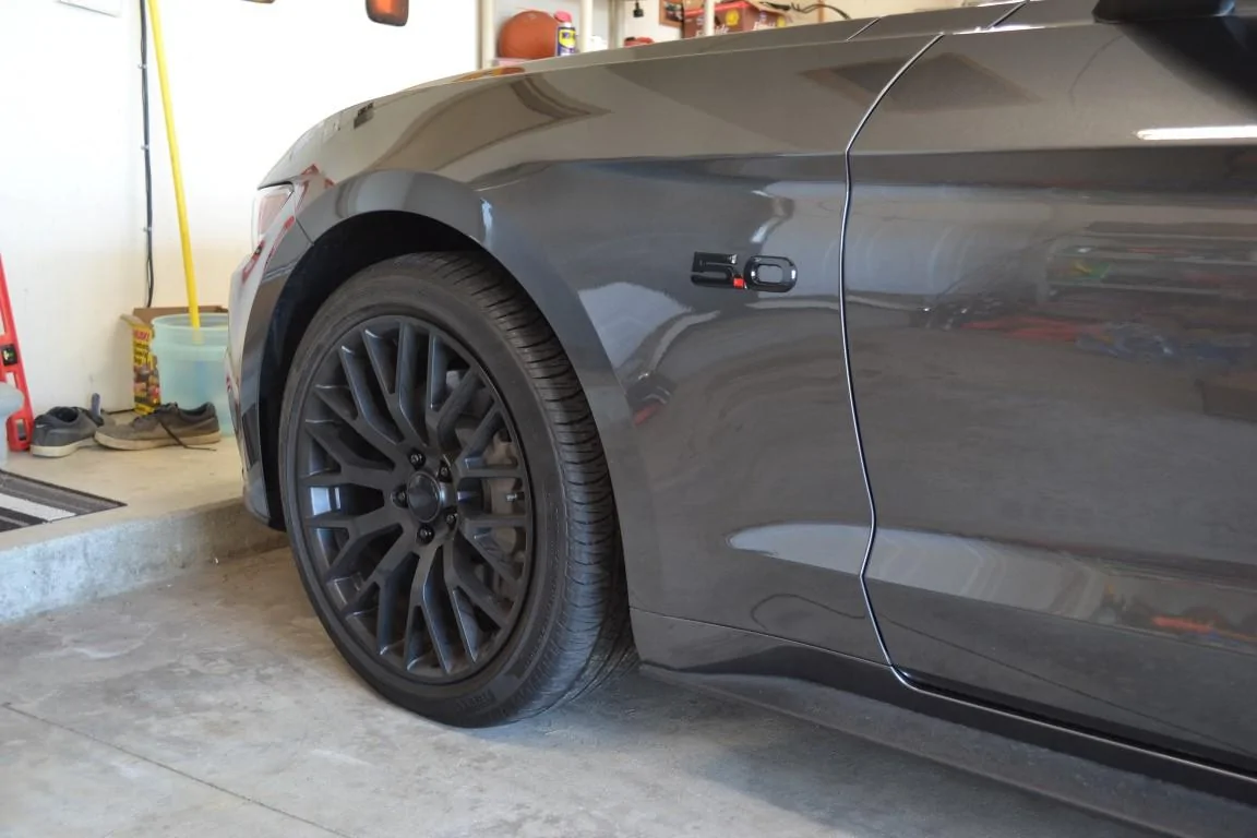

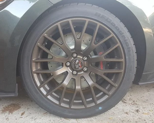

I have been eyeing these on AM for a while now, been wanting to see if anyone here has run them and how OEM they look.
I've bought from OEWheels before for my C5 and FBody, if they are the same wheels that AM uses I'll be grabbing a set.
Can anyone post pics of the replica PP wheels

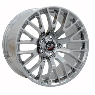

The bronze is what we did, scuff and spray because track wheels that get beaten up. Murphy's law working overtime because we started with the matte black ones pictured and just wanted a unique color change so of course the finish was perfect....
I don't know what the non GT PP struts have for clearance. The 19X10 PP Rep's do sit out further than the stock 9" GT PP wheels.

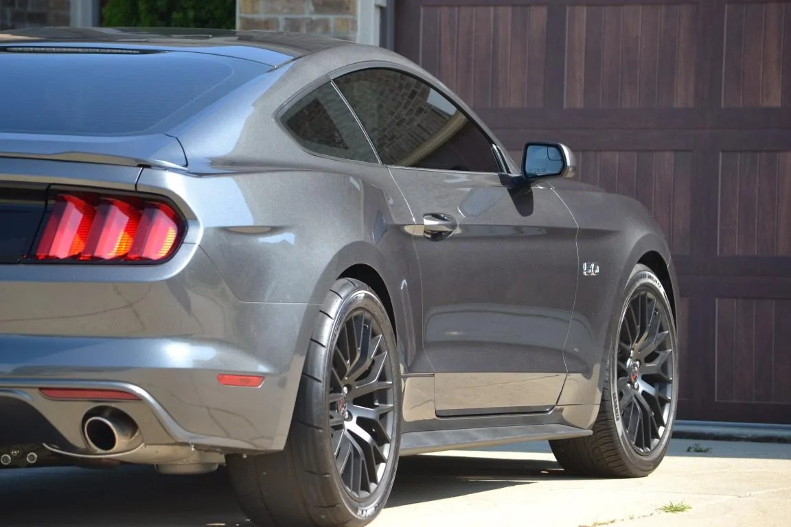

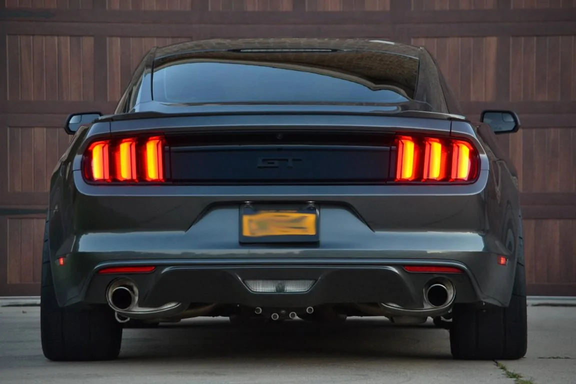

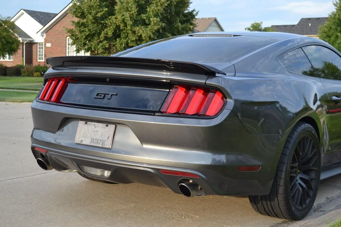

Are the replicas on OEwheels the same as the replicas on AM? The OEwheels look like the spokes are fatter. Is at just the photo?
$452 for a staggered set is crazy.
The OEwheels are in a Satin Black finish and do not match the PP Gloss wheels. I have a set of the staggered setup and the fronts sit in too deep and the rears hang out too far IMO. I'm looking to go the 20" route from AM and those wheels appear to have a better offset to fix what I don't like about the OE wheels.

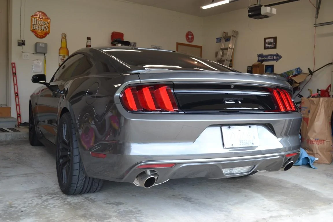

I have a set of the 19x10 PP reps in black from AM with 305/35r19 MT dr's, no spacers, no rubbing or anything and the car is lowered on Eibach Sportlines. I ran those wheels for a little over a year before pulling them off about 2 weeks ago since I bought a drag set up. I ran the 19x10 AM wheels in the rear and the factory PP wheels in front with a 25mm spacer and all the wheels looked pretty good and not inset so far like they were before.
