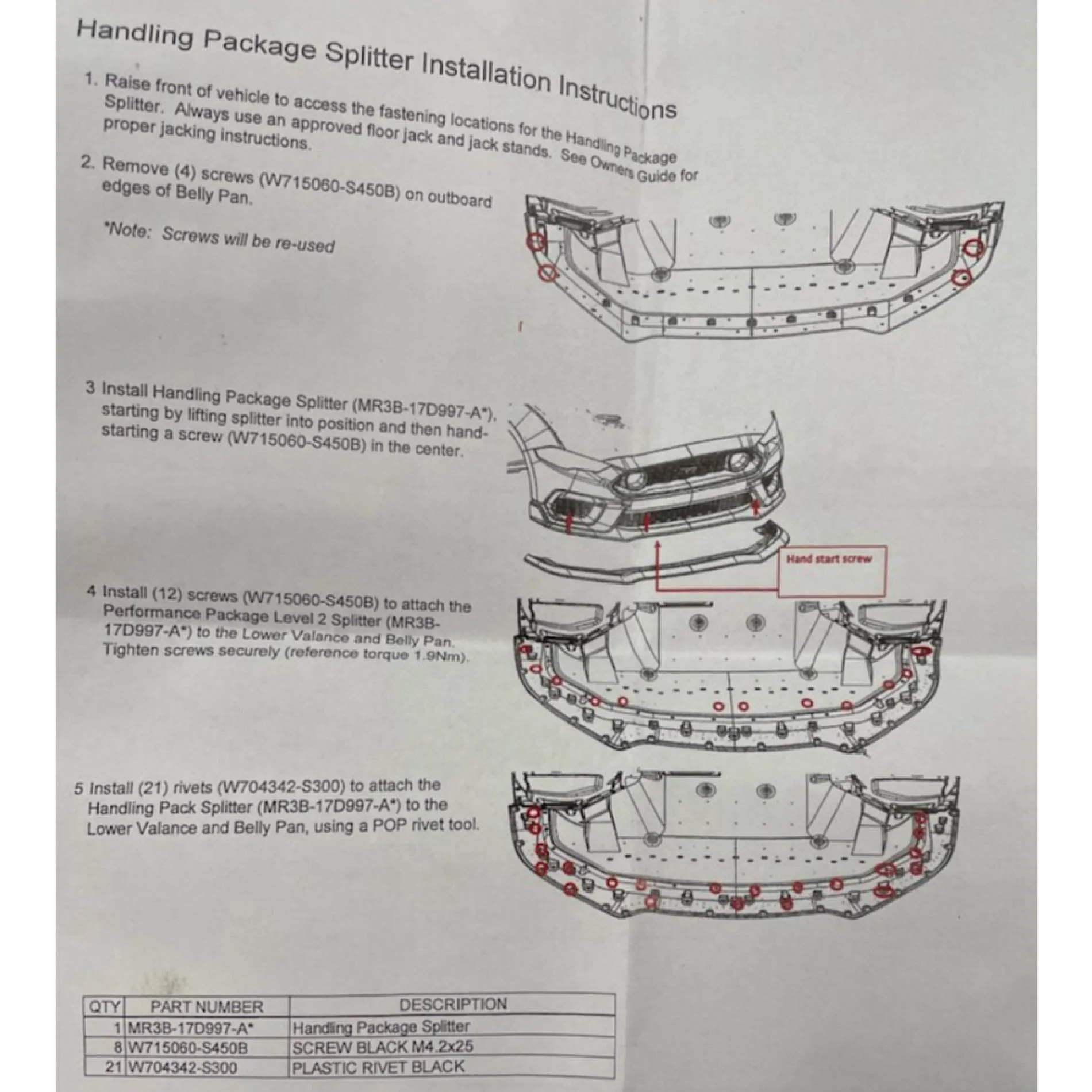

heres the instructions for install

So this add on is easy correct?
The performance pack splitter for a 2016 GT fits only on a performance pack belly pan. You probably have the non-performance pack belly pan.

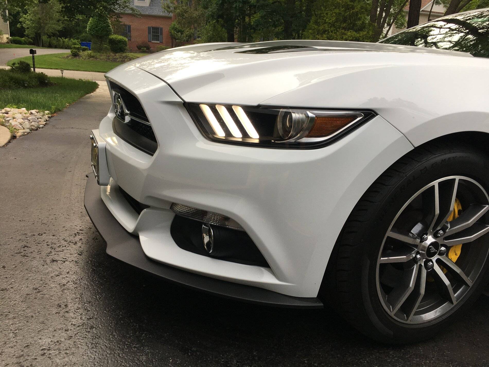

If you want the looks of a performance pack splitter...do what I did and buy a 2016 California Special front splitter from Levittown Ford. This is a direct bolt-on for non-performance pack cars.
Talk to Benny online at Levittown. I have enclosed instructions someone else wrote on the forum along with pictures of my 2015 w/splitter and a few other minor mods that I made.
